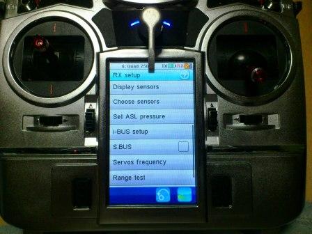

Ryou wrote: I have a TGY-i10 Ver1.0.8. 'S. BUS 'is supported is useful to connect to the helicopter for the gyro.
Are you sure of that ? Don't you mean ibus ?
- Ryou
- Posts: 65
25 Jul 2016 13:08 - 25 Jul 2016 13:19 #52136
by Ryou
Replied by Ryou on topic Flysky AFHDS 2A, protocol as used i10, i6, iT4,
'IBUS' output port can be changed to 'S.BUS' output.
Select the 'RX setup' in the Menu 'S.BUS'.
To 'MIKADO VBAR Gyro' has been used in connection with 'S.BUS'.
Last edit: 25 Jul 2016 13:19 by Ryou.
