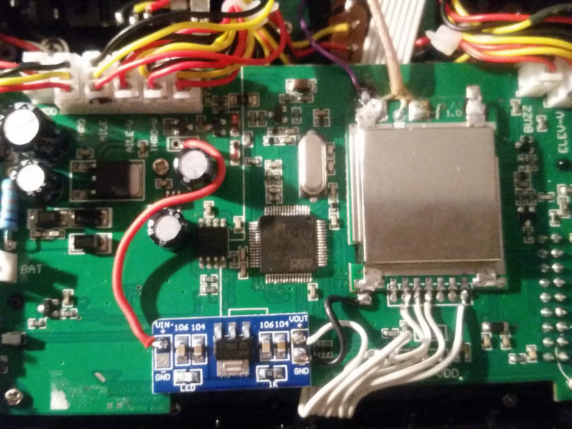

22 Mar 2017 18:11 #60551
by Bisky
Devo F7 XMS + 4in1 module
Replied by Bisky on topic Fayee FY805 captures
@goebish
That was my idea to, could it be a supply problem?

22 Mar 2017 18:13 - 22 Mar 2017 18:21 #60552
by goebish
Replied by goebish on topic Fayee FY805 captures
Can you measure 3.3V while this protocol is in use ?
edit: but yes, if you're only using the stock 7e regulator that's probably a power supply issue, that's a known issue ... take care because your regulator degrades over time.

- Bisky
- Posts: 89
22 Mar 2017 18:29 #60553
by Bisky
I only use stock supply, will ad aditional ams1117.
Thanks.
Thanks.

- Bisky
- Posts: 89
04 Apr 2017 19:29 - 04 Apr 2017 19:34 #61171
by Bisky
Added AMS1117 to power the MM1.3, problems with NRF24L01 remains
ASSAN binds only if u select some other protocol and then Assan and pres bin, if already selected bind dos not work
CG023 does not bind
FY805 does not bind
HISKY binds always model HFW 400(it uses A7105?)
