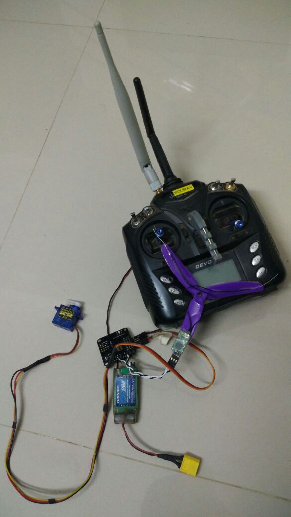

Its all the channels that twitch. I made a small video. I put it HERE . have a look.
Initial thoughts...
1. The twitches seem somewhat rhythmic. could be from the refresh of the protocol code.
2. Maybe the 7e is just not capable to keep up. (very less space)
3. Very small chance. But could be a problem with SBUS + Naze32 + Baseflight!!!
At this moment I don't have another X series receiver from FrSky to test with.
Please do note that, I do understand code but I have never looks very deep into the DeviationTX codebase.

bampi2k wrote: Its all the channels that twitch. I made a small video.
Looks like just the first four channels, not all of them.
Initial thoughts...
Yes, doesn't look random. Best I can tell min 1495, max 1506, which just might be visible in the channel monitor. What do you see there?
No, the CPU runs at the same speed and space is either enough or it won't compile.
What is the number of channels set in the model? If it's not 8, please try it at 8.

08 Mar 2017 13:23 #60000 by bampi2k
Replied by bampi2k on topic New FrSkyX protocol
hexfet wrote: Looks like just the first four channels, not all of them.
Yes, I confirm its just the first 4 channels.
Again an Yes!. I post a video as observed on my radio.
Also, Just to get a better understanding of what is going on here, could you explain what could be going wrong?
I did try 8. I did try 6. and the characteristics did not change.
I understand that I maybe should capture some error log and debug data. Could you guide me to a post where I can learn how to to that on DeviationTX?
