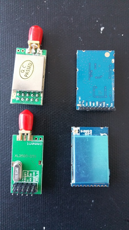

28 Feb 2016 16:02 #43841
Both are listed on the moduleinstall page, and I've used both with the FrSky D8 protocol. The CC2500 fits a multimodule. The XL2500 doesn't.
Replied by mwm on topic New FrSkyX protocol
TomPeer wrote: which of these modules should i use?
cc2500 (blue) or xl2500-D03 (green)

28 Feb 2016 16:25 #43843
by TomPeer
Replied by TomPeer on topic New FrSkyX protocol
I have seen them both on the module install page. but i did not see if one of them would be prefered/better than the other. there is also an issue withe the xl2500-D03. the markings for the pins are different. i have seen an post where someone mentioned that pin 9 and 10 should be reverst.

I have a xl2500-D03 module, I am going to test the new build now and get back to you in a bit. It wasn't a signal swamping issue as the tx/rx were several metres apart on low power.
