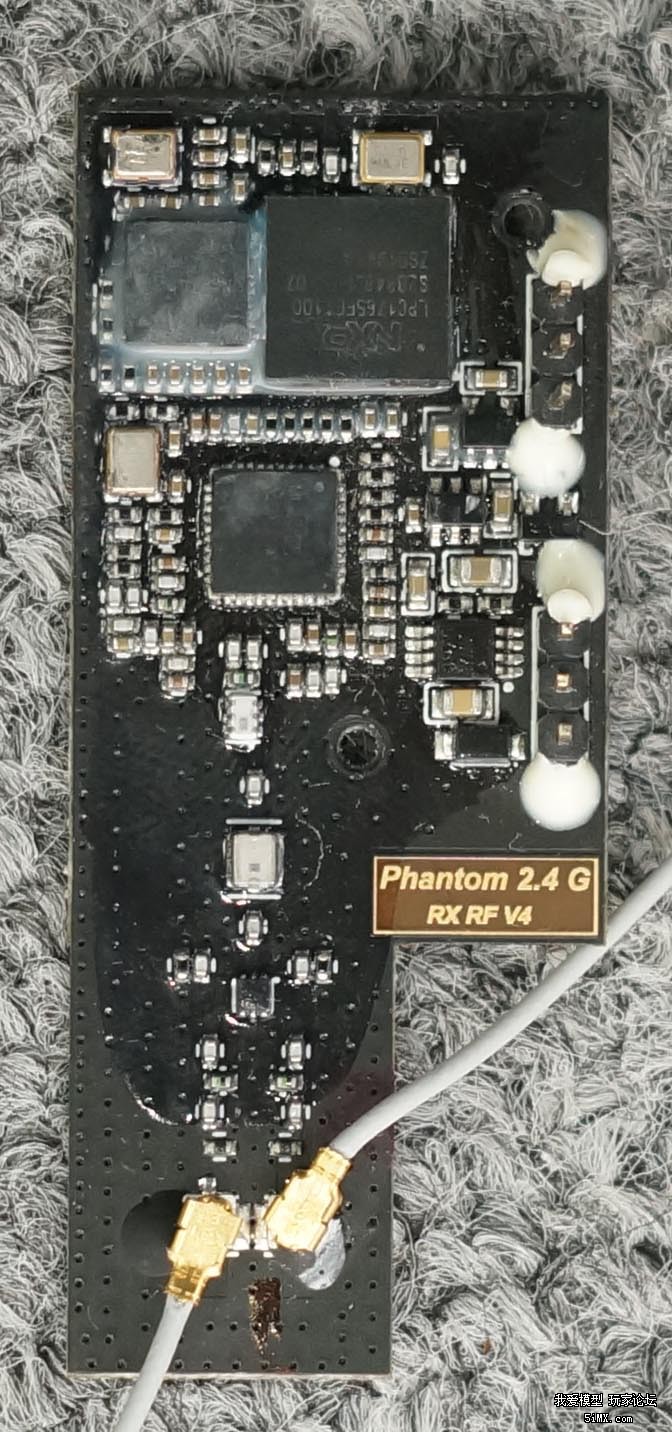

- stylecheng
29 Feb 2016 16:25 #43882
by stylecheng
Replied by stylecheng on topic DJI modulation/protocol
I has removed the tar what is on the chip.
The radio chip is ML2730DM ,the MCU is LPC1735FET100,and it hava a CPLD is 5M240Z,I don't know why it have a CPLD...
Here is some info:http://bbs.5imx.com/forum.php?mod=viewthread&tid=1170033

Highly probable it's Futaba FASST, only they used these chips in their FASST line.

Replied by btoschi on topic DJI modulation/protocol
True, the 2.4G Phantom model with two receiver antennas are using Futaba FASST protocol.
Green (upgraded Phantom 1) or black PCB (Phantom 2) makes no difference.
You can bind using a compatible Futaba remote control (not able to verify that, but its commonly said on DJI boards I read).
