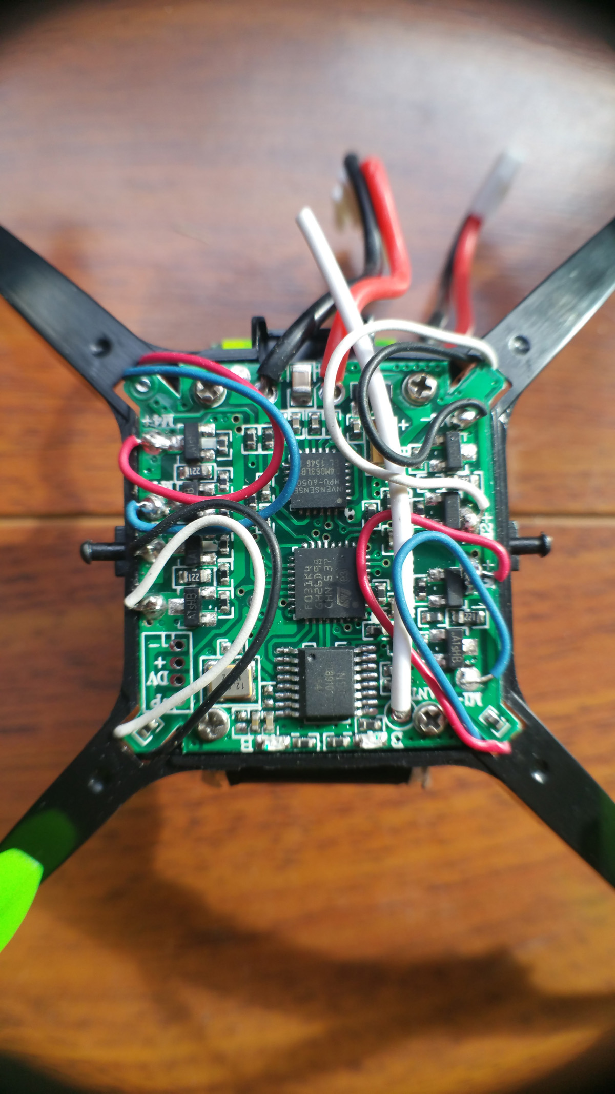

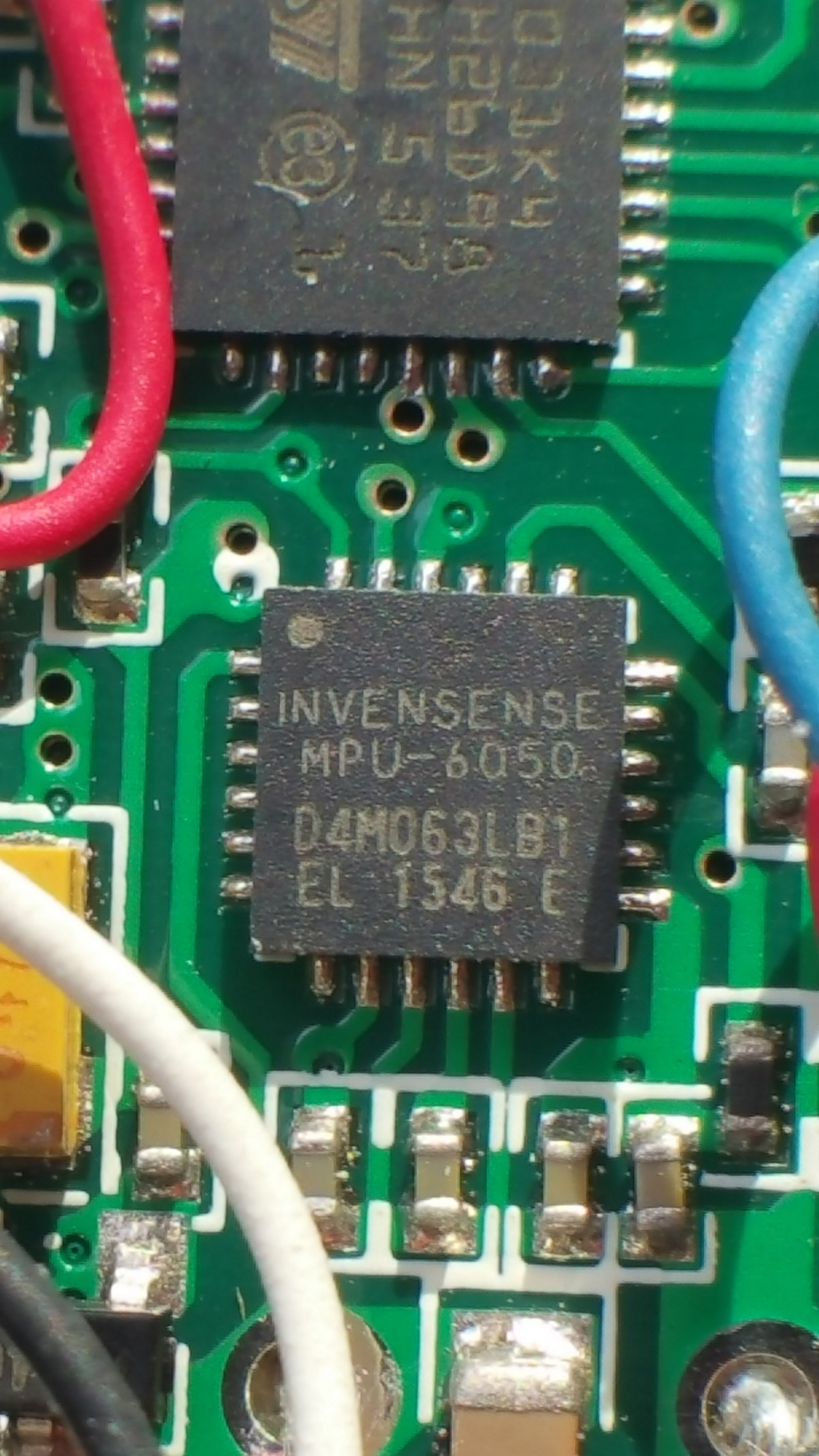

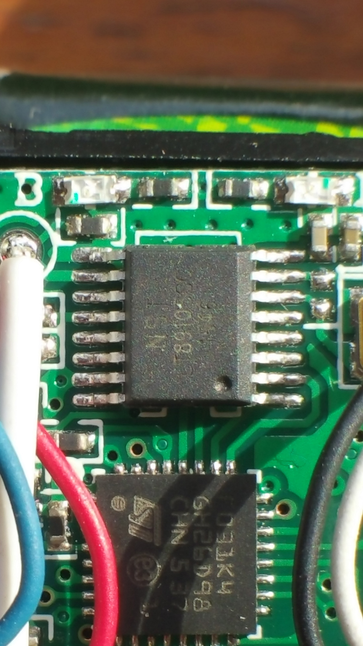

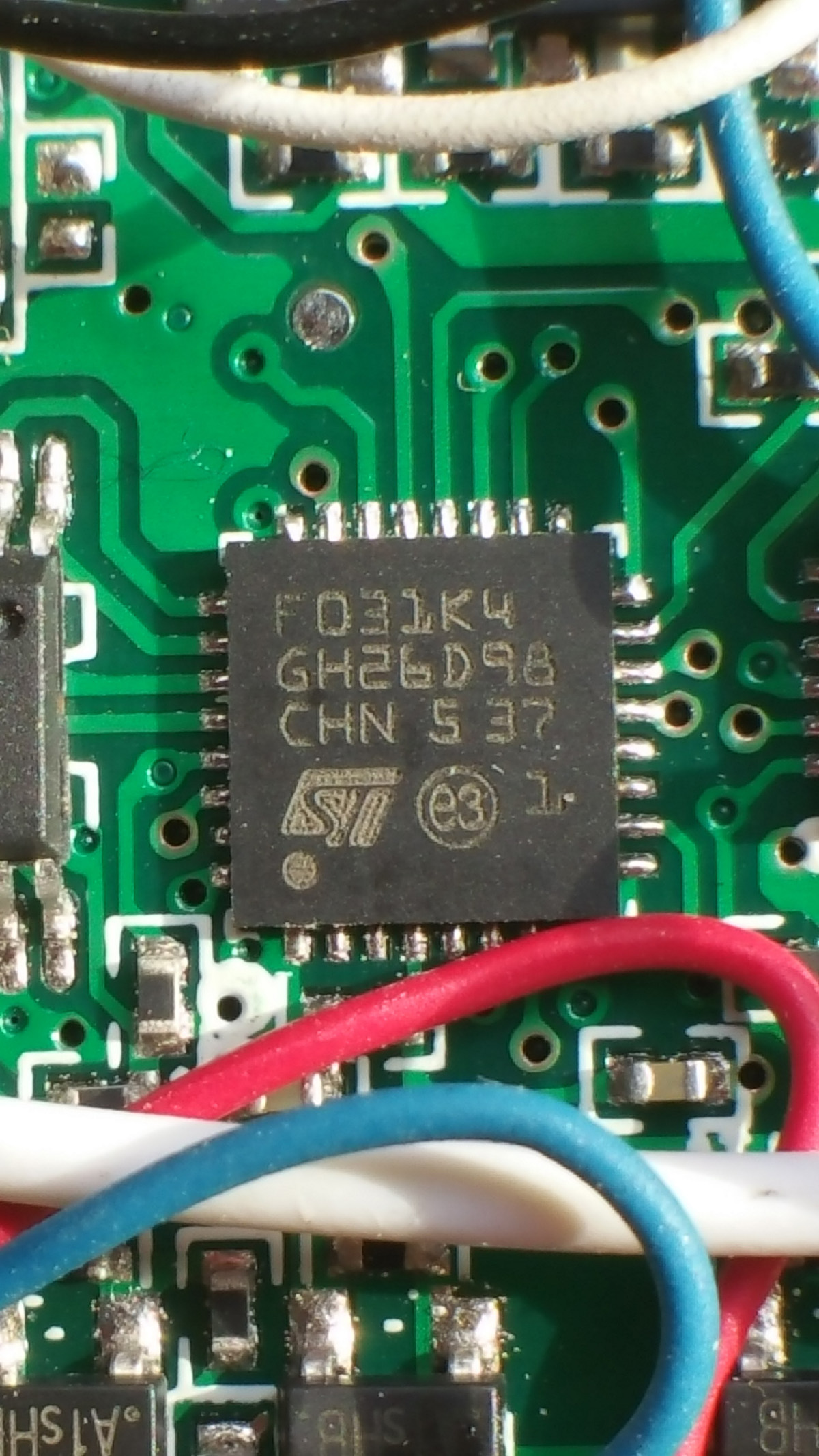

Was hoping that this quad was just a rebranding of the Eachines CG023 and would work with my Devo 7E. After posting pics of the quad's board, Goebish has determined that it is using the LT8910 chip. This is a great little quad and would love nothing more than to be able to fly it with my 7E.

Make a photo of the radio insides as well.

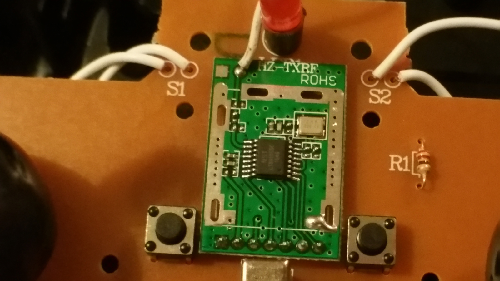

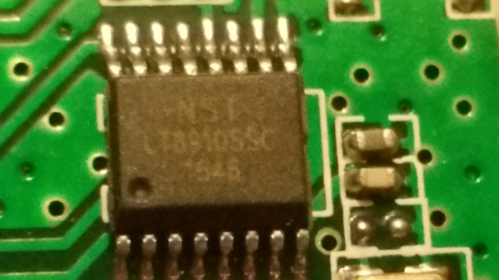

Here are pics of the TX chip. It appears to indeed be an LT8910. Not sure if that's a good thing or a bad thing.
- victzh
- Posts: 1386
08 Mar 2016 15:27 #44269
by victzh
Replied by victzh on topic Dromida Verso Protocol (LT8910)
It is pretty easy to solder to.
