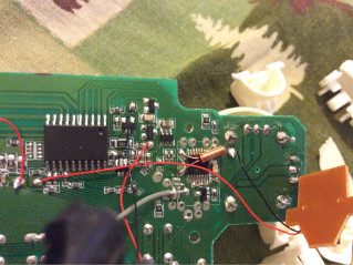

The most interesting part of the board for the purposes of reverse engineering is the radio chip - the one closest to antenna. It is not sufficiently detailed on your photos to tell anything useful. Also, this forum has limitation on the size of the photos, so it's advisable to put them elsewhere and publish links here.

Thanks for the feedback,unfortunately this capture will be delayed do to my botched soldering,lol.Thank God this tx is only 7,78 used @ gearbest waiting for 2 to arrive. Sorry about the space with the photos just opened a media fire acct will upload and linkt there,Thanks again.

At first glance, looking at the size / pin count / very few passives around the RF chip I'd say this is a LT8900/8910, but I could be wrong ...

Is this a good thing?

Not really, well, some work has been done recently by planger to be able to emulate the LT8900 with a nrf24l01 but it's not implemented in deviation yet, and if it is a LT8910 maybe it's using a bitrate that's non compatible with the nrf24l01.
Can you look under the crystal to confirm it's a LT8900/8910 ?

Hey Goebish,I got frustrated after badly butchering the solder job I threw it in the trash.I order 2 from gearbest soon as they appear,I will take that pic.
