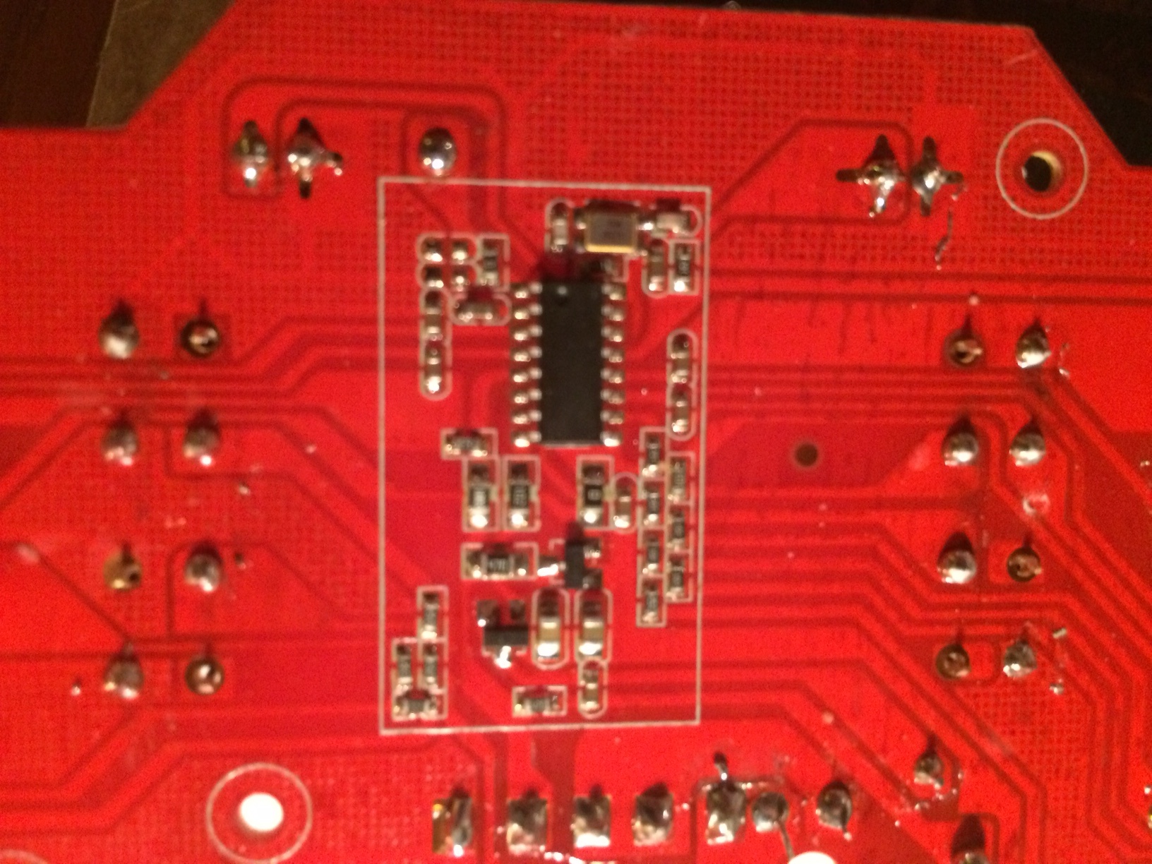

26 Jan 2019 08:47 #72533
by Stormin
Replied by Stormin on topic holystone hs170 predator
i Have photos of the board and the IC. It is a 16 pin set up but has no identifying maker or part number. I can provide the photos staright away but don't have the skills to dump the chip. I can send you the board if you would like to try to decode it.
- goebish
- NRF Weirdo
- Posts: 2633
26 Jan 2019 09:53 - 26 Jan 2019 14:16 #72534
by goebish
Replied by goebish on topic holystone hs170 predator
Please send pictures of the boards (TX & Quad), even if there's no marking on ICs.

- Stormin
- Posts: 5
26 Jan 2019 17:40 #72547
by Stormin
- Stormin
- Posts: 5
- Fernandez
- Posts: 983
26 Jan 2019 18:42 #72552
by Fernandez
Replied by Fernandez on topic holystone hs170 predator
to me it seems you need to focus your camera and can read the chips
- Stormin
- Posts: 5
26 Jan 2019 19:19 #72554
by Stormin
I get that the photo could be better but I assure you, the chips have been etched or bleached. I've tried different lighting and no go. I will try a uv at work Monday. I have a good magnifier and in white light its just an illegible shadow. I'll get some clearer pics with a better photo rig and re up, but it wont help with the chip label.
- goebish
- NRF Weirdo
- Posts: 2633
27 Jan 2019 01:48 - 27 Jan 2019 02:19 #72569
by goebish
I'm not 100% sure but looks like Panchip ICs (xn297l compatible).
Can you read PAN159CY on the bigger IC in the quad ?
Anyway, there's no SPI bus, if someone can send one to a dev maybe it can be deviated.

- Stormin
- Posts: 5
27 Jan 2019 07:58 #72571
by Stormin
Trust me...you can't read the chip labels...
I think it would be a blessing to all the folks that like this drone to have an open tx option; and I'm not at all pleased with the fact that the maker has gone to some lengths to disguise the chips.
Taken together, these points make this easy...shoot me an address and I'll drop ship the boxed drone to the dev team.
- goebish
- NRF Weirdo
- Posts: 2633
27 Jan 2019 10:37 #72573
by goebish
I'll send you my address in PM, I believe this is XN297L compatible, but I can't be sure if the marking is unreadable, so there's no guaranty I will succeed.
- solderflux
- Posts: 4
12 Feb 2019 15:47 - 23 Feb 2019 01:09 #72873
by solderflux
Replied by solderflux on topic holystone hs170 predator
Last edit: 23 Feb 2019 01:09 by solderflux.
- goebish
- NRF Weirdo
- Posts: 2633
12 Feb 2019 15:56 #72874
by goebish
That's a tlsr8368 MCU with builtin RF transceiver, I've never seen one before, no idea if it can be emulated with one of our 4 supported transceiver until someone dumps the signal with a SDR device.
I can take a look if someone sends one to me, but without any guaranty I can make it work with Deviation.
