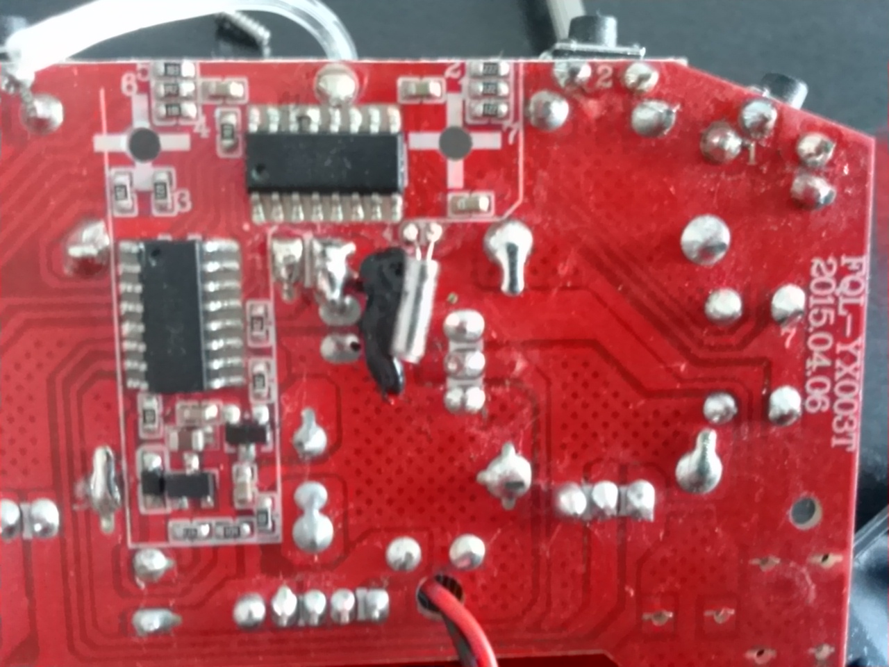

Hi, I have been flying these for a while now and even with the stock tx its one of the best nanos I have tried. I really feel this could be the best nano if deviated, fingers crossed... I am leaving a link for the cheapest place it could be had(14$) www.gearbest.com/rc-quadcopters/pp_265982.html

ogrope1 wrote: Hi, I have been flying these for a while now and even with the stock tx its one of the best nanos I have tried. I really feel this could be the best nano if deviated, fingers crossed... I am leaving a link for the cheapest place it could be had(14$) www.gearbest.com/rc-quadcopters/pp_265982.html
Sound like a XN297 RF chip ...

Thanks seb, so in theory it is compatible, correct?

What do you mean by theory? That it's not a totally alien radio chip? Probably (I can't read what't written on it on this photo). It can be LT8900 or LT8910. They are known but less developed.

Very few passives around the RF chip + antenna connected directly to it = 95% chance this is a LT8900 / LT8910.

This sounds like good news if I understand correctly. I am willing to pay for an unit if someone is interested in trying to get it working, I really feel its worth it.

Not really, only the LT8900 can be emulated right now (and only if it's not using whitening).
Quite a bit of work is still required for LT8910 if it's using one of the lower bitrates (will require a CC2500 module in the Devo).

It could be a HS6200P as well, I started working on emulating it ( here ) but I need to order a machine that's using it to complete the work.
