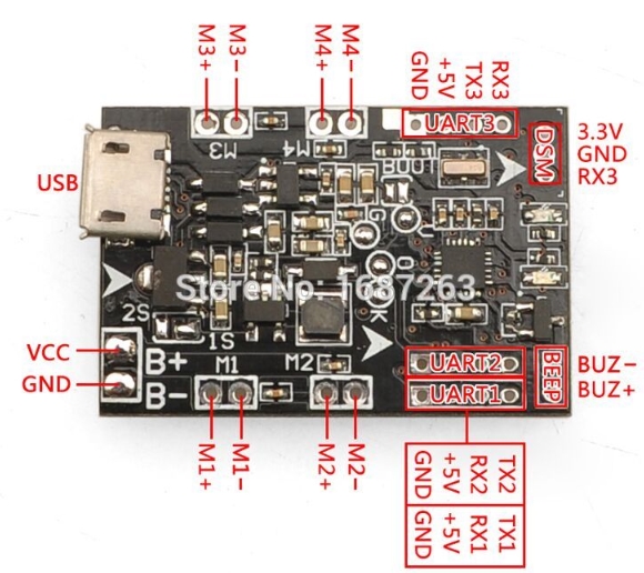

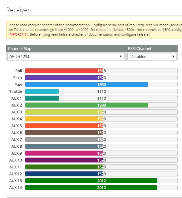

Can not set the end point from 1000 to 2000 in a DEVO7E + S-FHSS + F3 EVO Brush Flight Control Board + Cleanflight (CF).
Fixed in 1110-1930.
Not reflected be set to MAX-250 ~ + 250.
Fixed in 1110-1930.

Again from 1110 to 1930 it does not change.
It is always 1110 to 1930.
Setting of Cleanflght (CF) is 1,000 to 2,000.

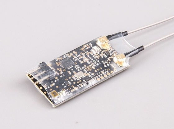

I'm sure in OrangeRx SF700S receiver.
It compares the FUTABA T8J transmitter in the same receiver.
PWM width has been observed by the digital oscilloscope.
Replied by Ryou on topic DEVO7E+S-FHSS ENDPOINT
victzh wrote: @Ryou, @micro heli club, what receivers do you use?
