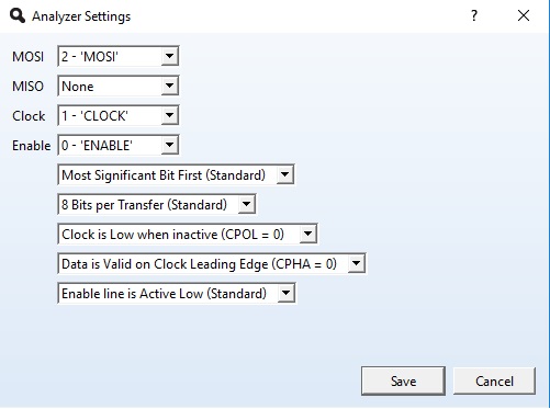

my apologies again. i have re-capture with the correct spi settings now,

Unfortunately this capture does not have any packet markers, which usually indicates an issue with the Enable signal. Also please set the SPI format to Hex before exporting. If you'd like to just upload the logicdata file I can try to spot the issue.

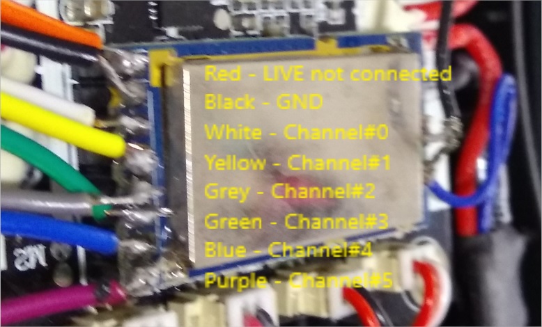

Blade81, would you please post information on your receiver connections showing which signal is on which pin. Thanks.

- Blade81
- Posts: 58
24 Apr 2018 20:58 #68838
Replied by hexfet on topic Mjx Bugs 3
Thanks, that gave me a head start. The bugs3 receiver arrived early and I've made some captures. There's good news and bad news.
The good news is that the hopping frequencies seem to be completely determined by the txid. Using the txid from Blade81's capture to bind, the receiver listens on the same hopping frequencies as Blade81's. Don't necessarily need to decode the algorithm, we could just always use these frequencies with any receiver.
The bad news is that the radio id used by this receiver is different from Blade81's, which means it's identified by the "rxid" bytes in the rx bind packet. To bind to any receiver we have to decode the algorithm for rxid -> radio id, or capture every single possibility. I think I could build a test rig to do that but I'd need a transmitter and BG says they're restocking.
For anyone that makes a capture I can add your receiver to the protocol and you'll be able to fly. But without the rxid to radio id algorithm or a full dataset we won't have a protocol we can add to the nightly build.
