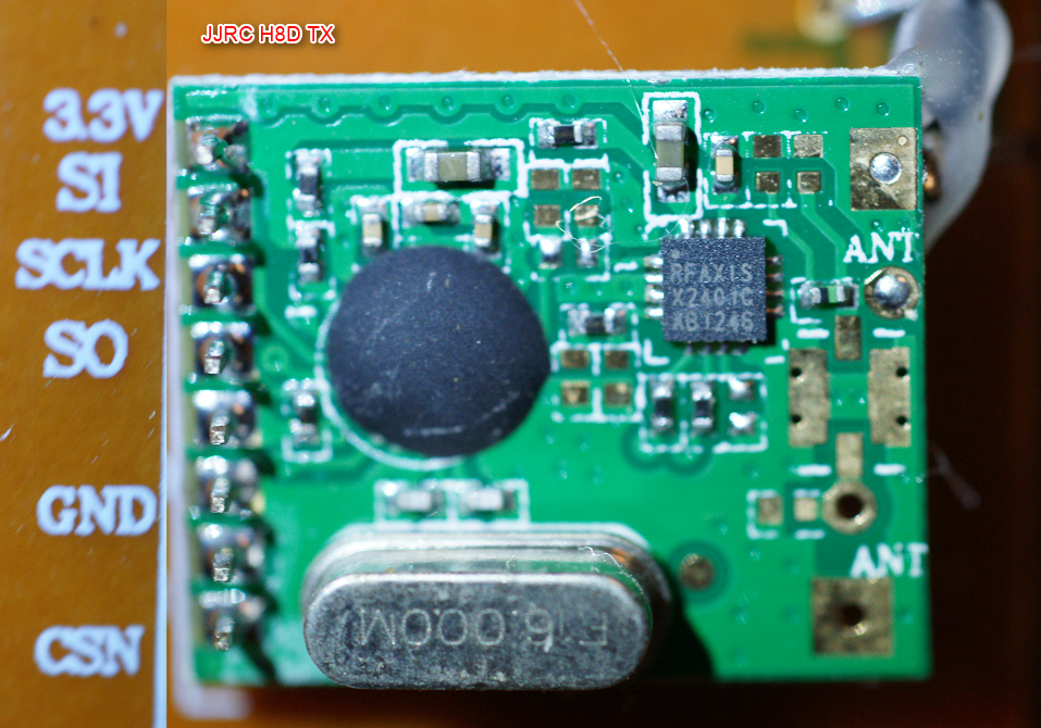

How to wire the chip tx to capture the flip and return to home ?

Connect SI, SO, SCLK, CSN and of course GND.
