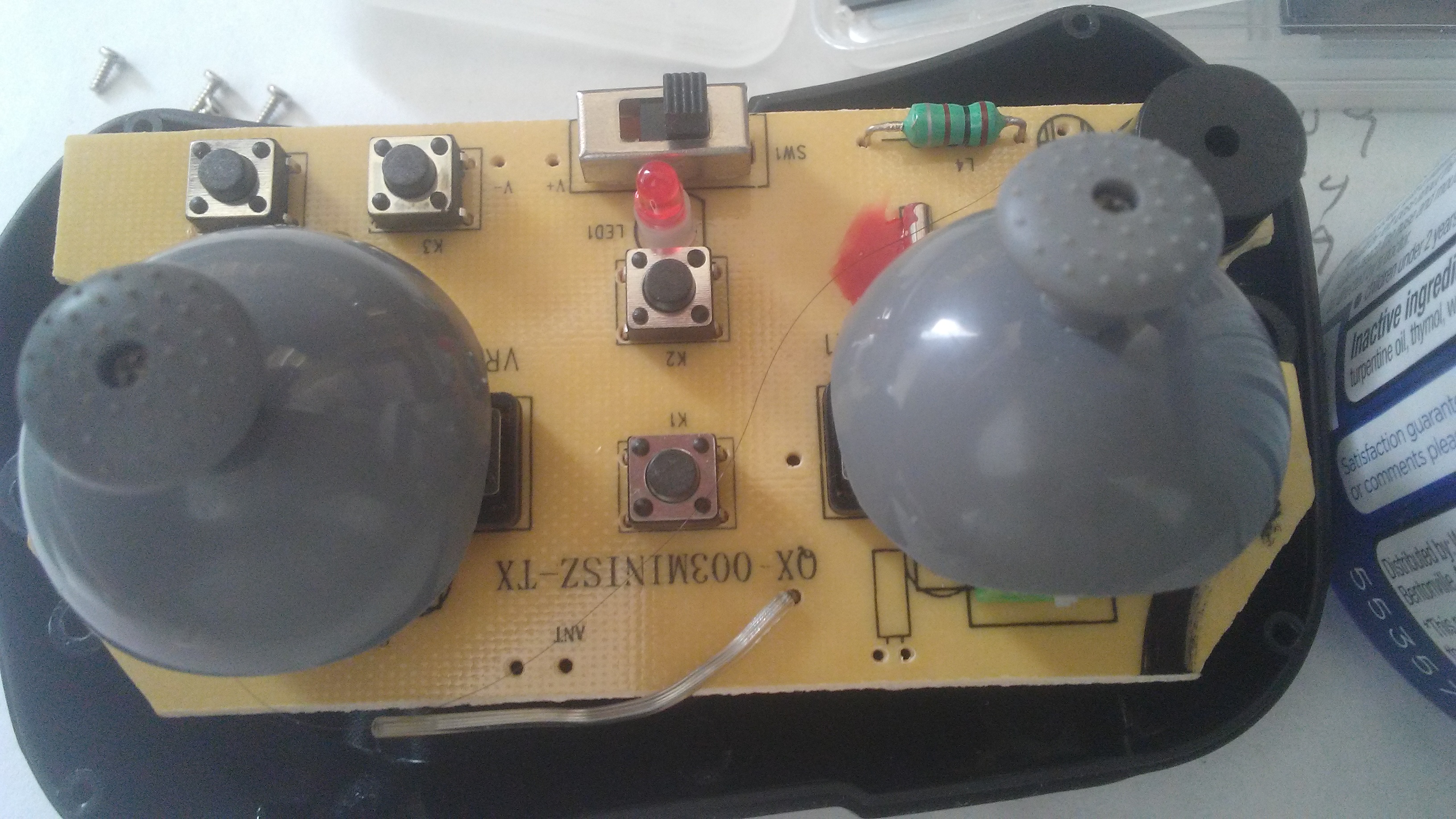

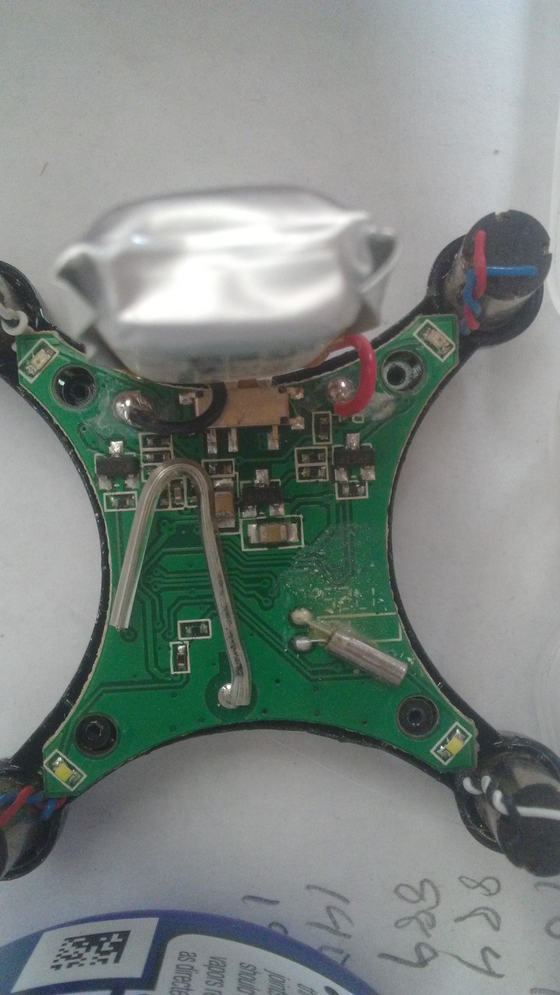

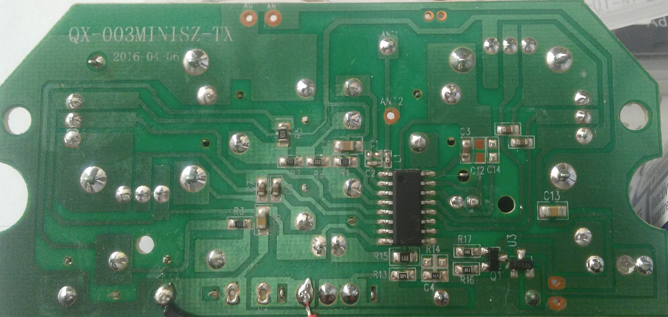

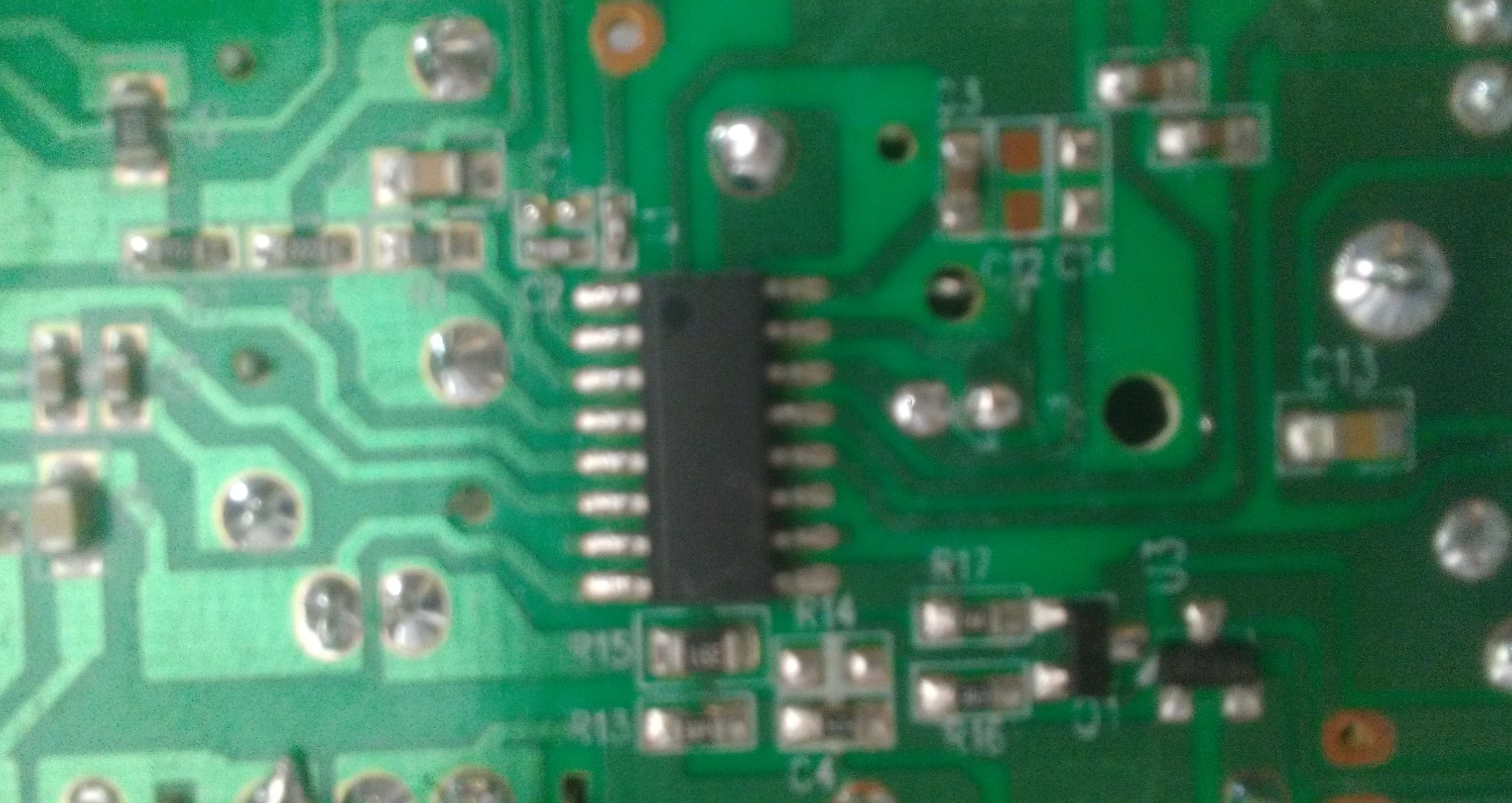

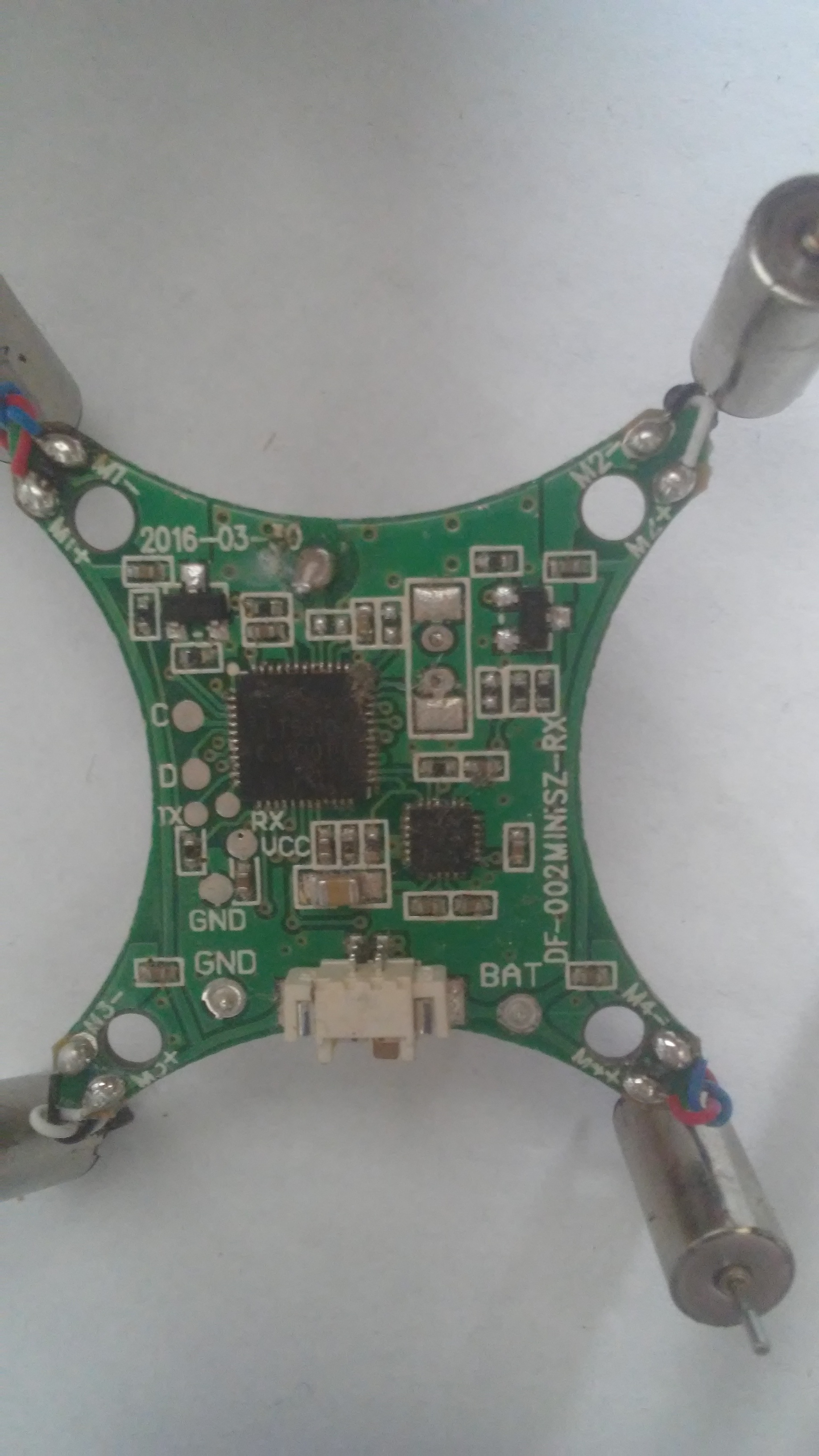

Can you identify the RF transceiver in the transmitter or quad ?

09 Dec 2017 20:37 - 09 Dec 2017 20:42 #66421
by campbell
Replied by campbell on topic PROPEL Micro X01 atom
Last edit: 09 Dec 2017 20:42 by campbell.
- goebish
- NRF Weirdo
- Posts: 2633
09 Dec 2017 20:41 - 09 Dec 2017 23:31 #66422
by goebish
Replied by goebish on topic PROPEL Micro X01 atom
Ok, the transceiver is built into the MCU, SDR is required for protocol analysis and we can't be sure it can be emulated with one of our 4 transceivers ...
I can't do anything, sorry
edit: there is a LT5910 in the quad (MCU+LT8910 RF), not supported by deviation so far.
