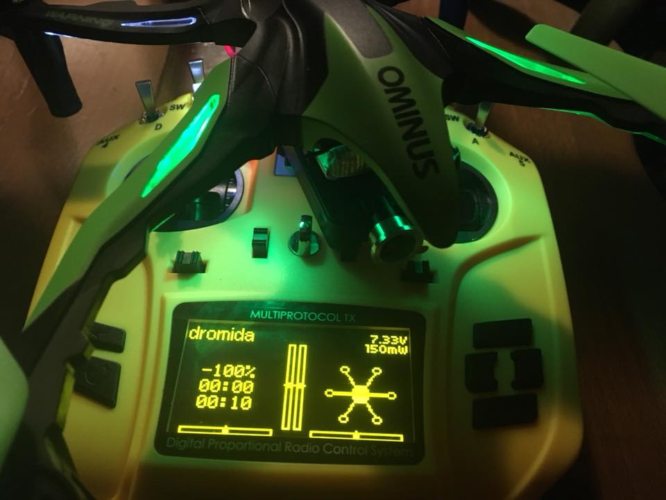

- JayDrone
- Posts: 85
07 Nov 2018 04:30 #71594
by JayDrone
Replied by JayDrone on topic SLT sub protocols V1, V2, Q100, Q200 and MR100
help me out here I have the sub protocols v1 v2 n q200 - i have the fpv omnimus V1 steady flashing light v2 seems to kinda bind but solid red light and i cant make motors fire -- q200 wont bind and red light just flashes - if i bind to v2 and light is steady then i can move to q200 and the led stays solid - still no motor fire acion any help would be great
- JayDrone
- Posts: 85
07 Nov 2018 04:42 #71595
by JayDrone
and so u all know the dfu file took out my bugs 3 min and the new eachine protocols
- goebish
- NRF Weirdo
- Posts: 2633
07 Nov 2018 11:05 - 07 Nov 2018 11:47 #71605
by goebish
That's normal, this test build was based off older sources, I just updated it (with extra SLT sub protocols):
www.dropbox.com/sh/ba8eas16qwlt3nh/AADUN...SHJk6CvIYyzZf-a?dl=0
Channel mapping:
Channel 9: Flight Mode
Channel 10: Flip
Channel 11: Video On
Channel 12: Video Off (Q200), Picture Snapshot (Q100 / MR100)
Channel 13: Calibrate (Q100 / Q200)
Try this updated version through I don't think that will change anything, that's weird that you're having those issues as @etoyoc told it was working fine on its end.
@etoyoc can you check out the updated version as well please ?
Replied by goebish on topic SLT sub protocols V1, V2, Q100, Q200 and MR100
JayDrone wrote: and so u all know the dfu file took out my bugs 3 min and the new eachine protocols
Channel mapping:
Channel 10: Flip
Last edit: 07 Nov 2018 11:47 by goebish.
- JayDrone
- Posts: 85
08 Nov 2018 04:36 #71641
by JayDrone
bam u r the man all worked out well
