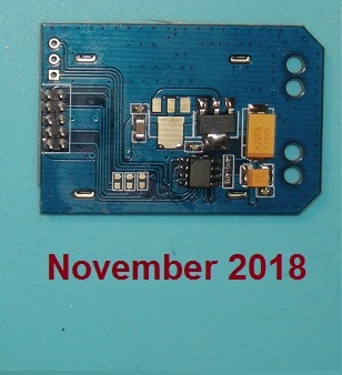

I can not understand. It should be the same but success or failure.
If I keep making mistakes, I wonder if I can not bind at all even if I set the same transmitters until then.
The transmitter I own is equipped with almost all 4in1 modules.
Devo6, Devo7e and Devo10 are Retail version 4in1 modules purchased at the same time.
The IR8M is an initial version, but the 4in1 module has been replaced with the Retail version.
There are two T8 SGV2 + s. It is what I purchased recently with 1st lot.
As for the value of Freq-Fine, since the value set for the first successful Devo 6 was -127, it is set and tested on other transmitters as a successful example.
The ID succeeded only 123456.
It fails or succeeds due to transmission output. Even if the output is small, it is useless, too large, it seems like useless, is there a sweet spot? I do not understand.
