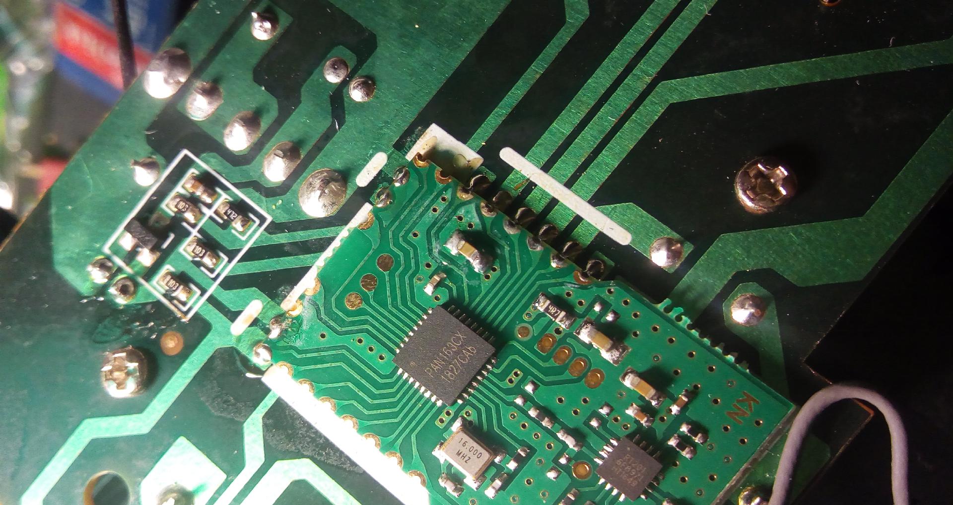

This plane has a servo on elev and motors on both sides of wings. The stock TX has 3 channels on sticks + 2 buttons on top (1 unknown, 1 for rate).
It has a control board marked KN inside the TX.
Is it possibble to get it deviation'ed?
Thanks.

Looks like it's using a PANxxxx MCU with built-in XN297L transceiver, it should be possible to deviate it, but only with SDR, not with a logic analyzer ...

Uploaded deviation-devo10-v5.0.0-9d0c370.dfu (built from git) onto my devo10. Unfortunately could not bind with XK A110 using GD00X protocol. Plane did not respond.
BTW, shouldn't the smaller chip be an RF chip since the antenna is attached there?

No, that's a PA/LNA.

by wasp09
Replied by wasp09 on topic XK A110 3 channel plane
Good to know that it is a PA. That helps to keep the plane in flight.

KN protocols are using a nrf24l01, but the PAN163CX MCU in this TX has a XN297L transceiver, therefore that's a different protocol.

@Wasp09 I see on the internal pictures that compared to the V911S remote control the XK A1x0 has a seperated board with the SPI bus exposed. Might be worse dumping it to see if there is a small variation with V911S that I've only amalyzed via SDR...

SPI bus is not exposed, that's a PAN163CX + PA/LNA
