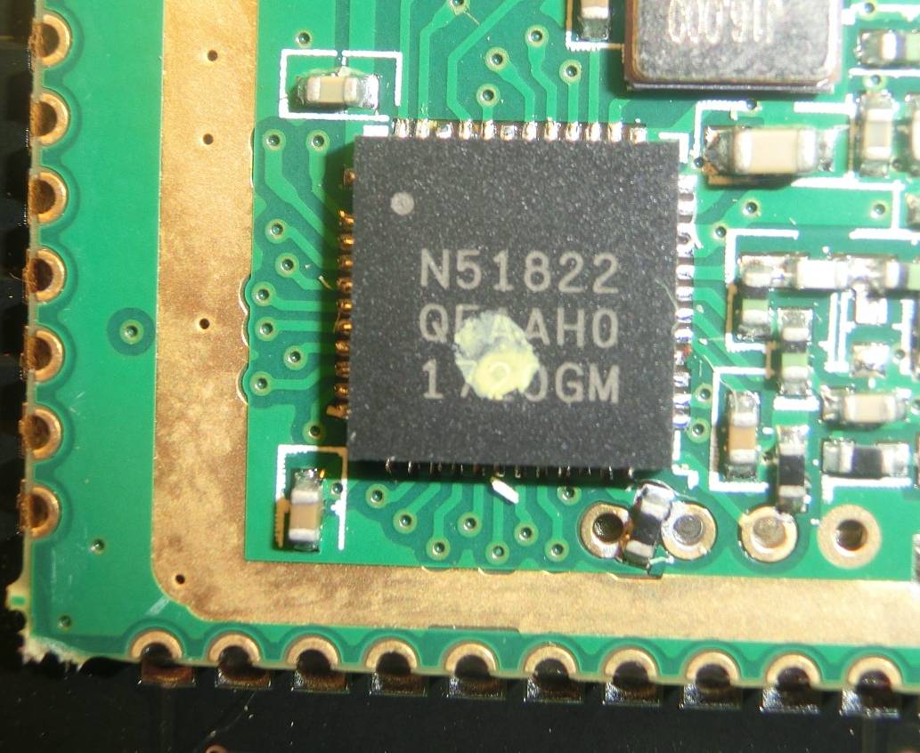

Hi !
Looked inside the wrong tx erratically.
The Esky150X chip (also bLADE70S) is a N51822
Therefore concerning both Jumper and Devo/Deviation radios : No chance I'm afraid.
No, I'm sorry . . .Gerhard_H wrote: Hi!
The Esky150 protocol is part of the CYRF6936 Chip, which is part of the stock Esky150 radio (BLADE70S radio also).

Here it is . . .goebish wrote: I've never seen the N51822 yet . . .
Can't believe that for the Esky (HH) transmitter uses a chip N51822, which is not covered by DeviationTX.goebish wrote: . . . Regarding the E150X I suppose they changed the protocol along the way because some users on the forums previously reported that it worked with the Esky150 protocol.
I'll update the documentation for those models.
