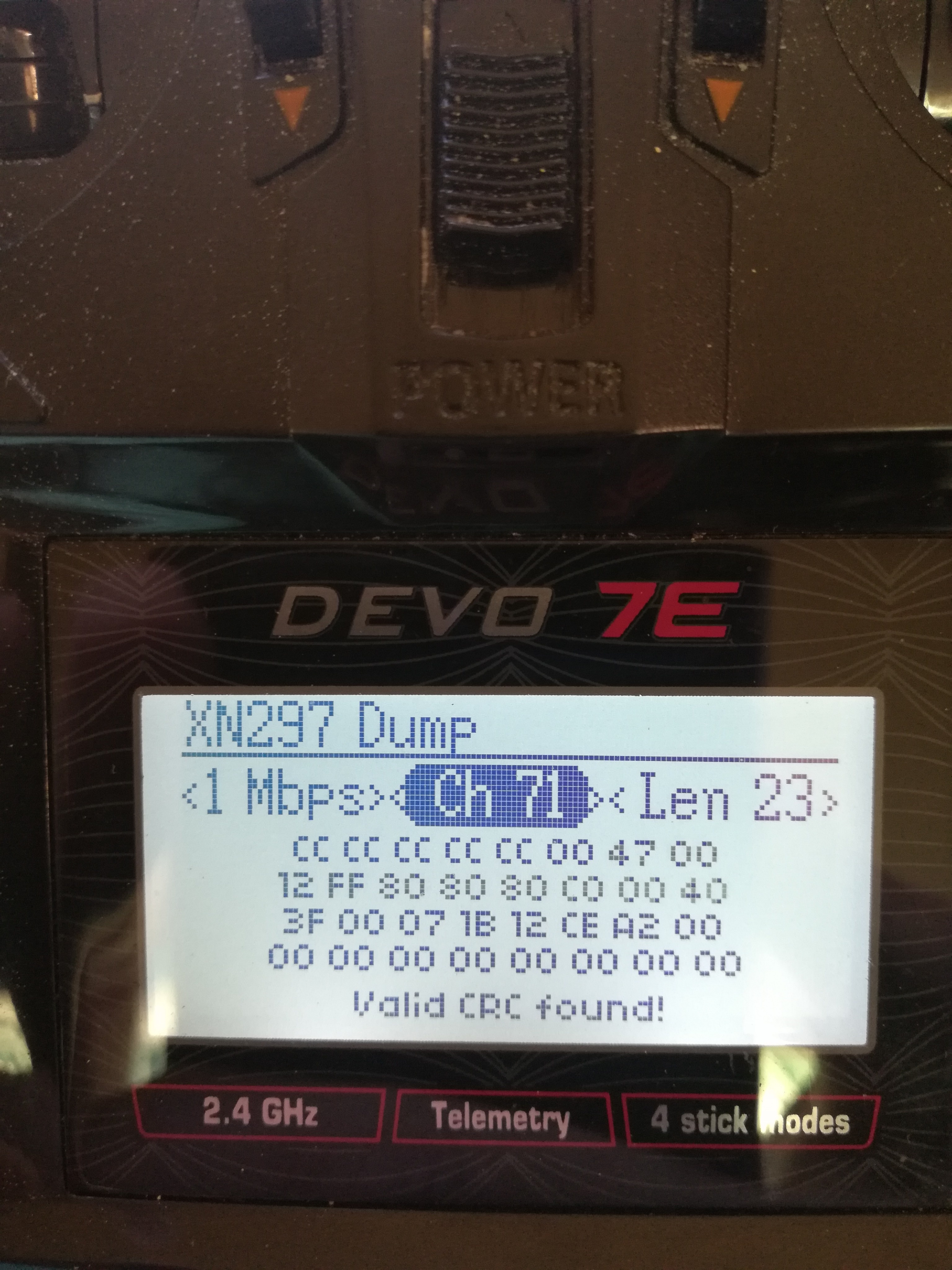

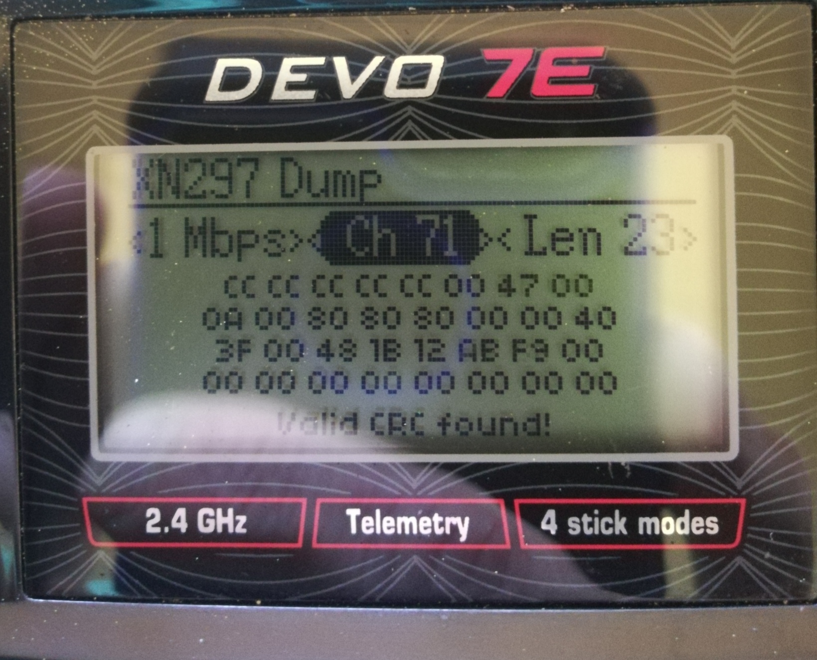

There's something weird tho, can you tell when does the byte to the left of FF in the full throttle capture switch from 0A to 0E ?
(first number of the 2nd line) or maybe that's just a glitch of the picture due to slow lcd refresh rate.

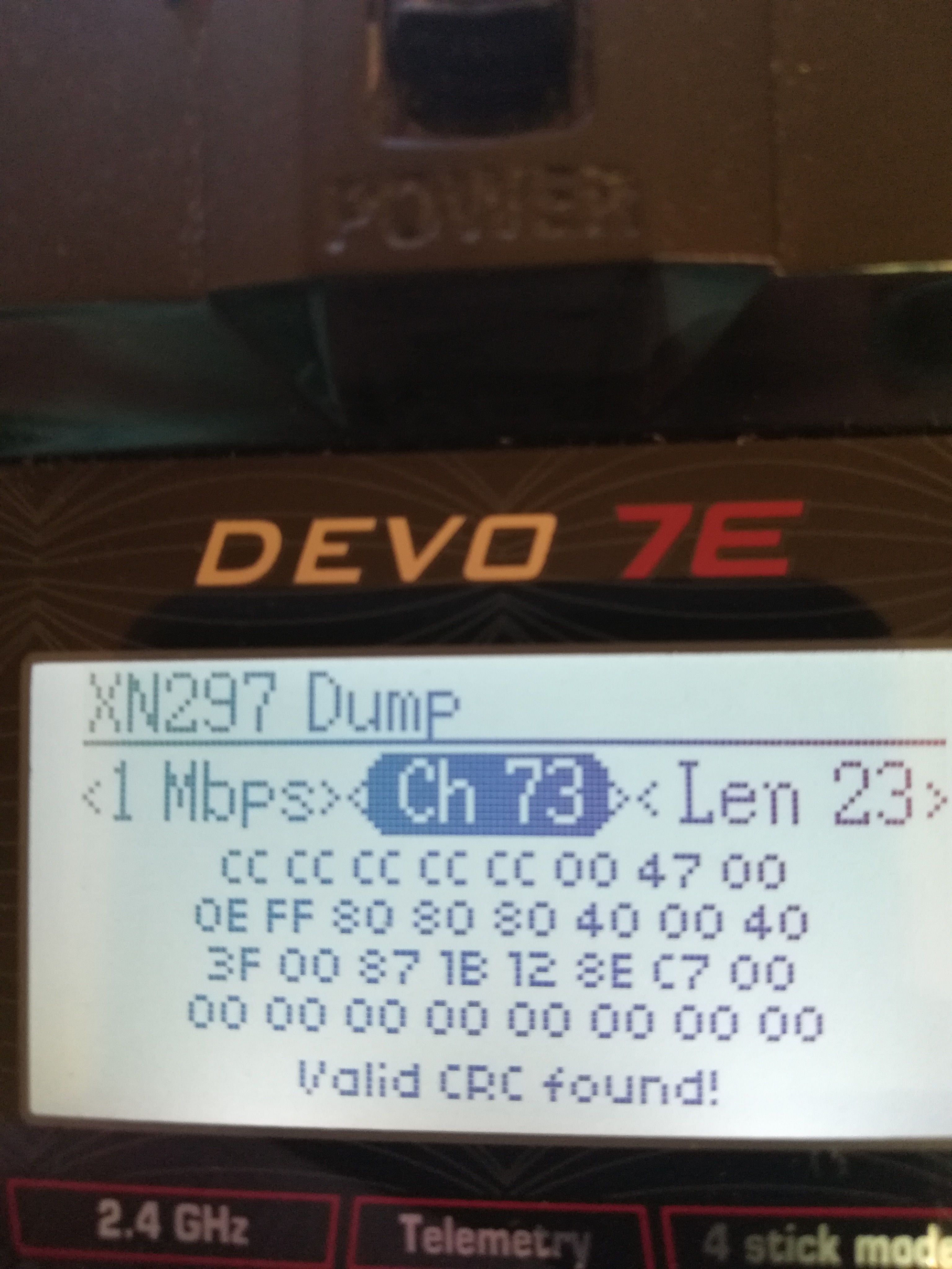

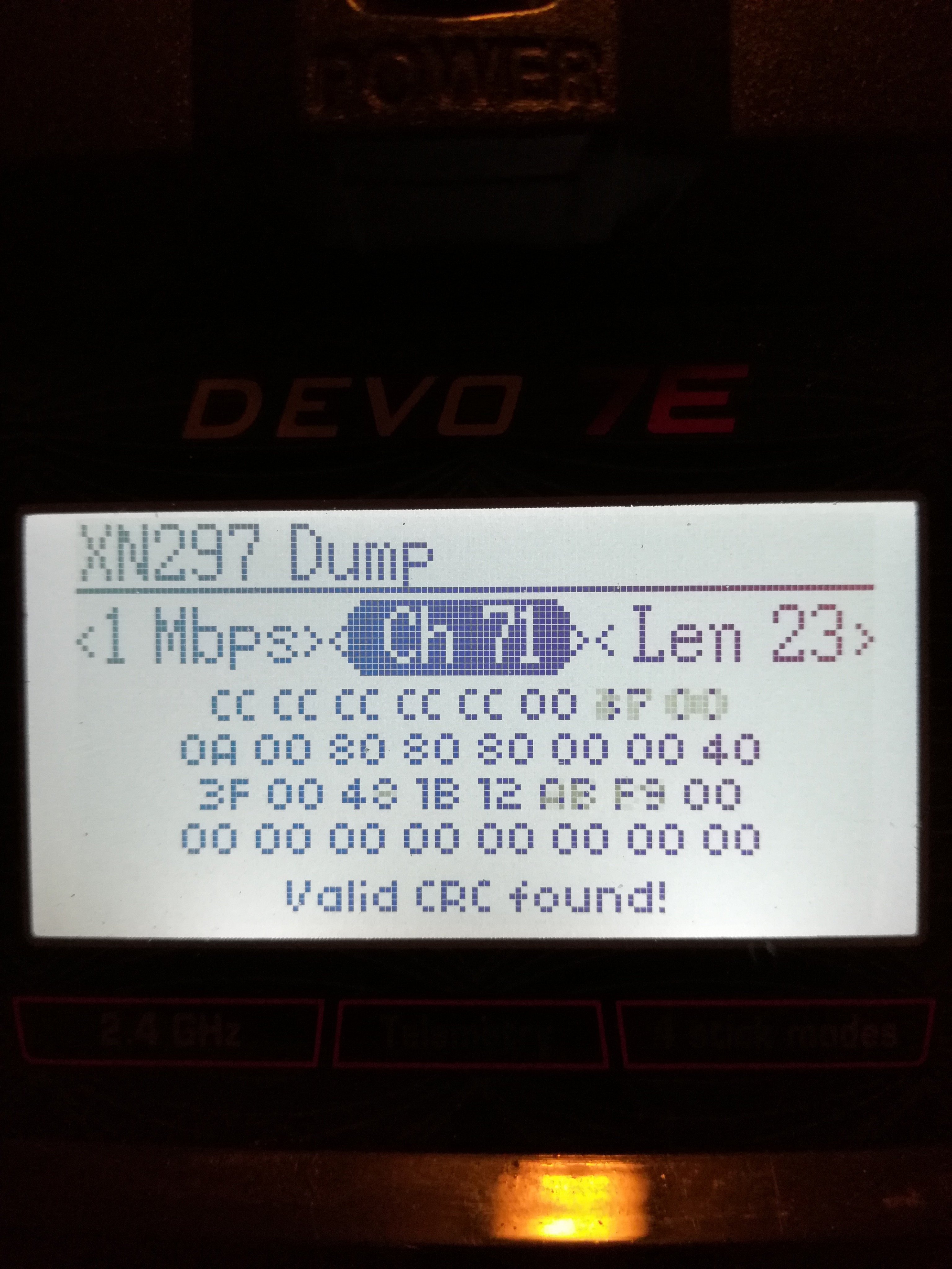

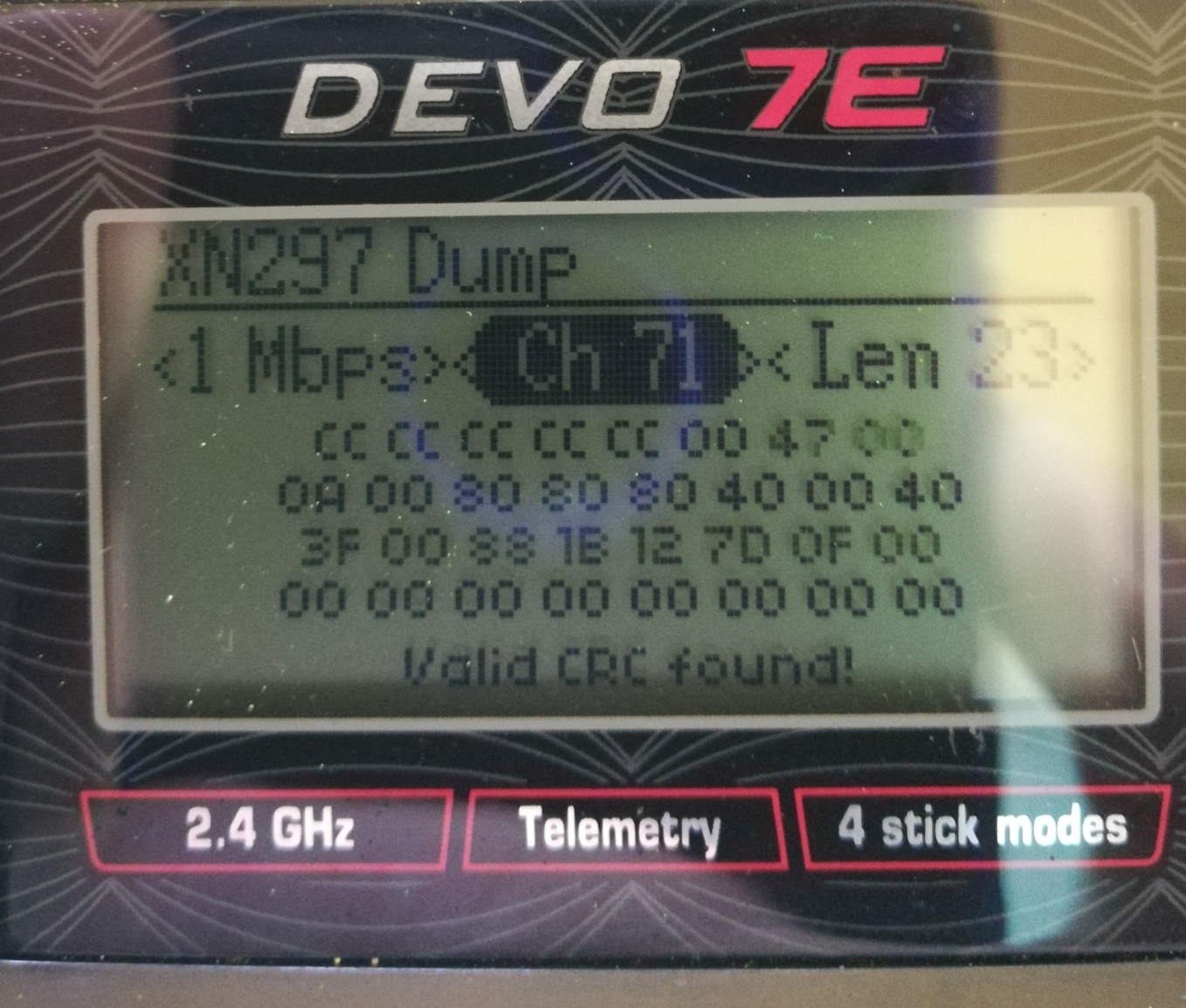

I think your last 3 captures are wrong (no extra flags), you probably need to apply some throttle to enable those features.

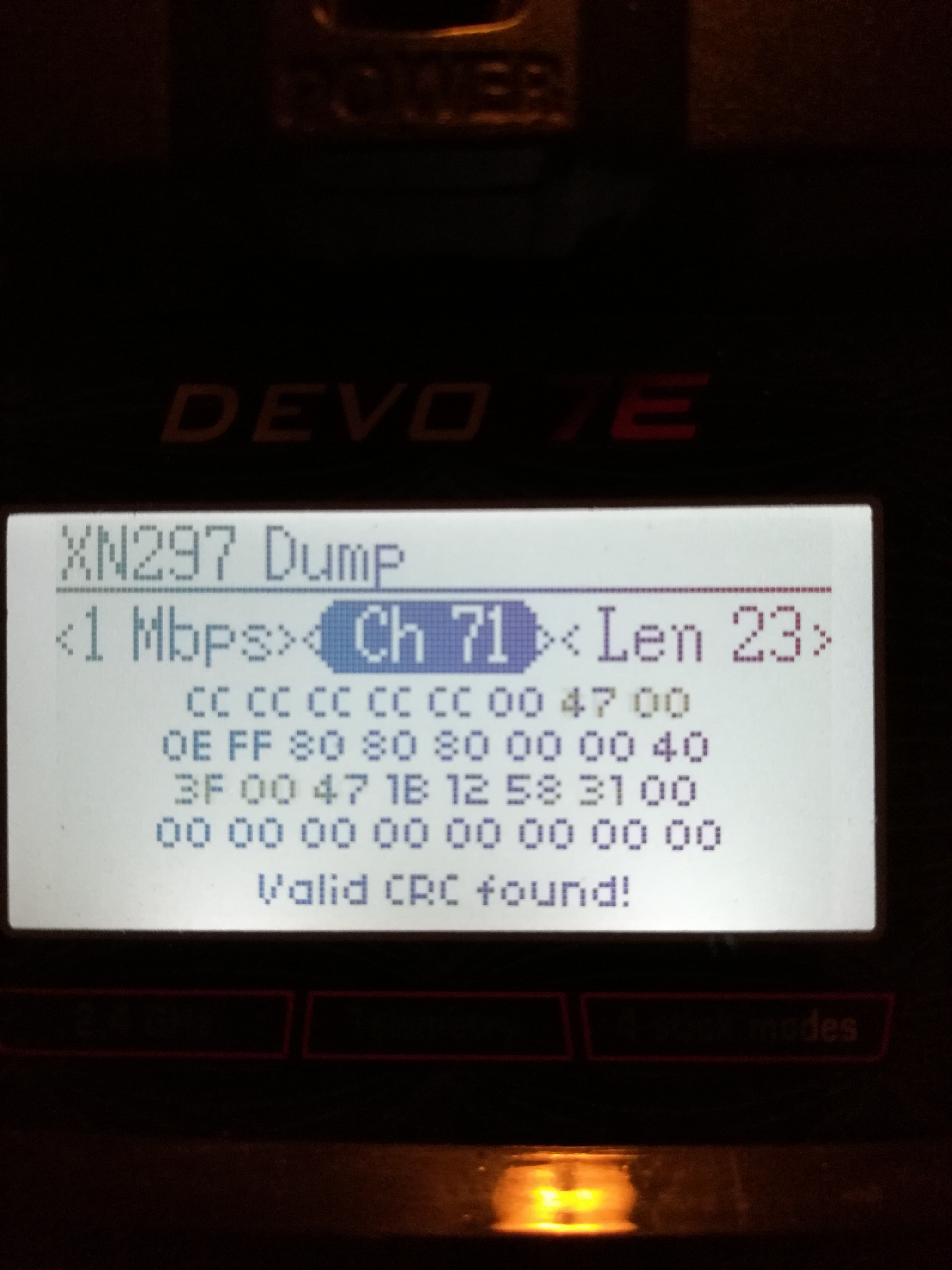

Ok good, seems the 0A -> 0E transition that I didn't understand is flip mode.
Try the test build, if it works I'll update it

And yes it changes OE at full throttle.

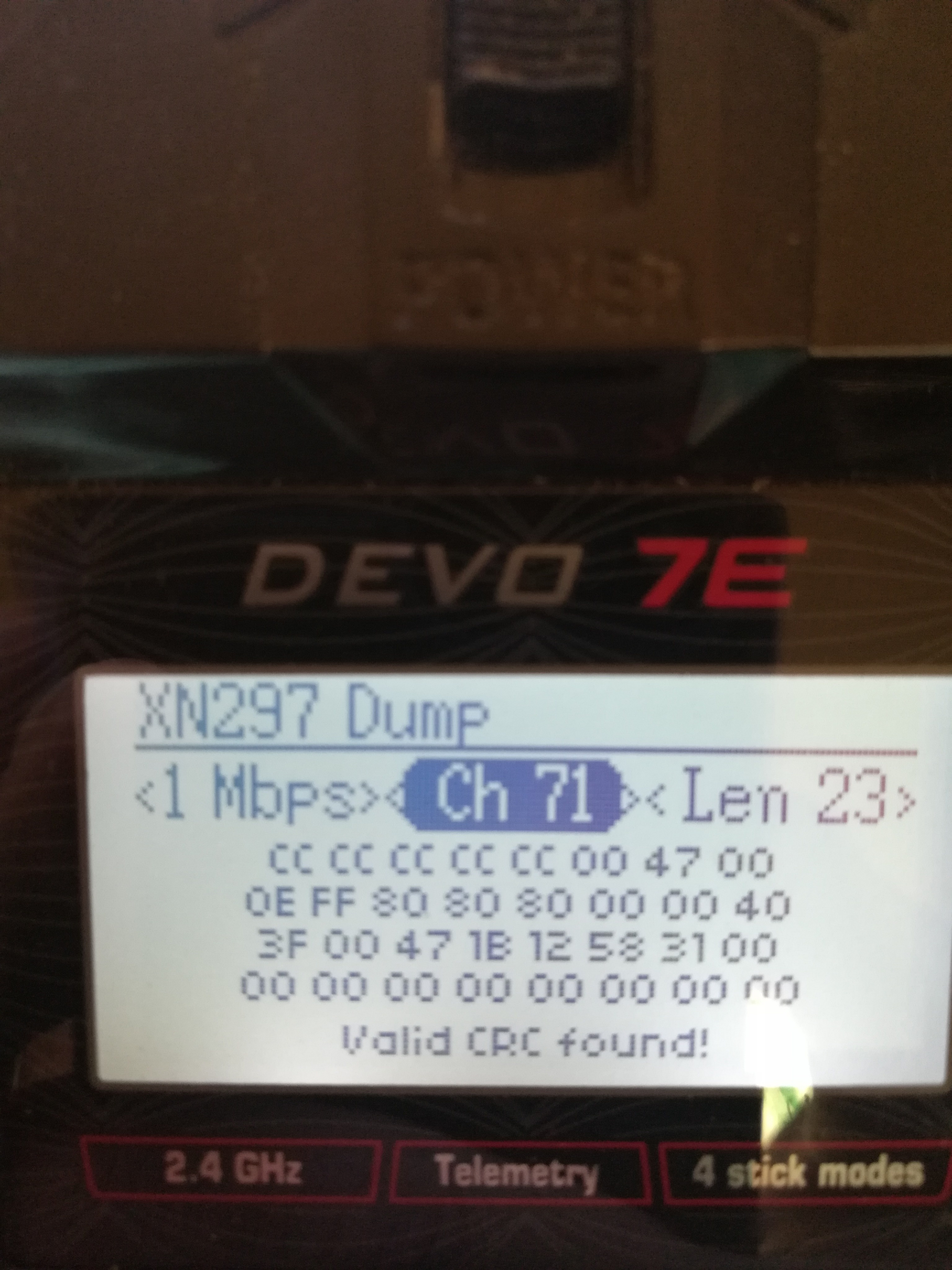

Ok, you mean it's 0E only at full throttle (FF), nothing to do with flip mode ?
On the 2nd picture, seems throttle is full (FF) but the previous byte is 12, not 0E, is it only when RTH is enabled ?
Replied by goebish on topic JJrc345 drones as gift in return for protocol.
Cdog31 wrote: And yes it changes OE at full throttle.
Last edit: 16 Apr 2019 22:41 by goebish.
- Cdog31
- Posts: 38
16 Apr 2019 22:44 #73938
by Cdog31
Replied by Cdog31 on topic JJrc345 drones as gift in return for protocol.
Yes OE. Only at full throttle nothing to do with RTH
