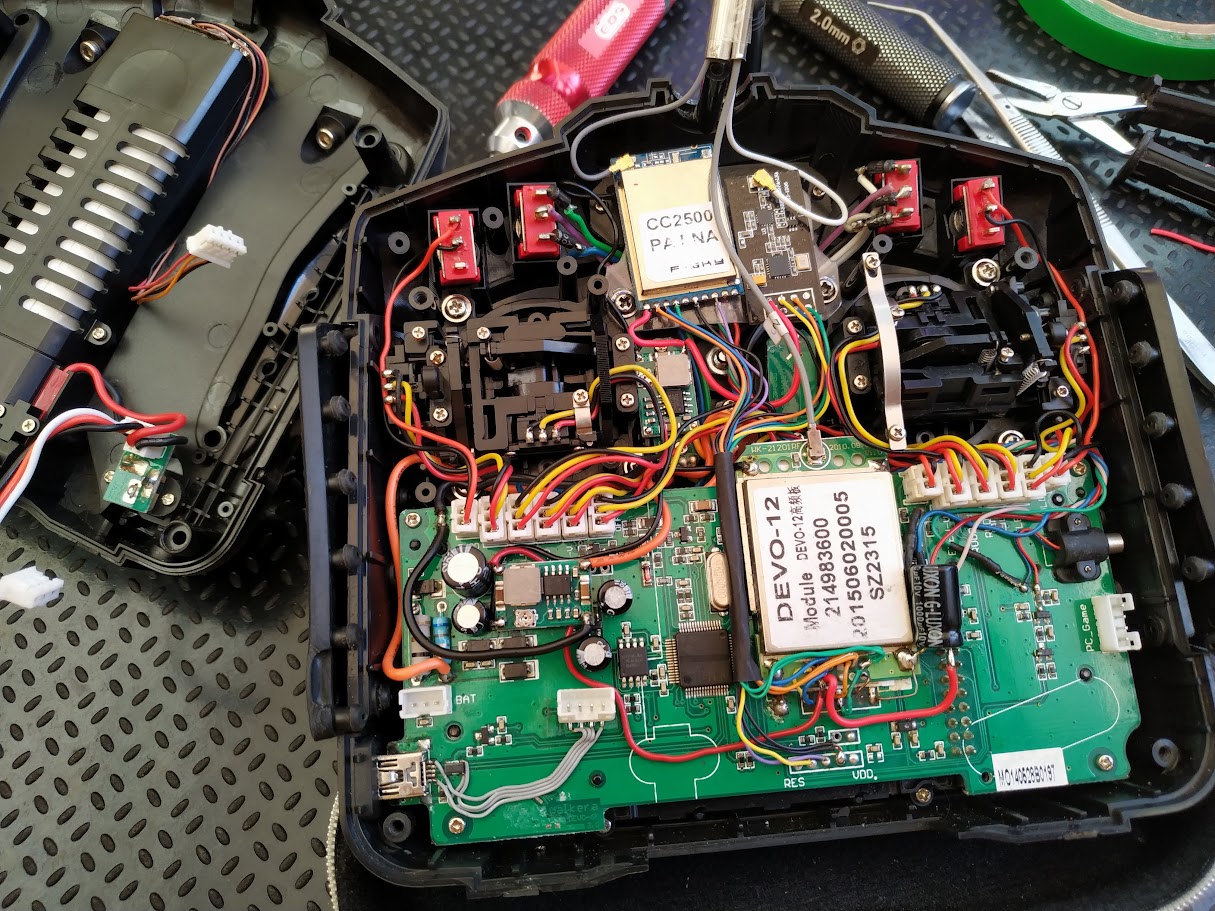

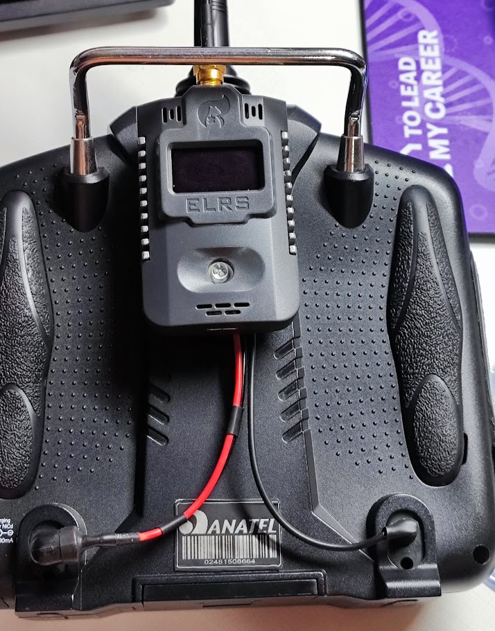

02 Feb 2026 22:30 #78812 by cyberwisk
Replied by cyberwisk on topic expressLRS
I want to make my last contribution; I've found a clean and easy way to install the module expressLRS Jumper AION Nano in the Devo 7e. The only change was a jumper on the charging plug connectors so that it doesn't cut off the radio's power.
I would like to somehow access the module via Deviation TX, so I could install an RX converted to TX internally.
04 Feb 2026 19:16 #78813 by hexfet
Replied by hexfet on topic expressLRS
cyberwisk wrote: I would like to somehow access the module via Deviation TX, so I could install an RX converted to TX internally.
What are you asking? Is the external module in the picture working?
05 Feb 2026 03:17 #78814 by cyberwisk
Yes, the external module works, but it's inconvenient. I want to install an internal module so I can configure it on the radio interface like the other modules.
05 Feb 2026 15:17 #78815 by belrik
Replied by belrik on topic expressLRS
cyberwisk wrote: Yes, the external module works, but it's inconvenient. I want to install an internal module so I can configure it on the radio interface like the other modules.
Trace the wires that you have used externally to the internal board locations and solder to these. You can then use an eLRS TX option that will fit internally. Be aware that RX-as-TX will typically be limited to 200mw or whatever telemetry power the RX has.
05 Feb 2026 15:59 #78816 by hexfet
Unfortunately the 7E does not have enough memory to support the CRSF configuration menus. An internal module won't make a difference there. The 256KB memory mod has to be installed for the 7E to support CRSF configuration.
To use an rx-as-tx the only issue I can think of is that the external module CRSF connection is on a single wire, while the receiver will have separate tx and rx connections. I'll take a look at adding a protocol option to support full-duplex CRSF.

06 Feb 2026 02:24 #78818 by cyberwisk
I am very grateful for the responses, I will order a new STM32F103RC processor with 256k of memory and I will bring the news here,
this is my beloved Devo 7e that I have been using since 2015, I have another new unit in the box that I will mod.
