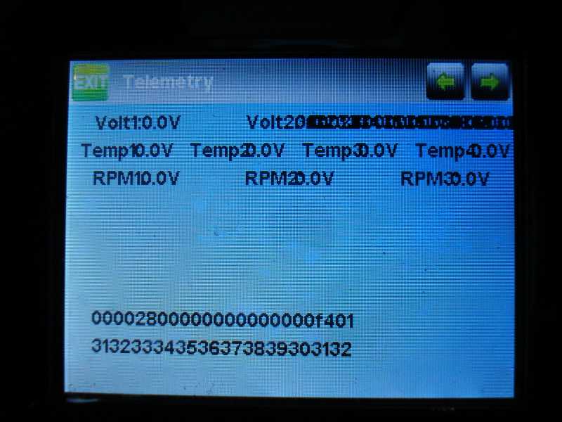

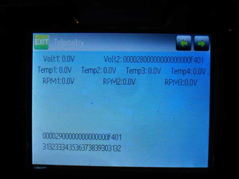

flint723 wrote: I can also report that, with my ladybird, everything except the two numbers on the bottom of the telemetry page is reading 0.0. I did copy the media directory. The two numbers on the bottom are 00002900000000000000f401 and 313233343536373839303132. The model still functions correctly.

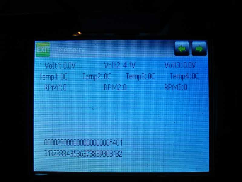

That at least is good. It means one of the voltages is 4.1V. It also means that only half of the expected data is being received. I'll make another build that doesn't update the sreen so often that should help.

I used that firmware and it did cure the jerkiness. And now voltage 2 is trying to display something but I can't tell what it is. It looks like it's putting the really long number in, it goes off the edge of the screen.

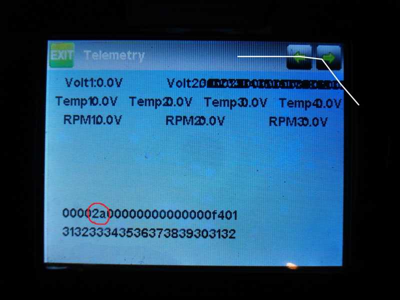

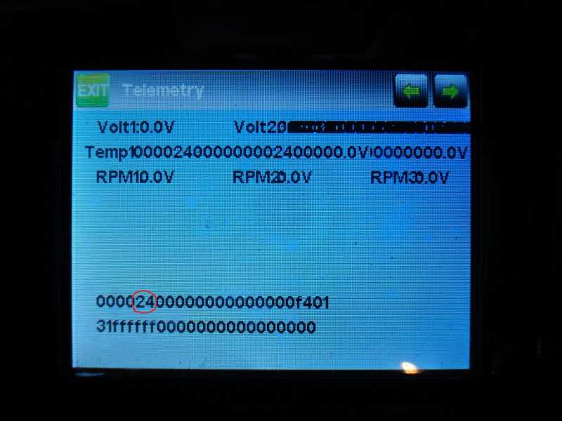

Here's something a bit more interesting perhaps, the two digits circled in red are what changes with battery voltage, not the ones at the end. The first picture is at 4.2v resting, second is at 3.7v resting. With a full battery, it is 2a resting, but as soon as the motors start running it drops to 29. At the end of the pack it will drop as low as 22, which should be around 3.4v. Also about halfway through the pack the bottom number changed from what it was in the first picture to what it was in the 2nd picture. Hope this helps.

Yep, fixed the fonts. Although the voltage is still not displaying as a voltage.
09 Oct 2012 04:31 #2085 by PhracturedBlue
Replied by PhracturedBlue on topic Support for walkera telemetry.
This should fix that problem:
09 Oct 2012 04:38 #2086 by flint723
Replied by flint723 on topic Support for walkera telemetry.
Why yes it does fix it :)
