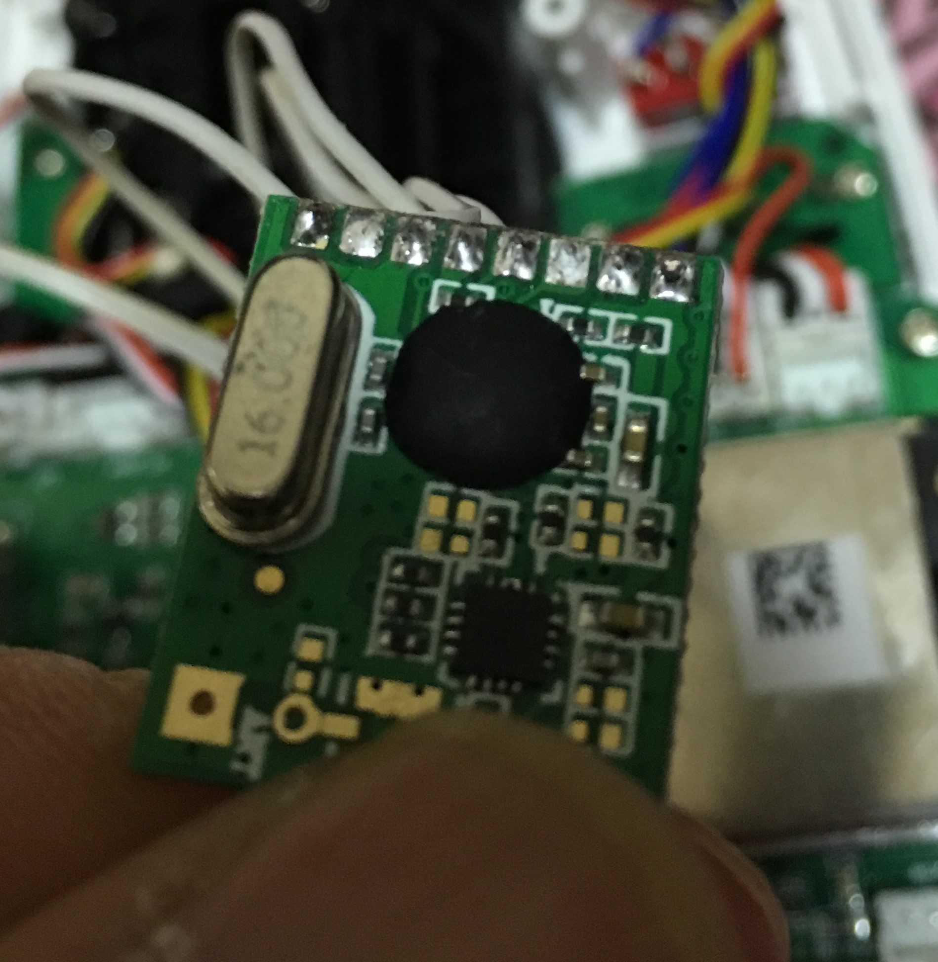

That error happens under a number of conditions so it might not be the CYRF that is the problem. Walk us through your installation: First are all the TX solder points properly connected and in good condition? Second, are the wires in good shape, no shorts or breaks, and as short as necessary? Next, is each module connected to the correct wire? Next, is each module termination point in good shape no shorts or breaks?
We may be able to spot something if you post detailed close ups of the module connections and the Devo connections. If you include a photo with a clear view of all the wiring we can review that as well.

Brothers, here's the photo, hope can help.

I'd try to roll back to V4.0.1, but still the same problem. I had follow all the steps including upgrade firmware, copy the file system and enable the modules. If I just want to use the tx without any model settings, did I need to download the model configs ?
- David Lau
- Posts: 11
27 May 2016 15:11 #49375
by David Lau
Replied by David Lau on topic Problem of Devo10 after upgraded
I just removed all the modules and found the tx works normal. I think there were some wrong with the connections of the added modules.
