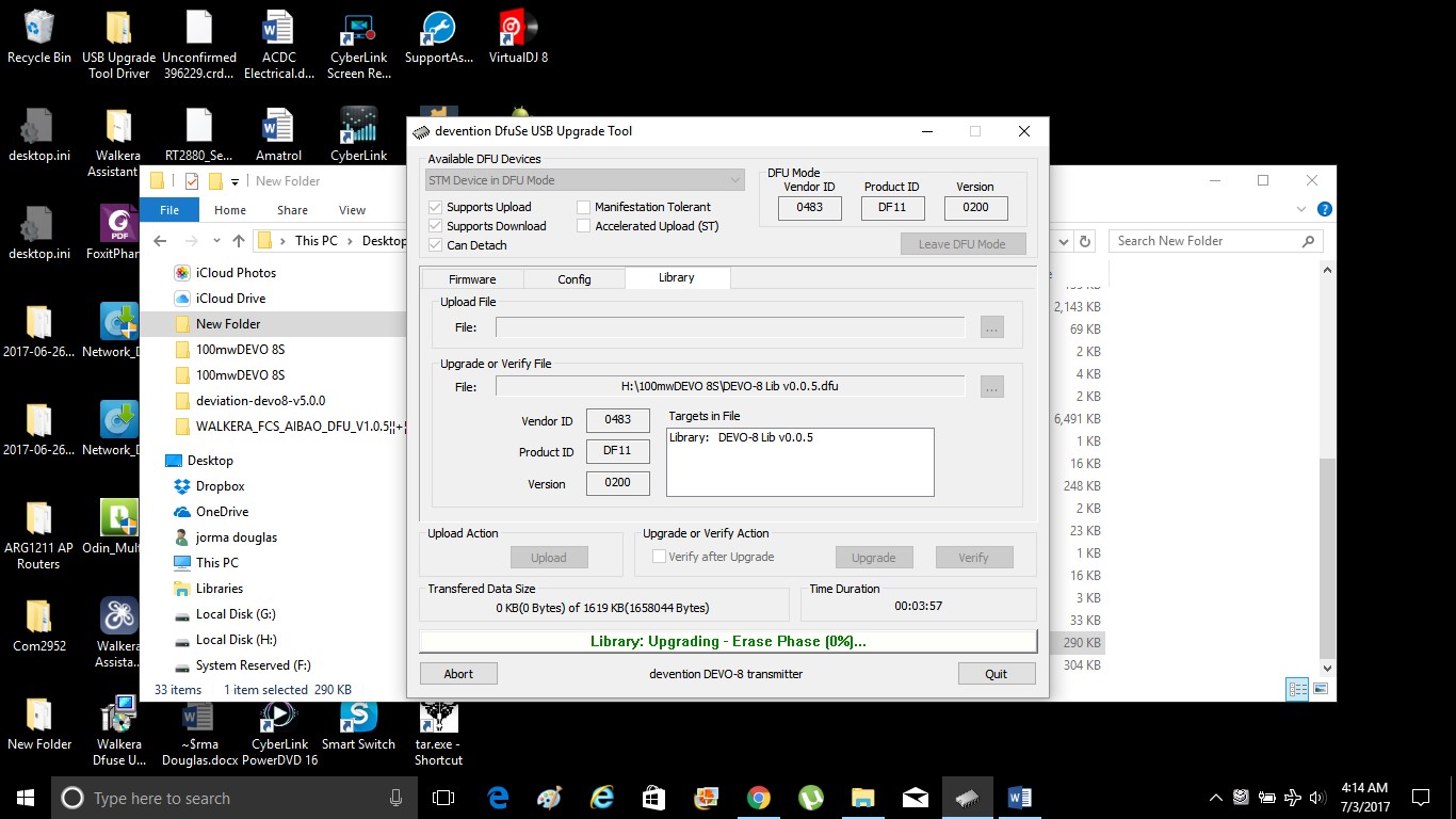

I am looking for help to return my controller to working status again,
I attempted to upgrade my DEVO-F8E Controller for the Walkera Aibao with a DEVO-8 build and the TX is getting stuck at Library upgrade stage and stays in Dfu mode when powering on.
Is there any way to take my TX back to stock or unbrick it somehow?
03 Jul 2017 18:40 #63266
Replied by FDR on topic Walkera Aibao DEVO-F8E Transmitter Firmware Help
I suggest you to contact Walkera for the F8E firmware, and tell them, that you have accidentally upgraded it to the wrong firmware version...
They usually help.
However if they will send you the fw, please share it, because there might be others out there who might need it.
They usually help.
- Jorma
04 Jul 2017 22:32 #63295
by Jorma
Replied by Jorma on topic Walkera Aibao DEVO-F8E Transmitter Firmware Help
Thanks for the advice FDR,
Walkera came through once again and provided the Firmware for the Walkera Aibao DEVO-F8E Version Transmitter Let this be my donation to the forum!
