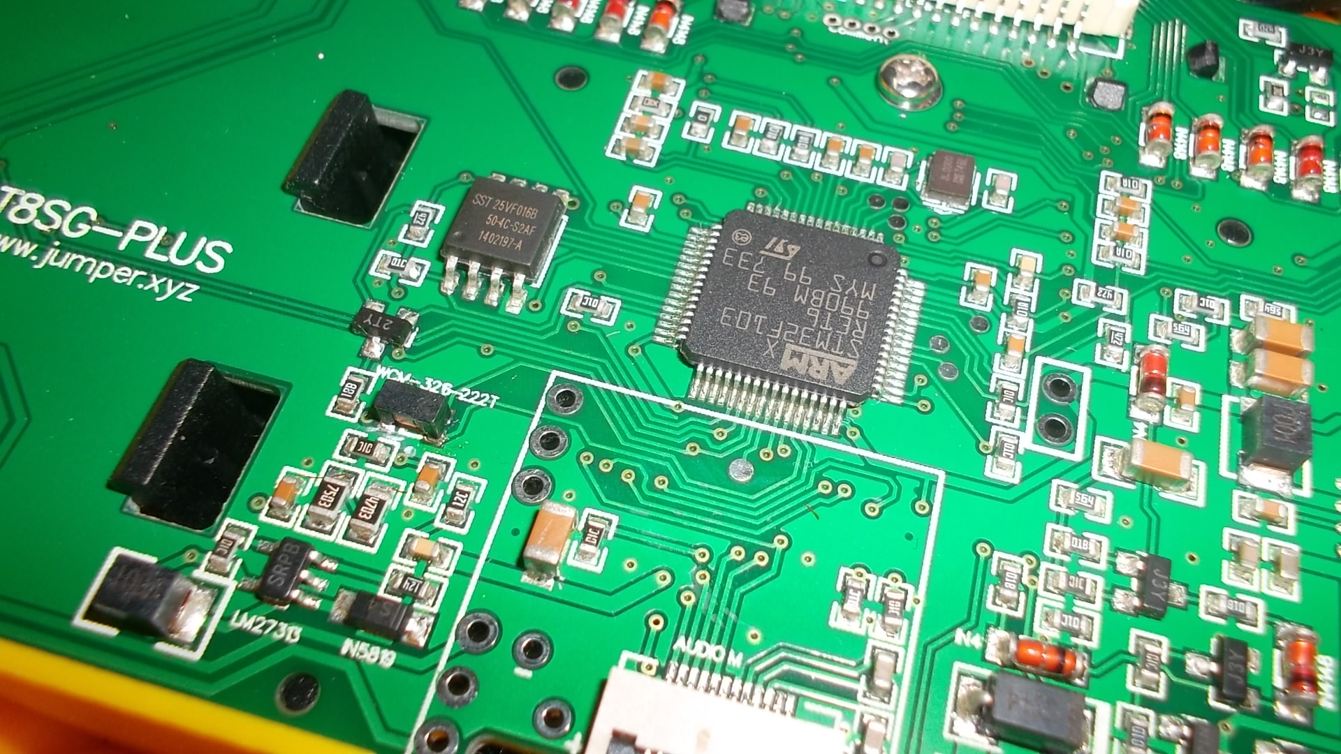

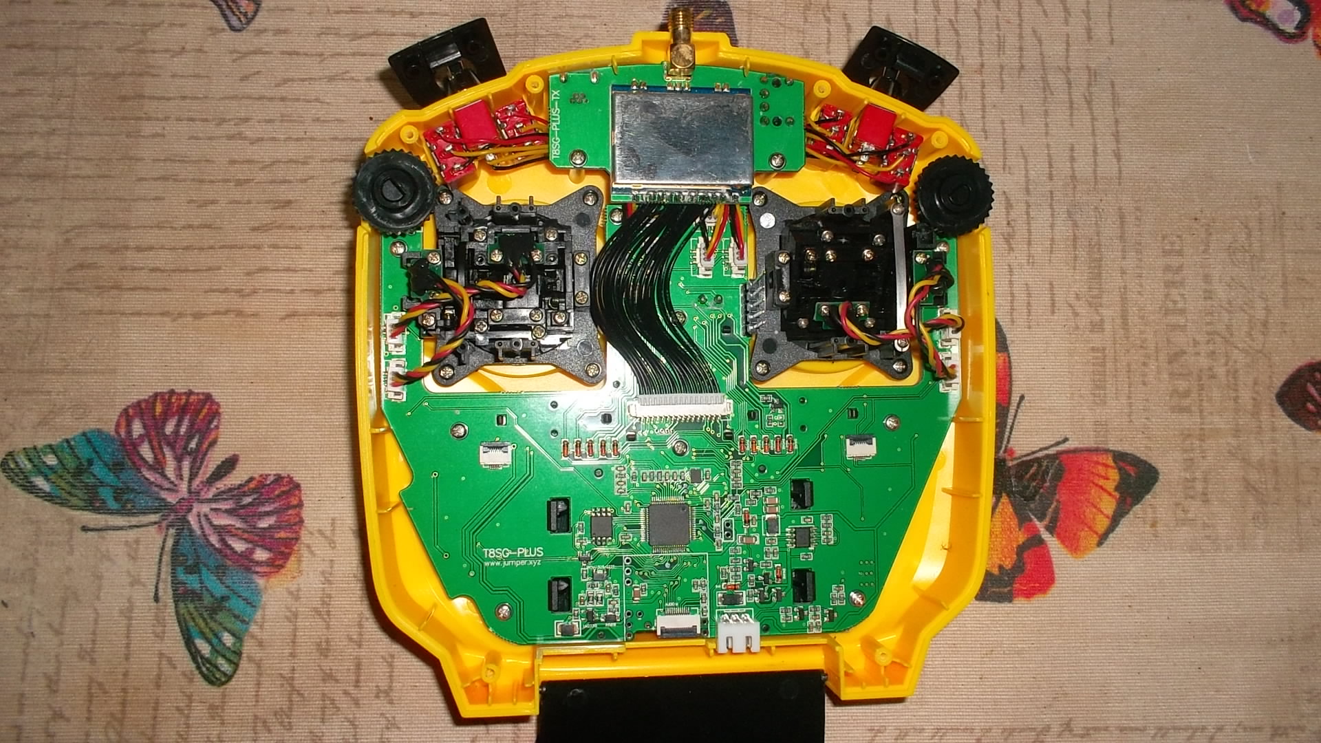

- popad
- Posts: 27
27 Sep 2018 07:53 - 27 Sep 2018 07:54 #71057
by popad
Replied by popad on topic Firmware Update Jumper T8SG Plus
I have tried on Windows XP and 7, all drivers. Just "defective USB device" I receive. What can I check on motherboard to see if USB connection can be made with success ?
Any advice ? Must change the motherboard for that ? All functions are right, only USB connection to any PC is not possible.
Last edit: 27 Sep 2018 07:54 by popad.

- popad
- Posts: 27
28 Sep 2018 12:37 - 28 Sep 2018 12:52 #71079
by popad
Thank you.
I have tried lsusb, but I don't see my T8SG V2 Plus.
I will try on Ubuntu 18.04.1, again, but from what I already saw, it's something flawed with USB part on my station.
I don't know how and what I can check about that. In rest station works fine, no problem. All this summer I flew my micro dlg gliders with it.
It's frustrating that I can not connect it to my PC
Last edit: 28 Sep 2018 12:52 by popad.
