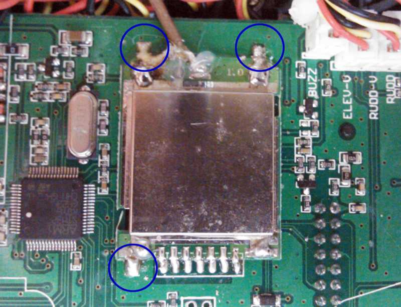

In order to replace 7e module with 8s's I am going to remove the original one.
But there are unknown soldering spots as below picture in blue circle.
Do these spots have specific purposes or just glue the module?
Please let me know otherwise let me know the whole process of the removing the module.
- domcars0
- Posts: 390
20 May 2013 17:15 #10159
by domcars0
Replied by domcars0 on topic replacement stock 2.4 module
I think this spots are just for well 'ground' (put a good 0 Volt) the module.
- RandMental
- Posts: 521
20 May 2013 18:59 #10162
by RandMental
and mechanical strength to take strain of the soldered connections when the Tx is bumped or dropped.
Replied by RandMental on topic replacement stock 2.4 module
domcars0 wrote: I think this spots are just for well 'ground' (put a good 0 Volt) the module.
