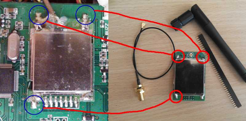

Thank you for the answers.
I am ready to replace it. All the parts are prepared:
Antenna, cable, pin socket and module.
As the below picture, do I connect blue circles to red circles?
21 May 2013 05:53 - 21 May 2013 05:56 #10184
Replied by vlad_vy on topic replacement stock 2.4 module
No need to do it. You can fix module at place by any other means.
