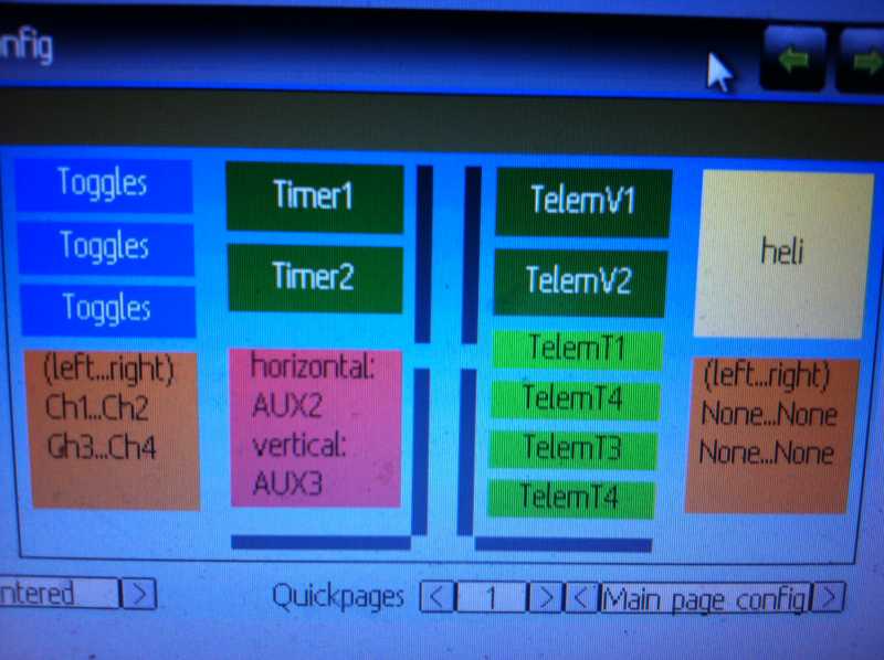

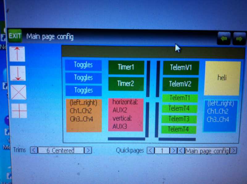

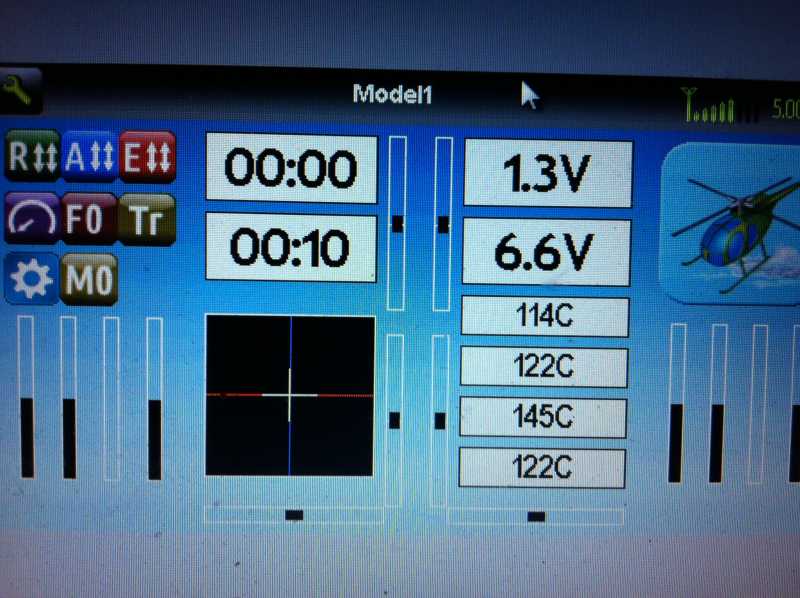

I was doing some final tests of the cc895a on the EMU last night, and found a problem when I tried to place two (left to right) bar boxes on the display. I could get two of them to fit at one point, but after trying to change one of the boxes to different channels it would not save or display the box anymore. It could be a problem only on the emu, but i did not go ahead with the tx flash until i sort out whats happening.
I like this way of setting up the GUI and dont see any problems as far as that is concerned. If there are improvements, like drop down menus, I will be interesting to see if that improves the set up procedure.
I've attached some pics to help explain my problem...
this is what i was able to get on the screen before trying to add other channels to the other box.
editing the box to show ch 5 - 8
what happens when i try to save it
