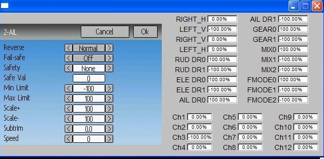

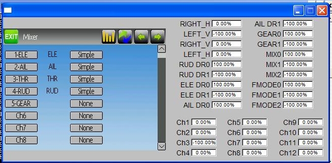

Here are two screenshots of the Elevator & Aileron channels. When I adjusted Ch 3, the values in the menu changed but they didn't for the Ch 2 (Ail) in the bottom right panel.
Unless I've done something wrong, they stayed at the value 0, except for Thr, which I could change at will. It shows -100%

The screenshots do not really tell me anything. Could you upload the model file which is not working? I can import that in the emulator and look to all configured data...

Never mind.
I found out what I was doing wrong and how things work! :blush:

FDR wrote: ...and what was it?
I don't see any significant change in th Ch2 mixer...
FDR,
Since I'm still trying to wrap my head around the EMU interface, mixers and layout of the Deviation FW I didn't notice that Ch 3 for example shows scale value input in the lower right hand panel and Ch 1, 2 & 4 the subtrim values instead of scale or Max +/- input.
I apologize for the confusion and didn't mean to waste anyone's time but this new FW has definitely some learning curve to it. At least in my case. :S
