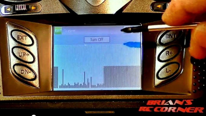

This might be another already covered question but since I couldn't find anything in the manual or in my TX while scrolling through
I'm wondering if the scanner feature is still implemented in v3.0.0?
I think it is a helpful feature...

Actually the code is disabled - I don't know why (a matter of size? Not for Devo8/12). But the code is still present and could be enabled easily. Maybe it was enabled because it was not longer working as a result of side effects and nobody reworked it...
Is there really a need for this? I never used it and I don't know how accurate it will work (well, it should because the used frequencies are determined this way...).

Thanks for the clarification. I'd like to enable the code since I think it might be a helpful feature but if it interferes with other functions/features of the FW or Tx than maybe not.
How can I enable it myself, if you don't mind me asking?

You just have to comment out the
//#define ENABLE_SCANNER 1
in the src/target/devo12( or devo8 )/target_defs.h file
And then compile your new firmware.

I know my way around computers but I have no idea what you just said! :(

What I meant to say in my previous post is where do I find the file and how do I go about it? I'm not a programmer, unfortunately.
Also, are there any reported bugs with using the scanner feature? Any help would very much appreciated.
