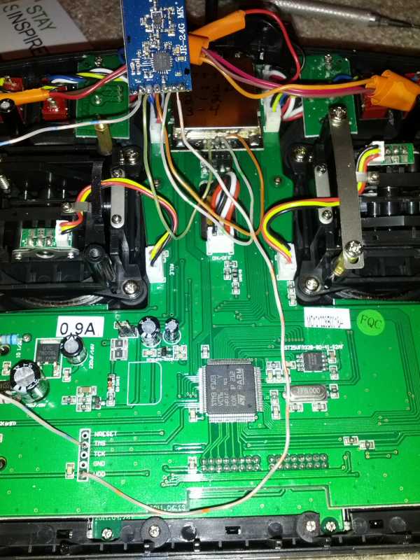

I got a decent pic of the install. I can't see anything wrong but maybe somebody else does?
The white / blue wire on the left on pin 1 that goes out of the picture and comes back in is the one connected to TMS.
