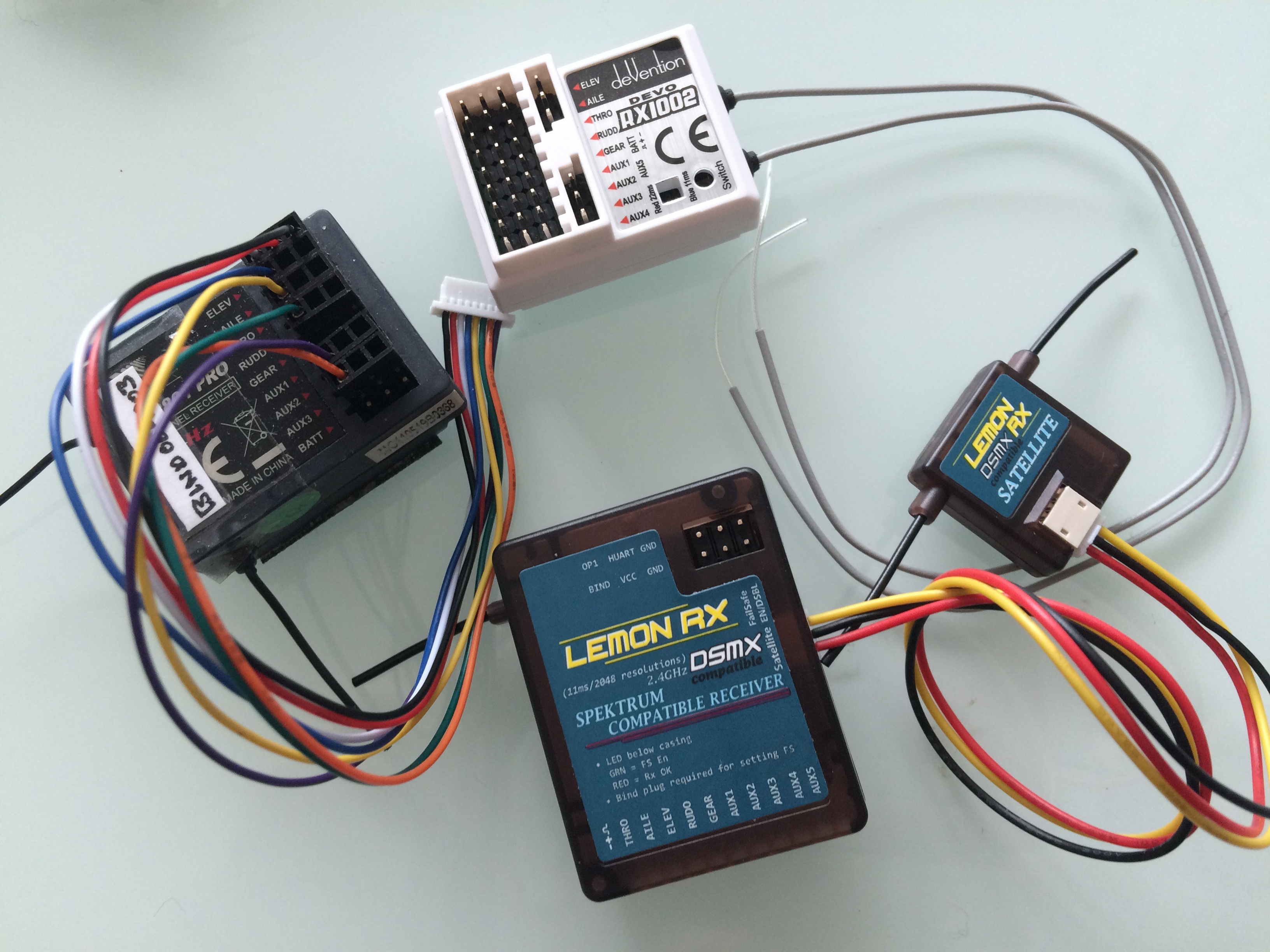

Hey you Deviation team,
Let me feed back a little after exploring my Walkera Devo10 upgraded to Deviation.
This is just so good :)
I have successfully binde 3 of my really important kinds of receivers:
. Walkera 2801, several older but fully active helis
. Devo (7), current quads and OpenPilot things
. Spektrum, future fixed wings, quads and Helis with Satellite receivers
See picture attached.
If, I had bought this Deviation upgrade software for 100 USD, then I would be very happy, really happy consumer. However, I did not spend anything, it was for free.
The interface in TX is more clear, logical, consistent, predictable and well documented (lets not get it to talks of Walkera documentation) than the Walkera standard.
The range of what I now can control wit my Devo 10 Transmitter - old things - current models - and future projects, is greatly enhanced and future prove.
This works for me. Why should it not work for others :)
THANKS A LOT!
