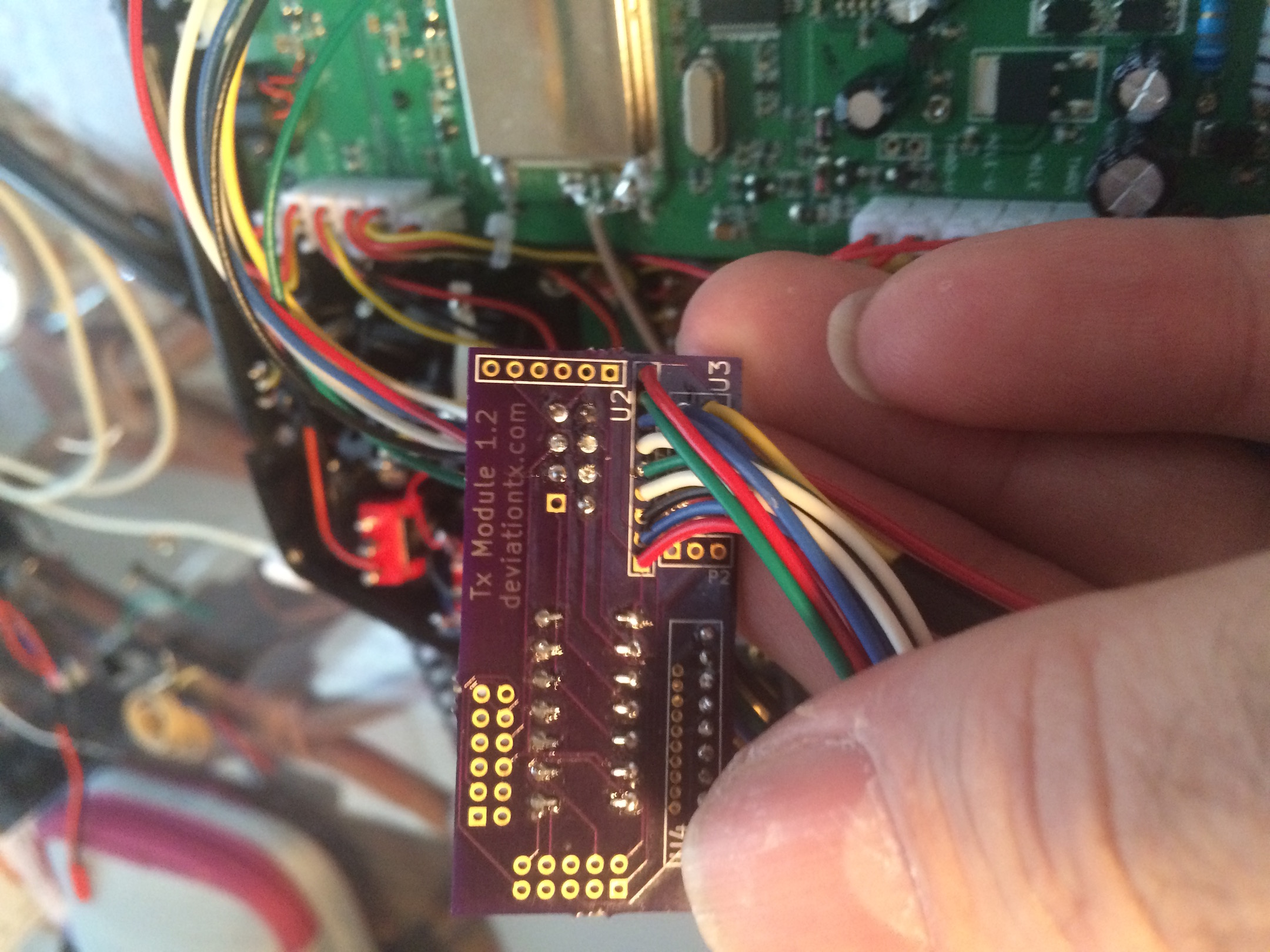

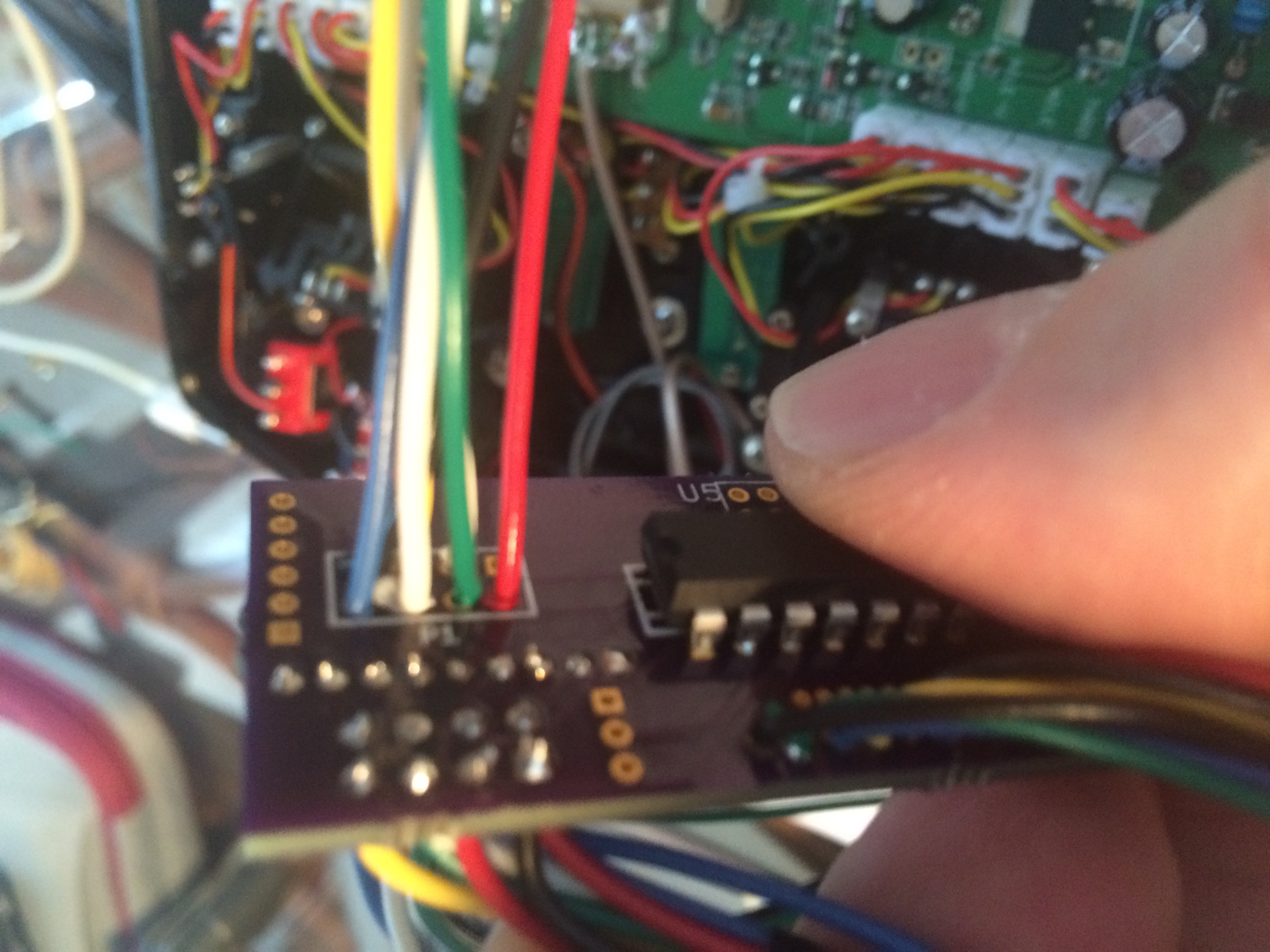

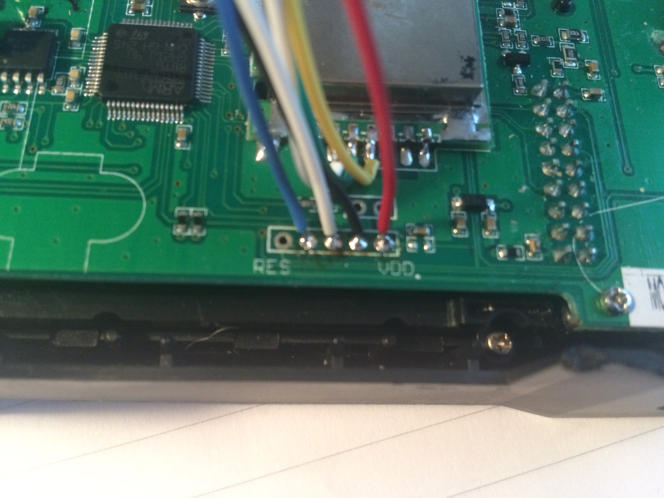

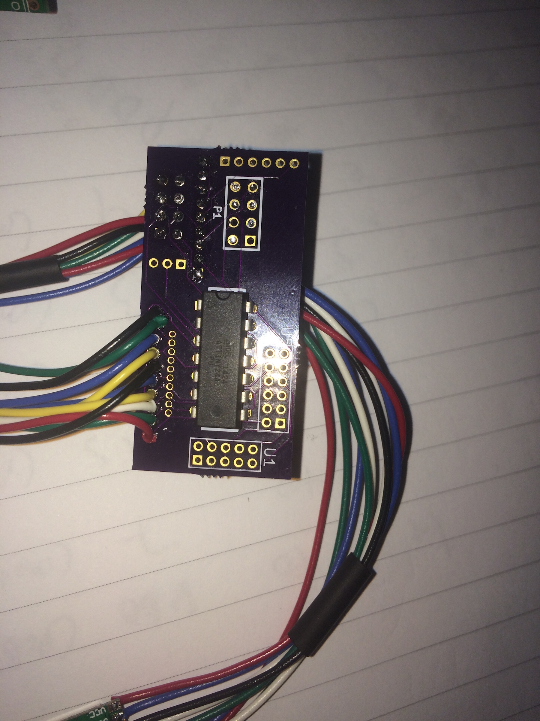

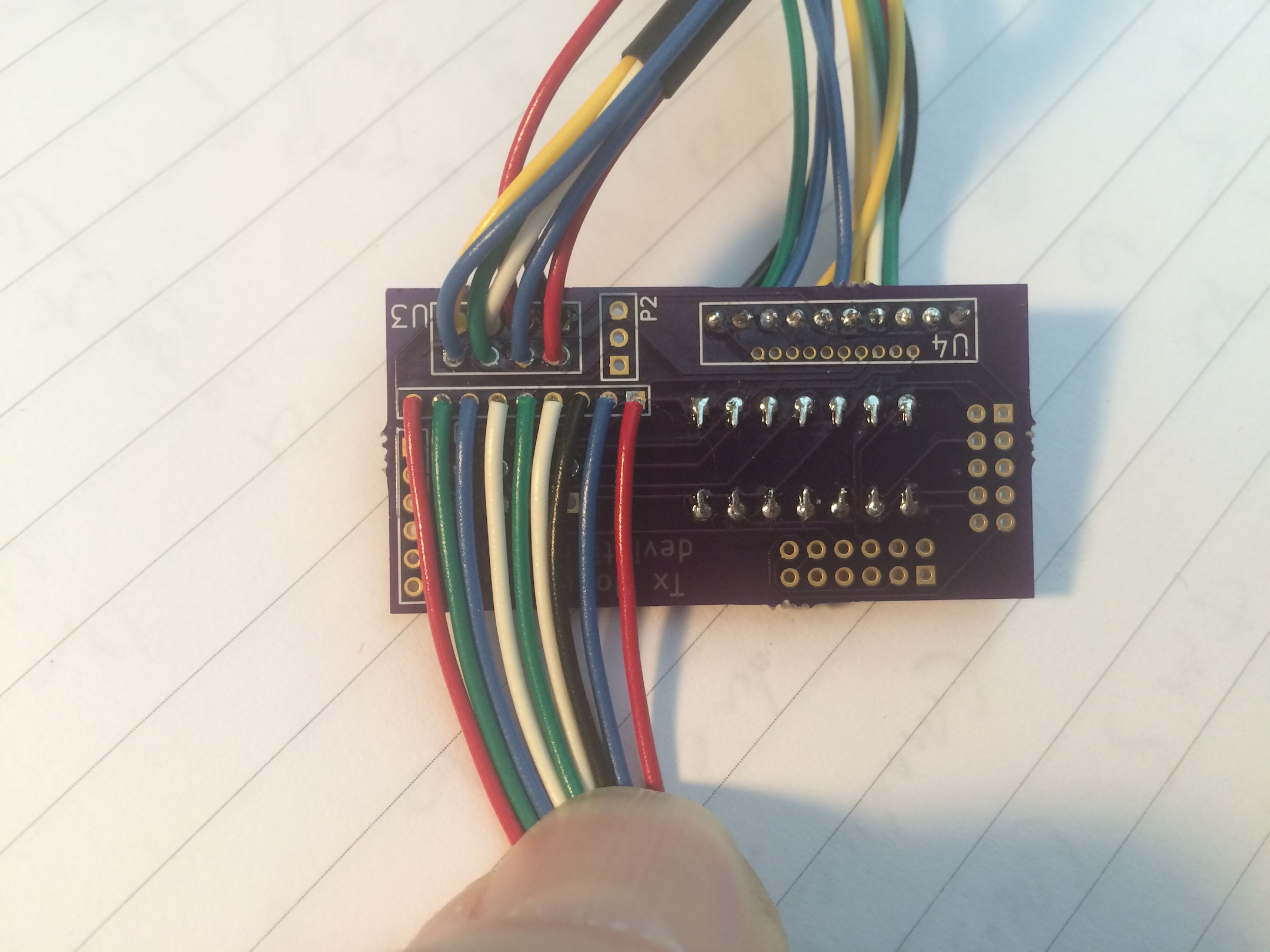

Just hoping to get a little help with a multimodule build/install. I followed the directions posted on this site to build a multimodule. I used board v1.2 from OSTpark, an NR24F-L01, an XL7105-D03, a CC2500AliExpress, and an ATTiny84A microcontroller. I used the AVR.hex from March 26, 2014, with programmer_devo7e.dfu from May 2,2015 to program the ATTiny. I am running deviation-devo7e-v4.0.1-c3007aa as my current version.
After turning unit on with the programmer dfu loaded the screen showed first "unti:1" and then it showed the following, so I believe it programmed successfuly.
found AVR: 0c931e53
hex:17bytes
9 Verified <-- this might be a b Verified, the screen is not clean, the graphics are distorted.
Then I modified the hardware.ini file to reflect the multi-module on A-13, and the three modules on their respective channels, S1, S3 and S402.
After all that, when turning the unit back on with the nightly build dfu loaded the screen shows "module missing multi module".
I have subsequently verified all the modules work individually, when solely connected to the TX unit, and since I was able to do all that, I am relatively sure my soldering skills are not the issue, and that all the modules work correctly.
Can anyone offer any advice on what I might be missing here? is that output from the programmer correct, or is it showing some kind of failure that would explain this?
Any advice would be appreciated.

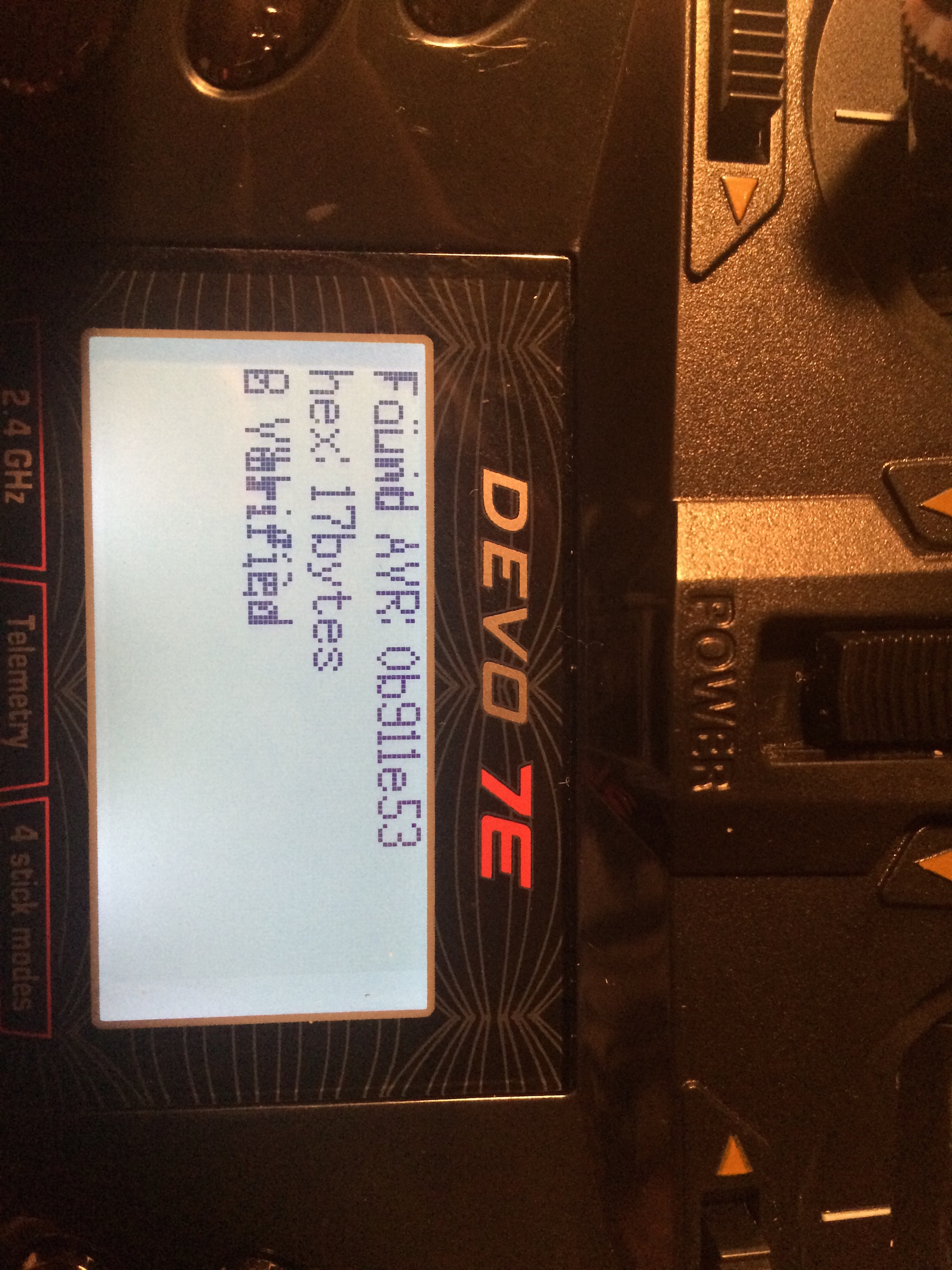

Ok, I ran through this again, using what I have on hand. I used the 7e programmer DFU to flash the v1.2 avr.hex file onto a ATTiny24A-P chip. I get this from the display for the 7e:
First it shows this:
1.Init
then the screen changes to:
Found AVR: 0b91e53
hex: 17bytes
1. Erasing
then it shows:
Found AVR: 0b91e53
hex: 17bytes
2. Programming
And then finally:
Found AVR: 0b91e53
hex: 17bytes
3.Done
If i power cycle the 7e again I only get two screens:
first this:
1. Init
then:
Found AVR: 0b91e53
hex: 17bytes
2.Verified
So it seems to be clearly saying it sees the chip, and is loading the hex fine onto the chip successfully. However, when I power on the 7e after re-loading the 4.0.1-c3007aa dfu, I get "missing modules: multimod"
Again I am positive the modules work properly, as I can remove any of them, connect each of them in turn directly to the 7e and they work fine.
any of this help?
1.Init
Found AVR: 0b91e53
hex: 17bytes
1. Erasing
then it shows:
Found AVR: 0b91e53
hex: 17bytes
2. Programming
And then finally:
Found AVR: 0b91e53
hex: 17bytes
3.Done
first this:
1. Init
then:
Found AVR: 0b91e53
hex: 17bytes
2.Verified
any of this help?

Plus, I am not so sure that your ATtiny84A-P is flashed correctly.
Can anyone else here confirm whether or not the 7e Tx is able to flash the ATtiny micro-controller? From what I can recall, it is not able to do so, and a USBASP programmer is needed to get it done.
24 Jul 2015 18:29 #35925
Replied by mwm on topic MultiModule help
I believe you can flash with a 7E, though that wasn't originally true.

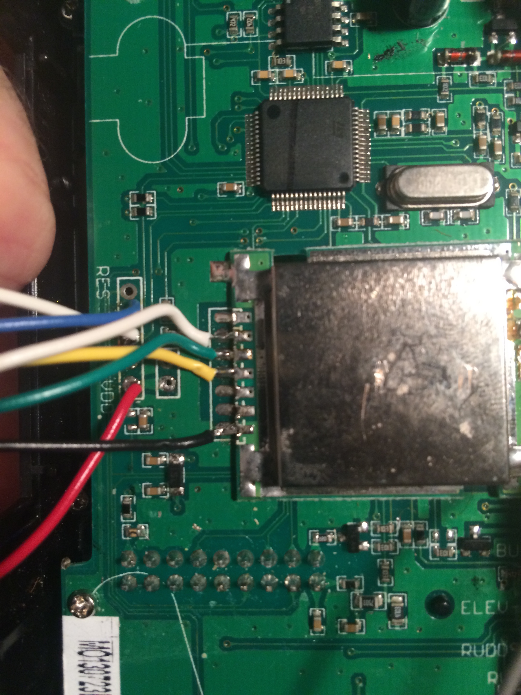

However, I can tell you that the ATTiny is NOT correctly flashed here. The "hex: 17 bytes" is the programming firmware telling you that it only found 17 bytes in the file it flashed to the ATTiny.
So you did something wrong. The programmer you flashed to the 7E is corrupt, or the file it is flashing is corrupt.

I have tried re-downloading the programmer DFU, as well as the avr.hex file, several times. Everything else about the procedure goes as the documentation says it should. I'm not opening the hex file with an editor of any kind, to make sure it's not being altered. I am also successfully able to load the "normal" DFU back to my 7e, and it works fine. (other than the multi-module).
If I disconnect the "reset" pin from my 7e, I get an error that the AVR can not be found. Between that, and the output I get at all, I believe I am being successful in getting the 7e to talk to the chip across the multi-module for programming.
Short of spending $30 on a ATtiny USB programmer that won't guarantee any of this works either, is there anything else I can do about getting the 7e to correctly flash the chip?
I've tried 2 ATTiny chips on two different OSHpark boards and two full sets of modules, and I get the same results when I get to the programming step.
thanks
thanks

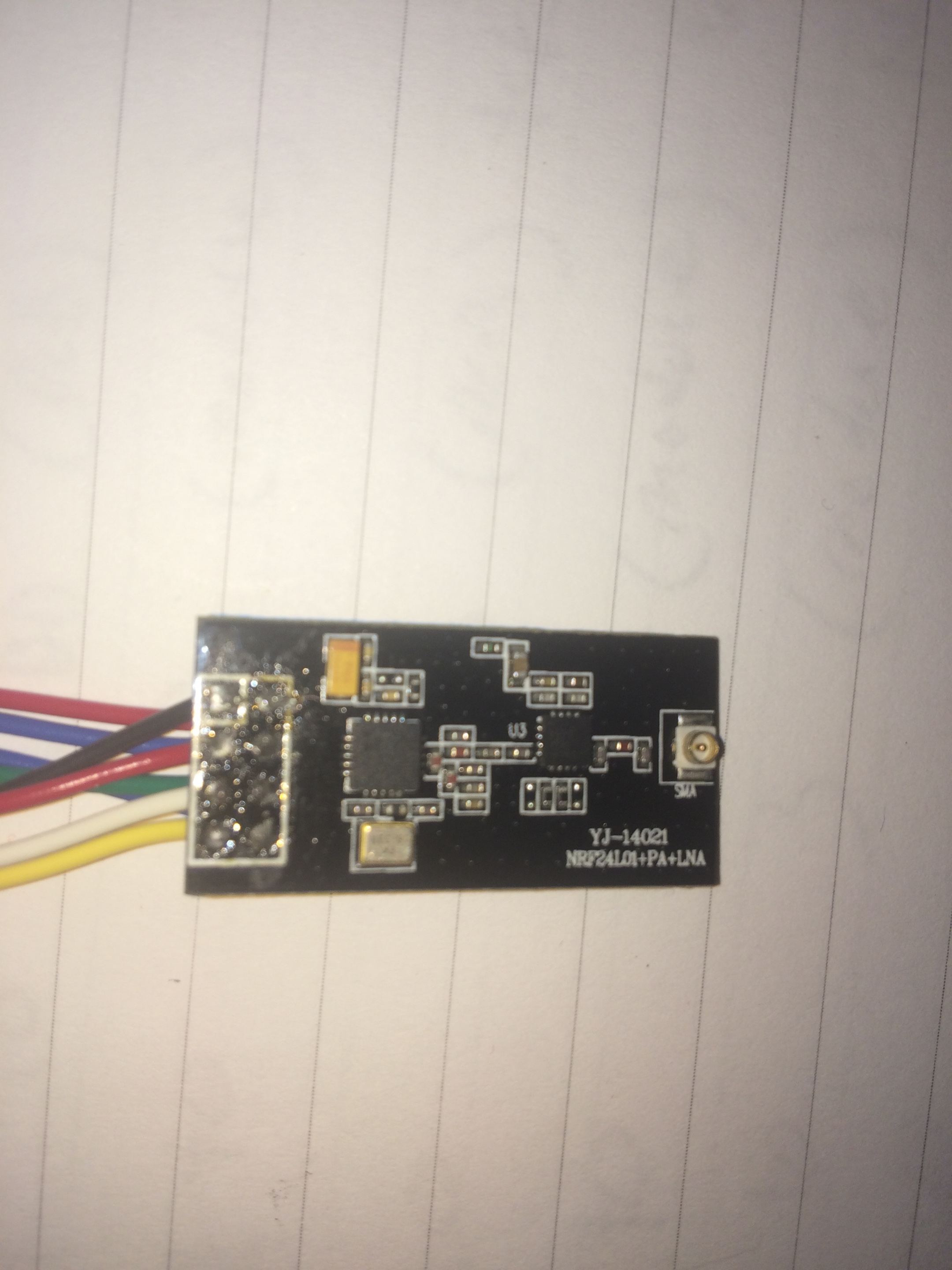

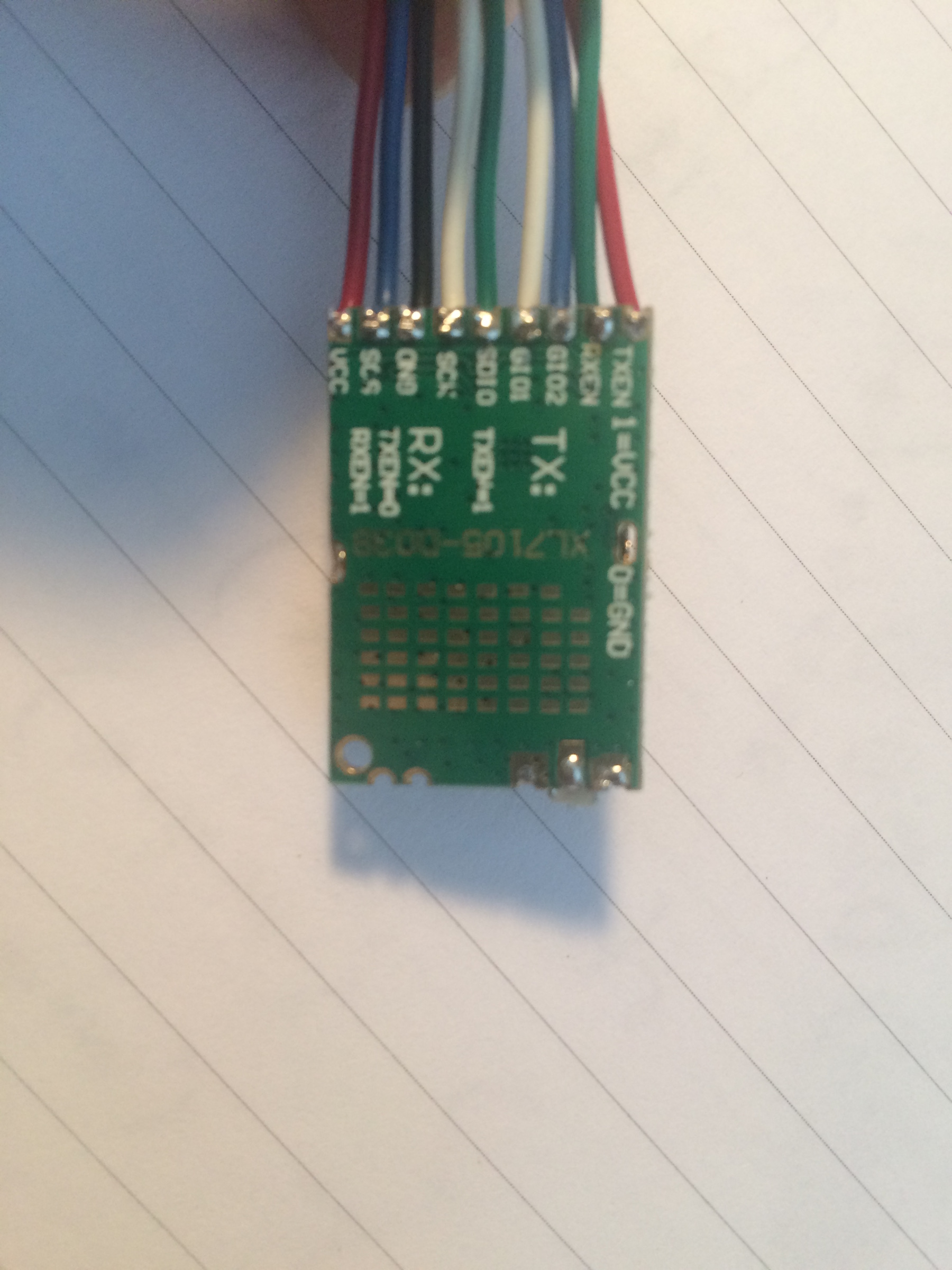

Can you post up a video of the steps you are going through to flash the ATtiny, pics of your MM assembly, its wiring, and connections to the Tx?
- skretchmer
- Posts: 88
25 Jul 2015 19:59 #35971
by skretchmer
Replied by skretchmer on topic MultiModule help
here are some photos and videos as requested.

It may be a coincidence, but I had a lot of trouble with modules in my 7e when I used the ground point you are using. I changed the modules to ground at the 7 pin on the CYRF module and everything worked. I haven't traced it all, but IIRC the two points don't go to ground the same way (if I'm saying that right). It can't hurt to try, right?
- skretchmer
- Posts: 88
26 Jul 2015 06:45 - 26 Jul 2015 06:48 #36012
by skretchmer
I've been using the ground in my photo for all my other modules, both individually, and in the "pair" set I can install by default, and they have all worked fine. It was easy enough to make the change, but unfortunately, even with the ground connected directly to the CYRF module ground I get the same results. The programmer .dfu output looks like the video i posted.
I have also tried leaving the modules commented out in the hardware.ini file when i run the programmer and it does give me a "no switch cfg" error, so it's clearly seeing the hardware.ini file settings, and if i leave out the AVR.hex file it gives me a AVR not found error.
i have extra 3-way switches installed, which work perfectly, but i even tried disconnecting them from the backplane just to make sure, and everything is the same.
thanks
thanks
