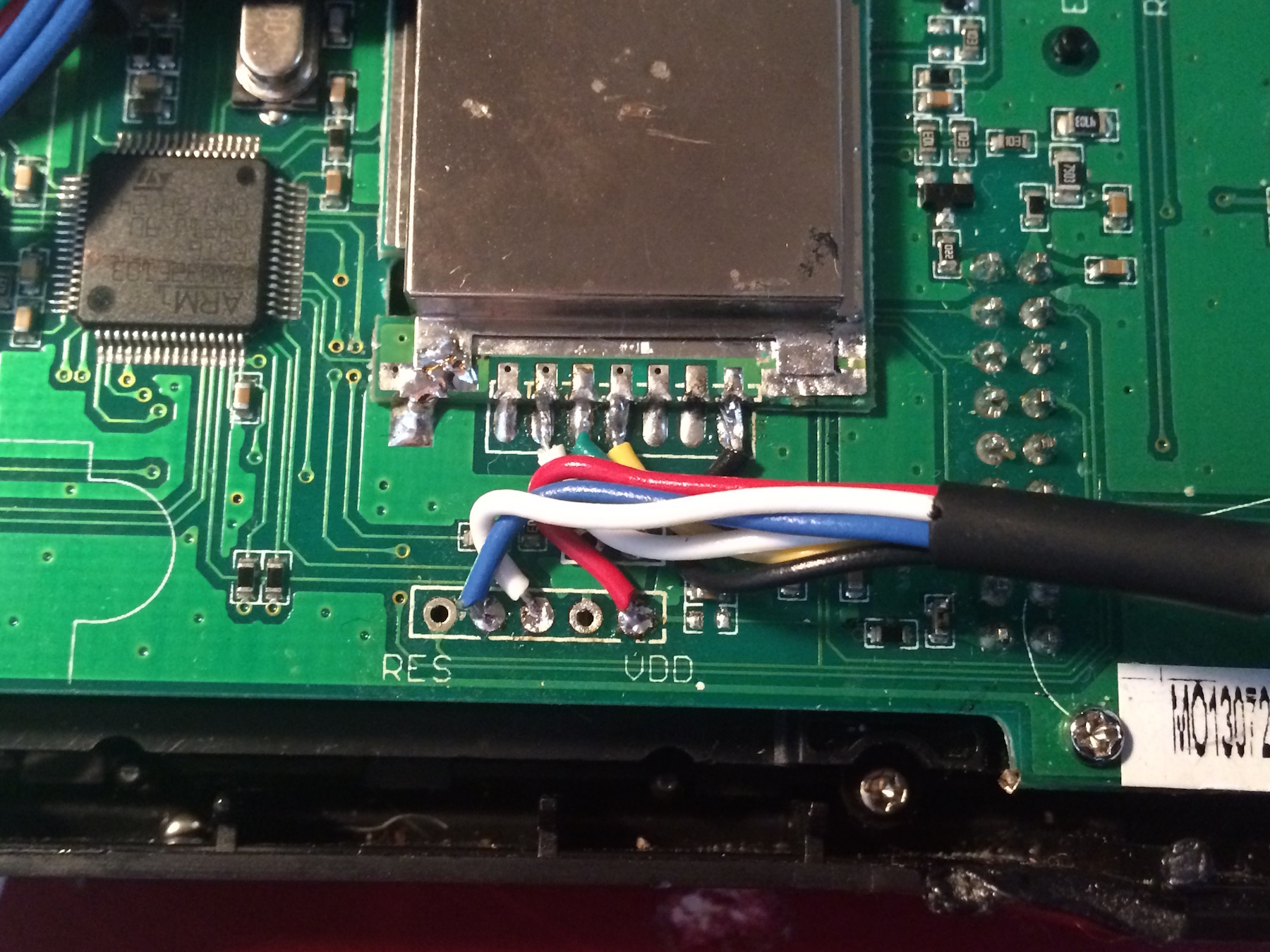

i've re-soldered the connections between the board and the TX multiple times. I can get continuity with a multimeter across every soldered connection.
if I disconnect any single line, I get errors, so I'm pretty sure i'm getting good solder joints.
thanks

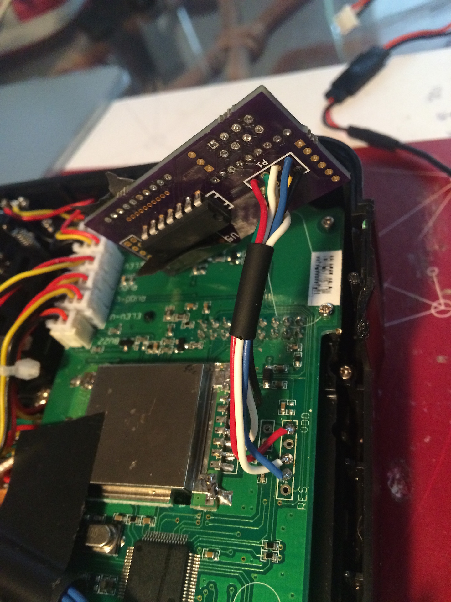

ok, i took one last shot with what I have. just the multi-module board directly to the TX, with as short a bunch of wires as I could imagine working with and still be able to get the board inside the radio. I get the same results. It will flash the chip, but only 20bytes (using the 1.3 AVR.hex) and on boot it shows module missing.

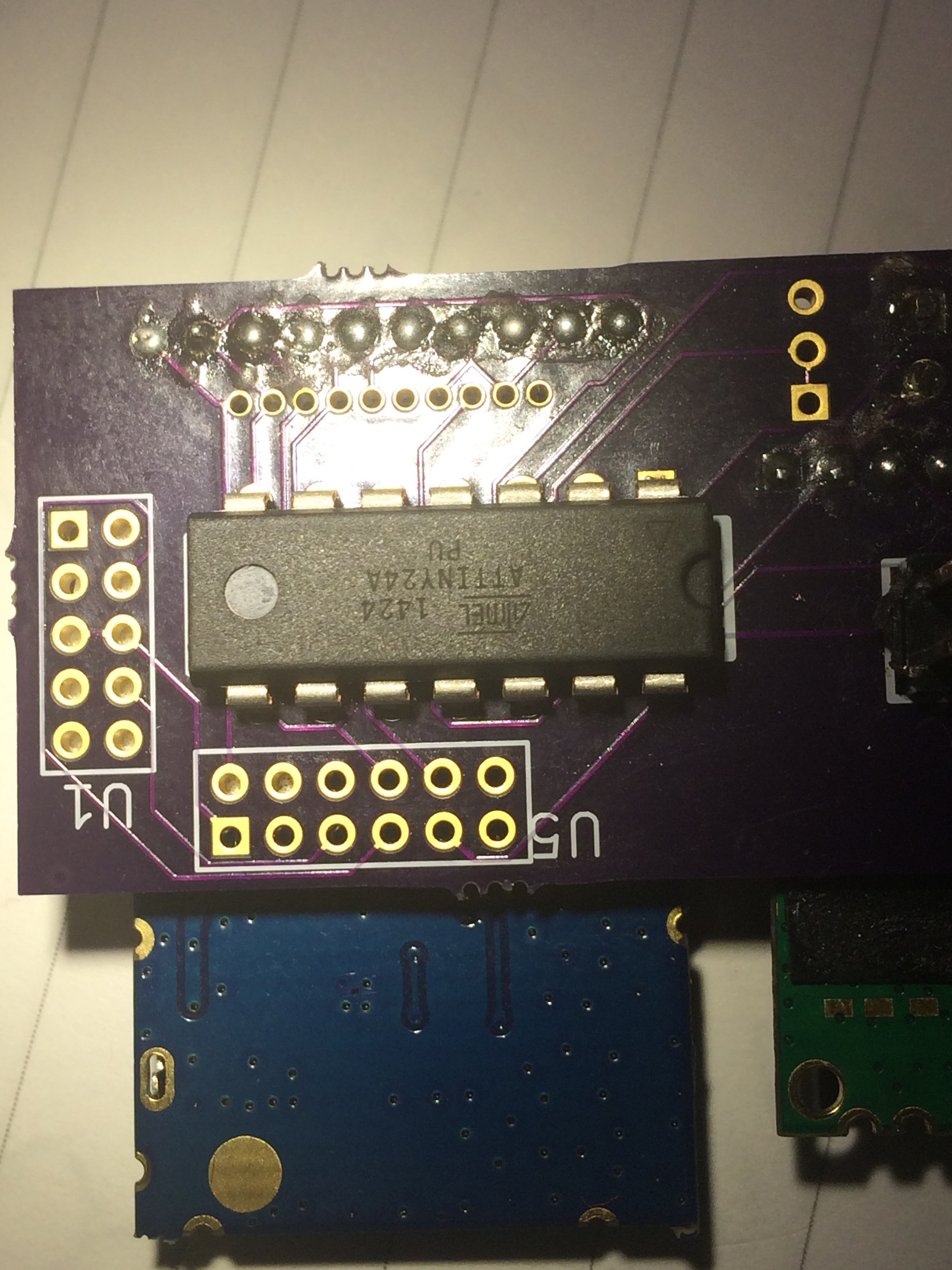

I don't see, or can't really tell, if there is real good solder flow to the pads on ATtiny side of the MM board. Perhaps after soldering, de-soldering, and re-soldering so many times, one or more pads has separated from its via to the other side? Which is why I suggest continuity and resistance check from the pins of the ATtiny itself to all their points on each board, the main Tx board and the associated transceiver pads of the MM board.

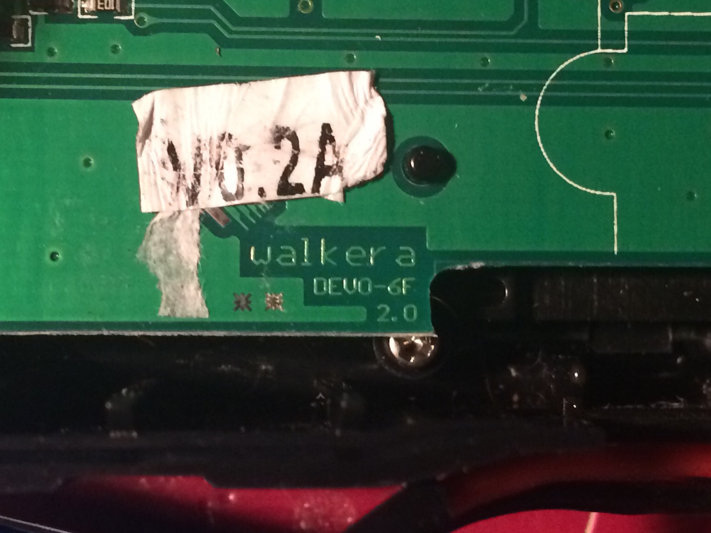

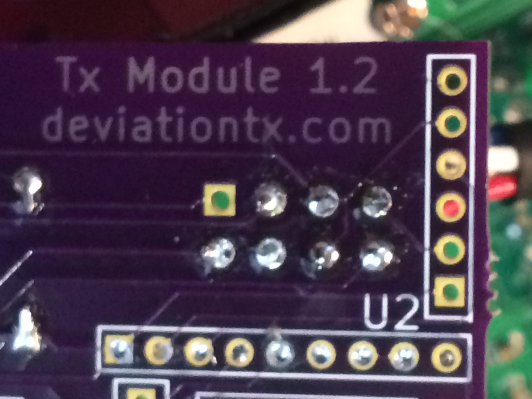

I can clearly see that the traces on my Multi-module board are different than either of the boards shown on the wiki. My board is a "Tx Module 1.2, deviationtx.com". Are we sure that either of the AVR.hex files available are for this board?
Also, i assume these radios are fairly stable now, but my backplane board says Wakera DEVO-6F 2.0 on the board itself, and has a white sticker over that with black lettering V0.2A. is it possible this is a new version of something?
thanks

Perhaps reflow the solder on the ATtiny then? ....cold joint maybe?

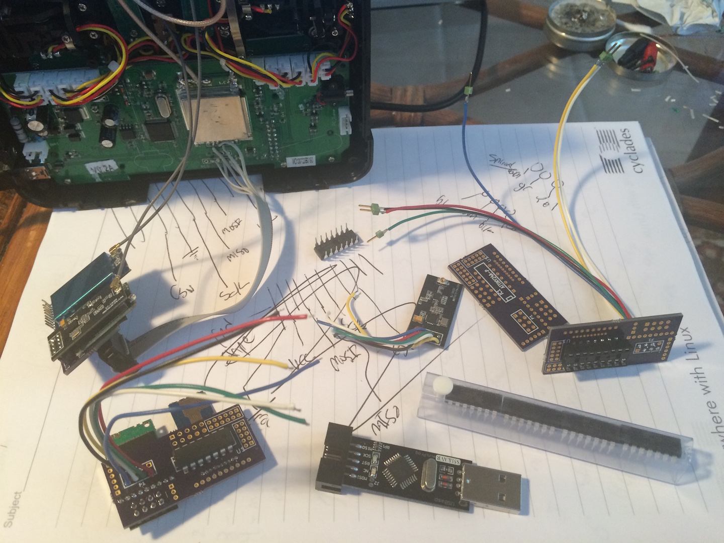

i am all but ready to just give up on this altogether. I have now been able to successfully flash the AVR.hex file for both the 1.2 and the 1.3 board. I have built two full multi-modules with the chips that said they were successfully programmed, but neither of them work once soldered into a TX. I have made the appropriate changes to the hardware.ini file, and I can make any two of the modules work just fine when directly soldered to the TX. The only thing I can not make the TX recognize is a multi-module board. Neither with just the chip alone, or fully assembled multi-modules will be recognized by two different TX's. I do not believe I am making any mistakes anymore, and for sure I am not making the same mistake over and over.
06 Aug 2015 15:43 #36615 by skretchmer
Replied by skretchmer on topic MultiModule help
just to show, you can see the two fully assembeled boards, and the chip-only board i am using as a programmer as well as the additional modules I have been soldering back and forth.
