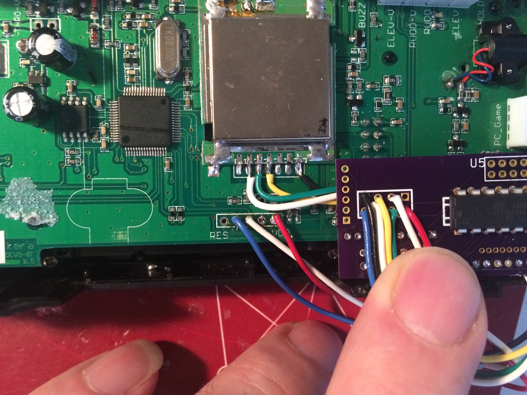

here is my best attempt at a photo showing the wiring to the multi-module with no modules installed. There are two white wires because i only have a 6-color set. You have to trust me that the reset white wire goes to the TCK port on the backboard, and the SCK white goes to the SCK spot.

One other thing to check would be continuity from the ATtiny pins to their proper points on the Tx board and its other points on the MM board. You can download the MM circuit board design files from OSH Park and view them with a gerber file viewer, like gerbv, to figure out where they should all terminate.

Number one issue flashing AVRs is dry soldering. Re flux and re heat till nice and shiny solder.
Swapped miso / mosi or miss connected but you just get errors.
Get the 3.3v / 5v one and very cheap.
Well from what I've seen posted you've done it all very well. So barring software issue.
