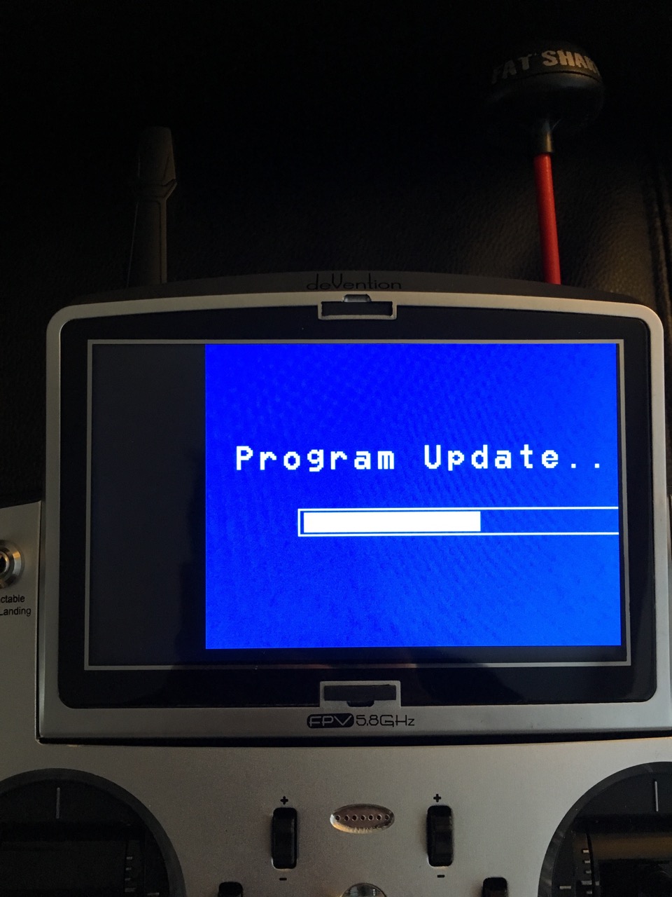

Please show me your programming screen (Boot while holding EXT)

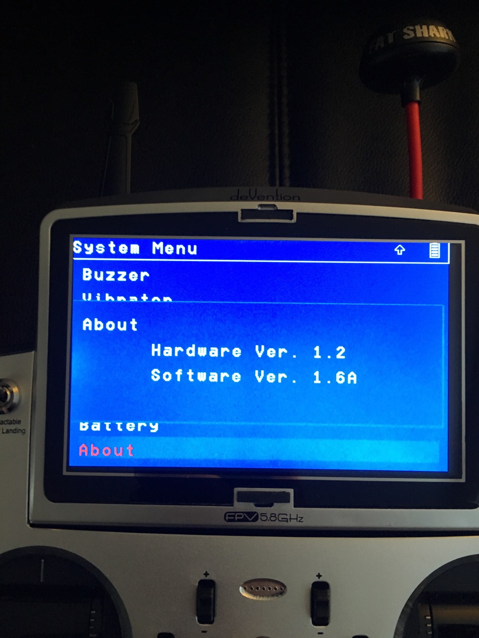

09 Apr 2016 17:49 #46194 by mustgetsomesleep
Replied by mustgetsomesleep on topic Devo F12E Incorrect Screen Resolution
I am not sure if this helps but this resolution programming screen has been like this since i bought the f12e .
09 Apr 2016 17:56 #46195 by PhracturedBlue
Replied by PhracturedBlue on topic Devo F12E Incorrect Screen Resolution
I wish you had told me that earlier. I am trying to copy the initialization used by the programming screen, so if that is shifted, than of course my code will be too.
Can you show me what the screen looks like when you use the official 1.5 firmware?

Sorry i was under the impression you understood ! the first time i turned the F12E on everything was ok but when i tried installing the deviation firmware i switched into program mode and that was the screen i was and always have been greeted with , After your 99% sucessful firmware any further firmware from yourself and any original firmware results in the screen resolution with the gap on the right and the gap on the bottom
But no matter what i do the Programming mode always shows the same screen resolution .

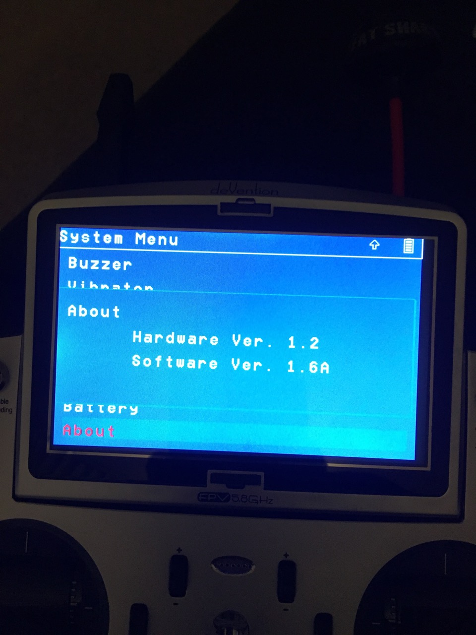

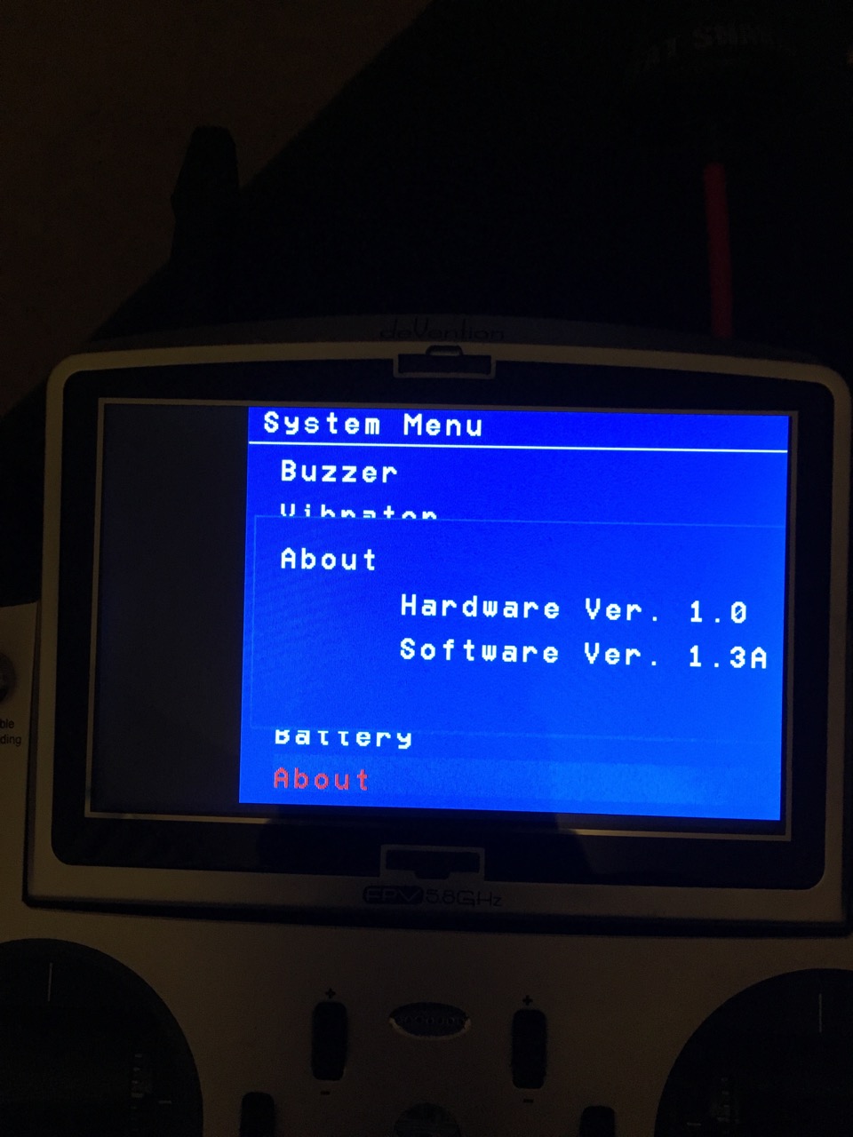

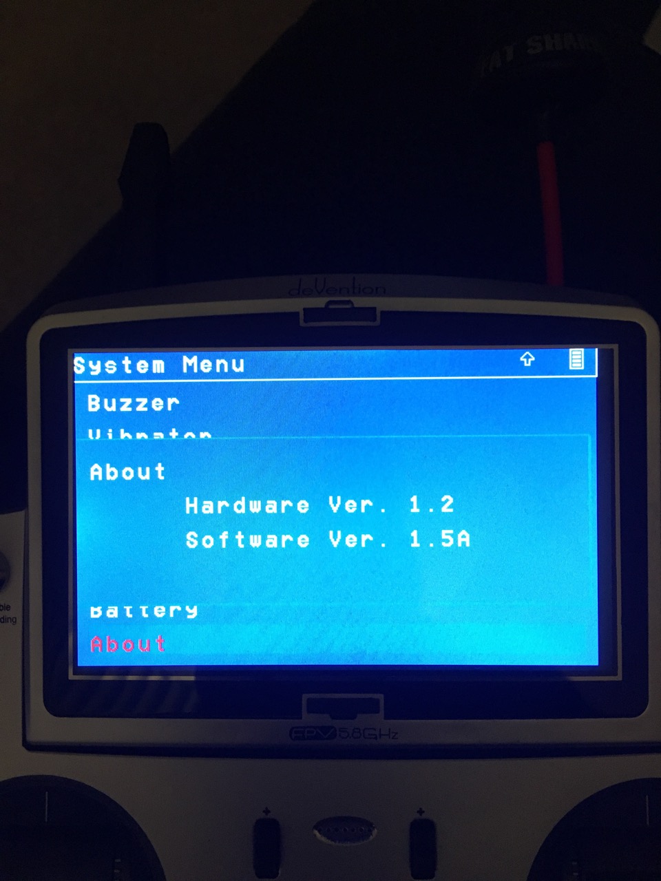

09 Apr 2016 19:23 #46207 by mustgetsomesleep

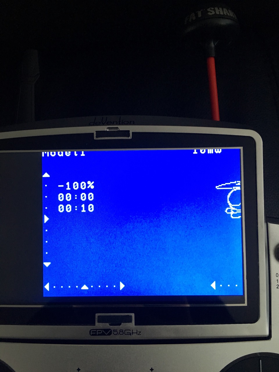

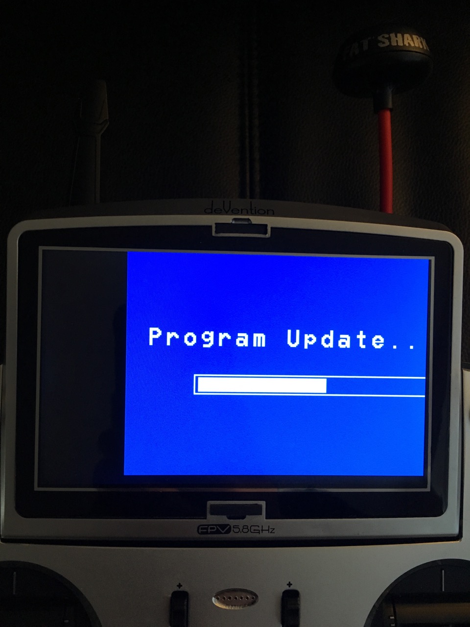

Hear are three pictures of the about screens with the three original firmwares ! i have choose these screens because you can easily see the gaps on the right and bottom on the 1.5a and 1.6a and the 1.3 a has no gap on the right but only the bottom . The remote was originally 1.6a as can be seen in the screen shot i posted a few posts back . Hope this makes sense
09 Apr 2016 19:27 #46209 by PhracturedBlue
Am I missing something? I haven't seen any screenshots you've posted where the screen was actually centered as it is supposed to be
09 Apr 2016 19:32 #46211 by mustgetsomesleep
mustgetsomesleep wrote: Hear are three pictures of the about screens with the three original firmwares ! i have choose these screens because you can easily see the gaps on the right and bottom on the 1.5a and 1.6a and the 1.3 a has no gap on the right but only the bottom . The remote was originally 1.6a as can be seen in the screen shot i posted a few posts back . Hope this makes sense

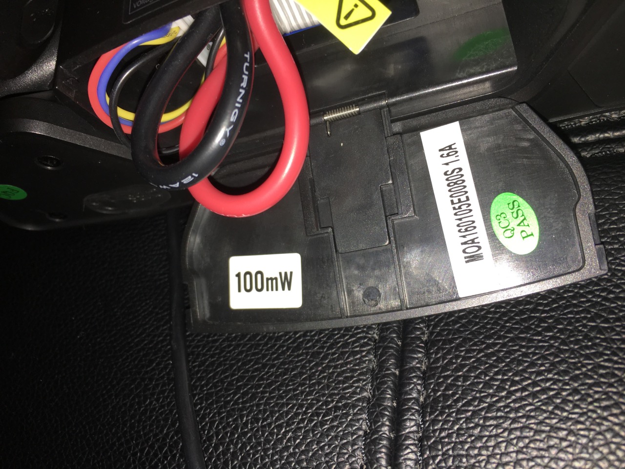

Can i just ask a question you said originally you developed the firmware on a version 1.3a software tx with the version 1.0 hardware ! mine according to the about page is 1.2 hardware ?
