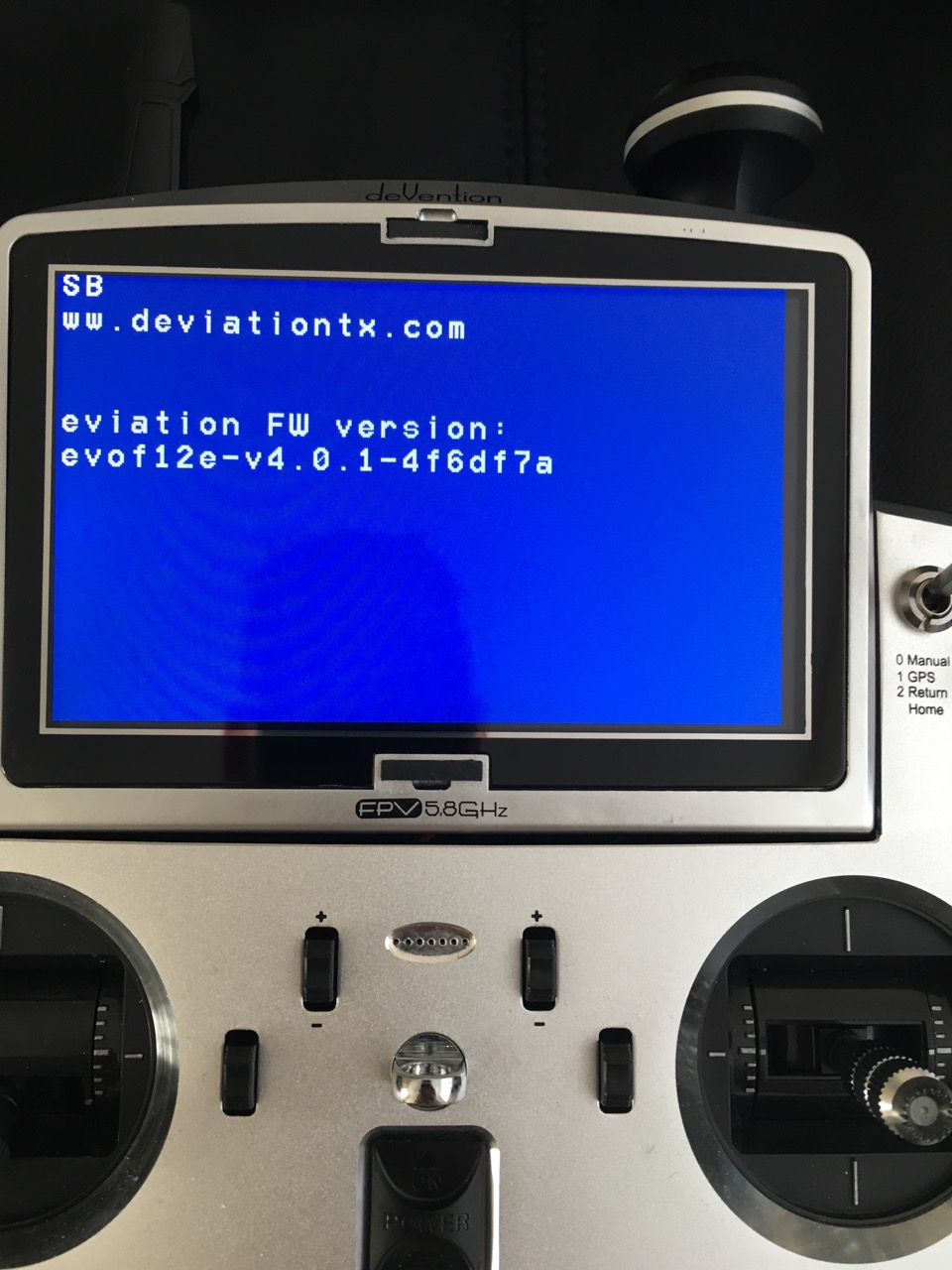

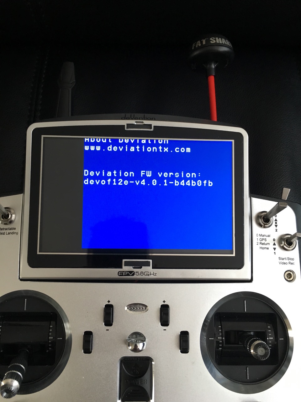

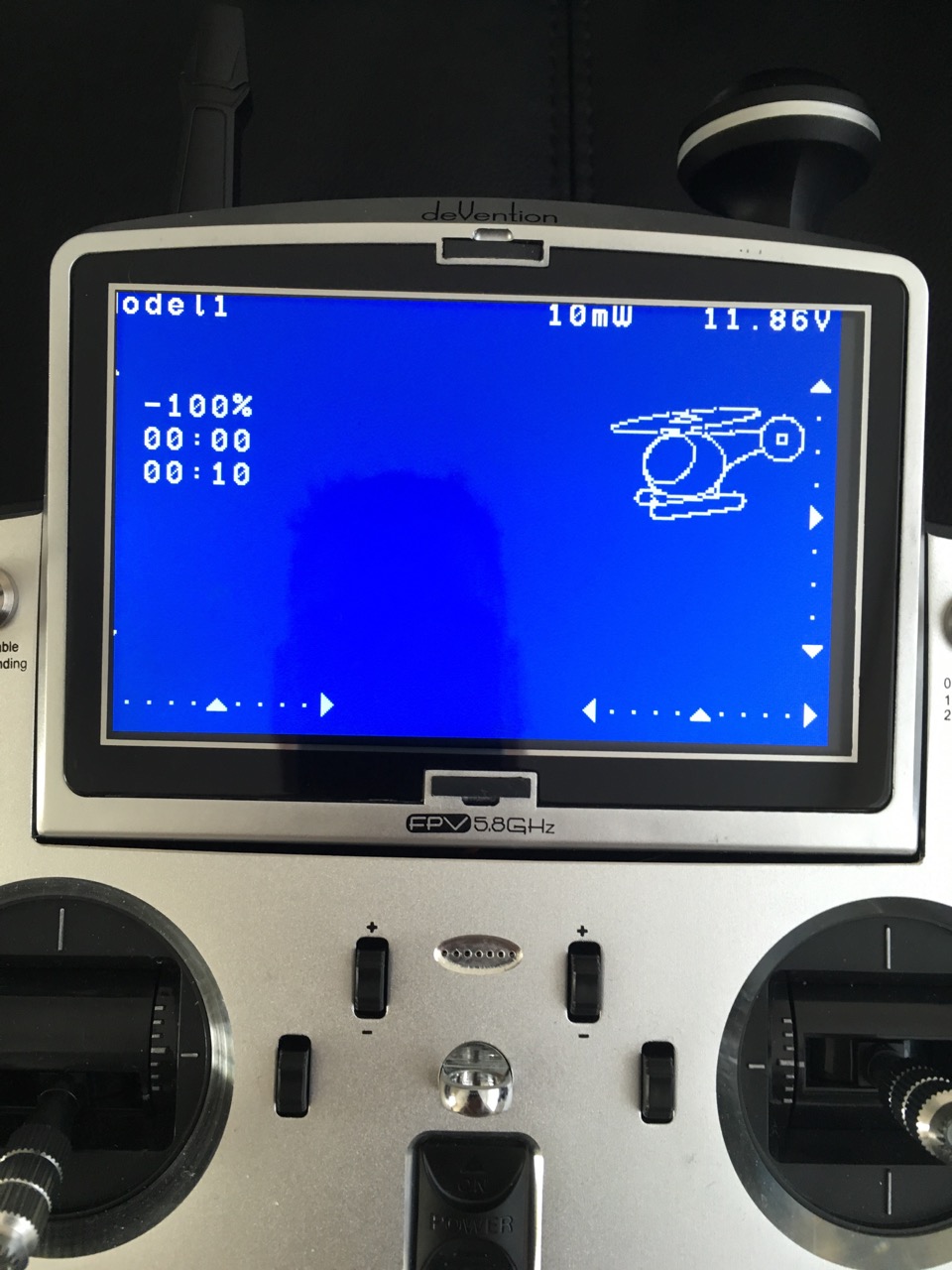

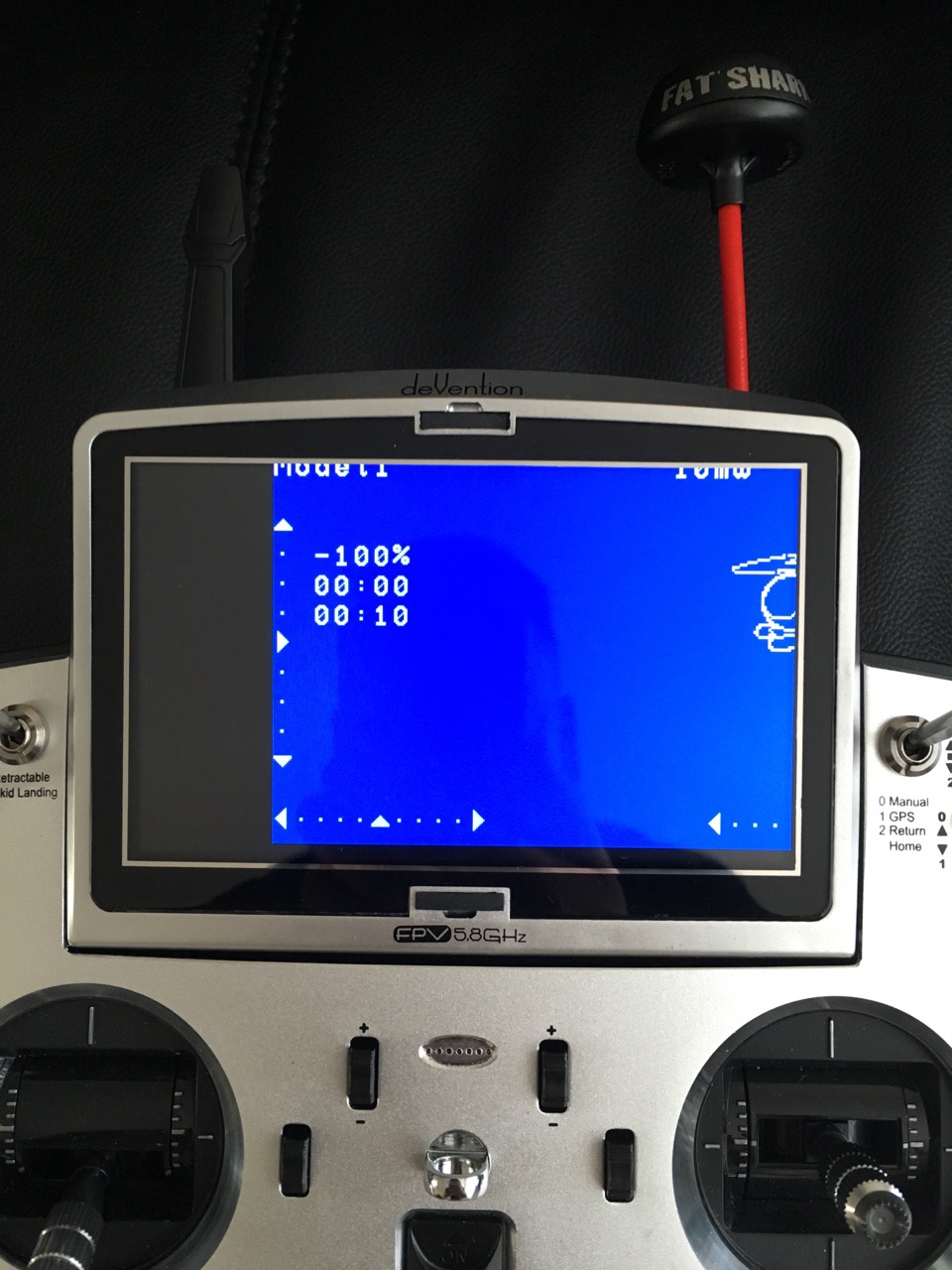

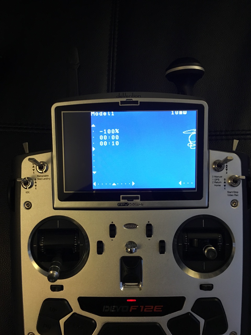

Sorry PhracturedBlue but i was a little hasty with my assumption that this fixed the screen issue . It is not quite 100% correct , the screen appears to be off centre to the left and up leaving a small 5mm gap on the right hand side and about 2mm up from the bottom . As you can see from the pictures this removes the first line of txt on the far left of the screen and slightly obscures the top txt . I have reverted back to test all the standard firmwares and they all work apart from the original 1.3a this is also windowed ! it also now seems the original firmware has the same gaps on the bottom and the right . The strange thing is powering up in program mode the image is ok on the right as can be seen in my original picture . . Sorry i thought you had it there ! i should have had a better look this morning .

This is likely to take a lot of trial and error to fix since I can't duplicate the problem myself.
Can you try this firmware:
www.deviationtx.com/downloads-new/catego...turedblue-f12e-test1
It won't fix the problem, but it should display a debug screen. Take a picture of that screen and send it to me.
You can press the 'EXT' button to continue booting after you've captured the screen

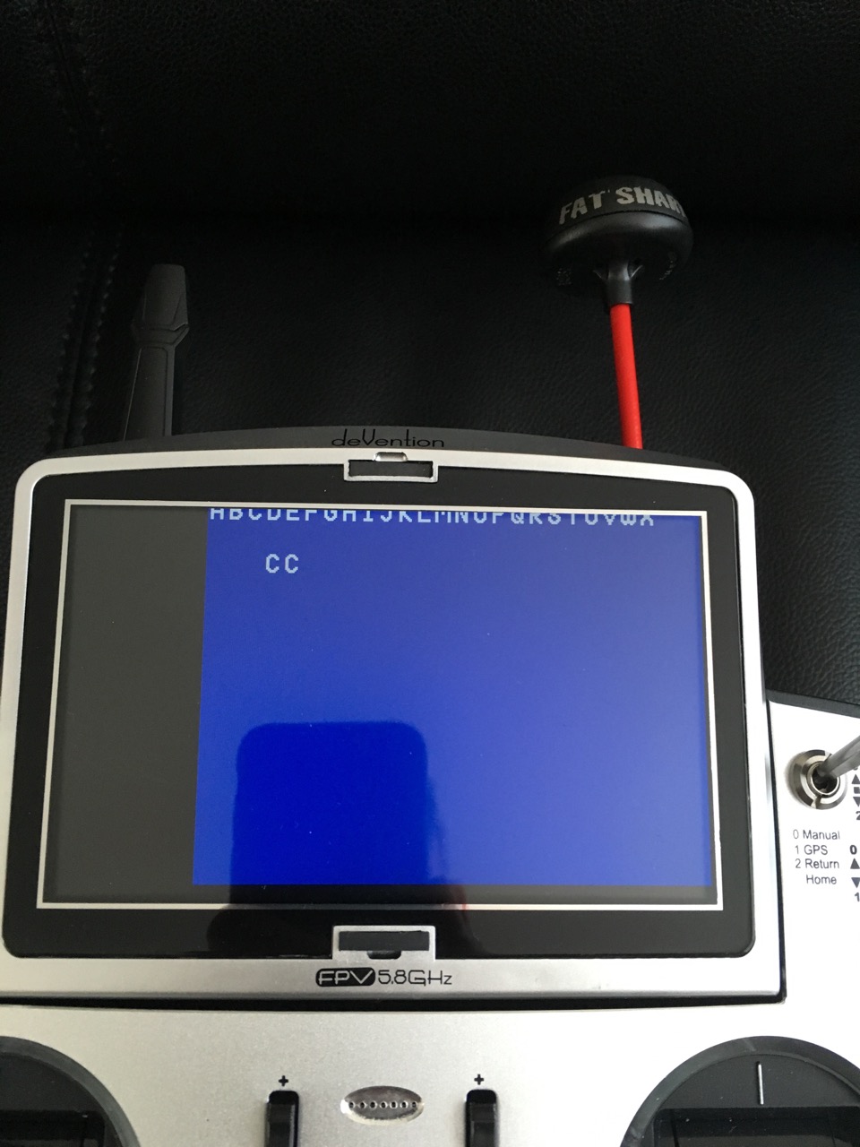

That was helpful I think. Let's try this:
www.deviationtx.com/downloads-new/catego...turedblue-f12e-test3

hmm. does the programming screen look normal (When you boot pressing 'EXT')? I am trying to emulate how that works.

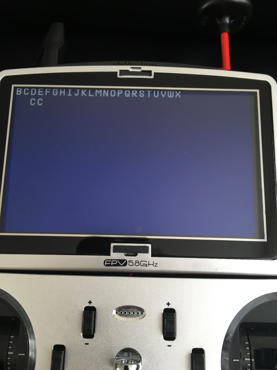

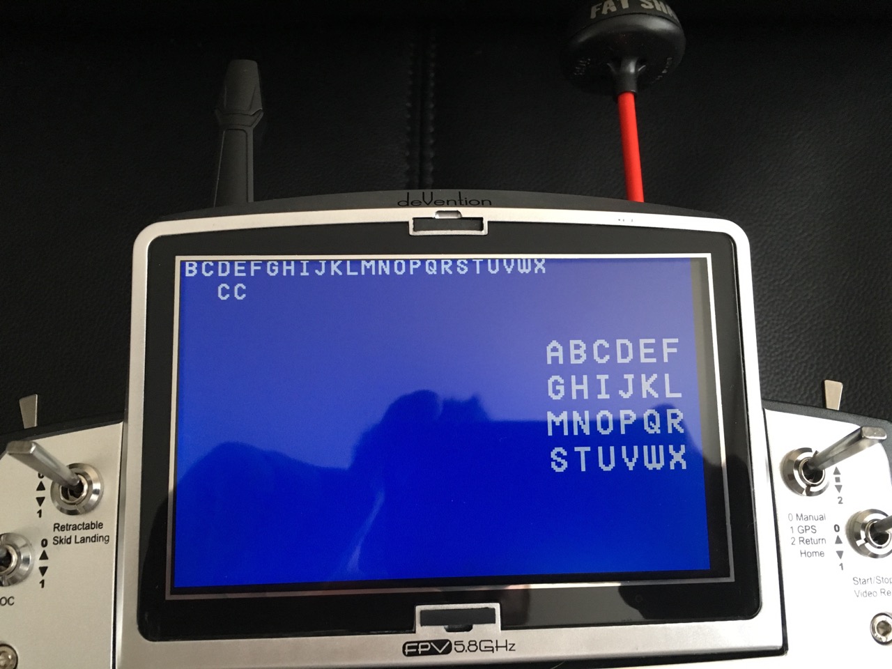

Back to the basics. Try test 4:
www.deviationtx.com/downloads-new/catego...turedblue-f12e-test4
This should show the alphabet in big letters.
