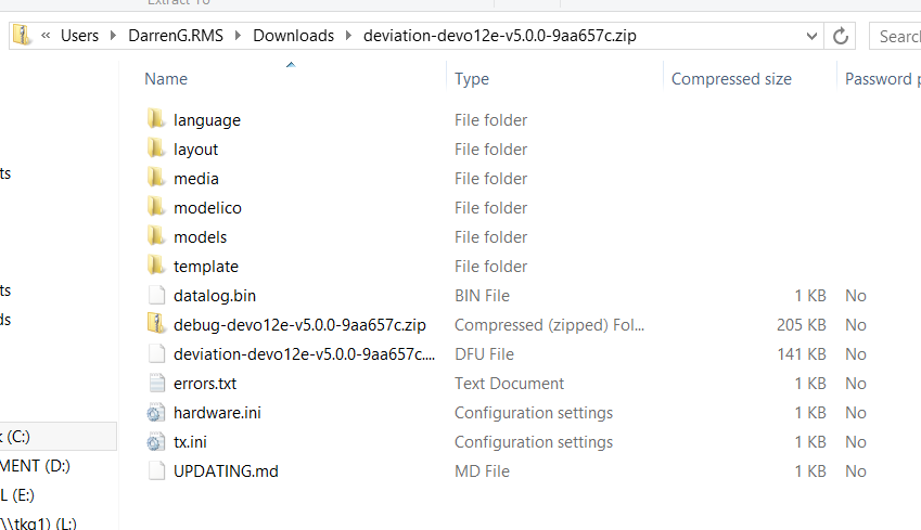

Ok, lets make sure you got the correct build first.
This is the link to the 12e nightly build
deviation-devo12e-v5-0-0-9aa657c-zip
I've extracted this file and can see all the files required present.

Yes that's the version I had but it only had like 3 single files in it. I'm at work right now so I'd have to see what the file names were when I get off. I judged tested again this morning trying to enter DFU and USB mode, neither of them worked. No beep, no screen light.

I just downloaded that file you linked and it has way more files than the one I downloaded. Really odd

I have a feeling that you downloaded F12E which does have far less files.

I could swear that I didn't but it's entirely possibly that I did since I was tired. Would that firmware brick it? If not then I could easily flash the correct version if my receiver would just turn on. I've already checked the voltage conning from the battery pack connector and it is working fine.
