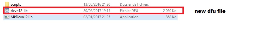

Yes it works, i am under windows10
Your new dfu file is in your disk "E" MK ......

I tried it again and I followed your advice, but I still do not see this .DFU file. Maybe you have another version than mine of the mklib program, I took it here, See photo below.
Can be a track, I do not have the scripts file, where to find it?

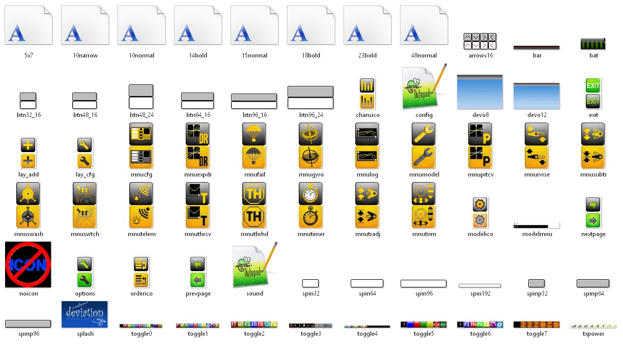

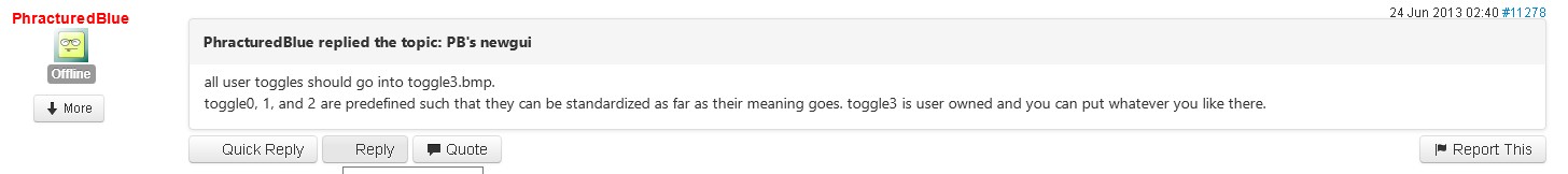

I thinking the Deviation code only supports Toggle3.bmp, not any others. I am sure there was a discussion some years ago over this code. On the larger screens it would sure be nice to have a few more choices.
Here is the thread from a few years back.
I also found that if you have a Toggle3 with more than 63 icons (on my 6s - so probably also other color screens), it displays only the first 63, then wraps back to the first one (on the choices you see more than 63, because you also have the ~30 in the other toggle files).

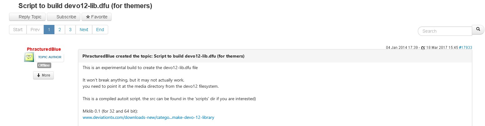

Jejeg I attach the file with my toggles so that you try, because I have different answers you tell me that it works and I would like to know whether or not the files superior to toggle3 work.
Thank you.

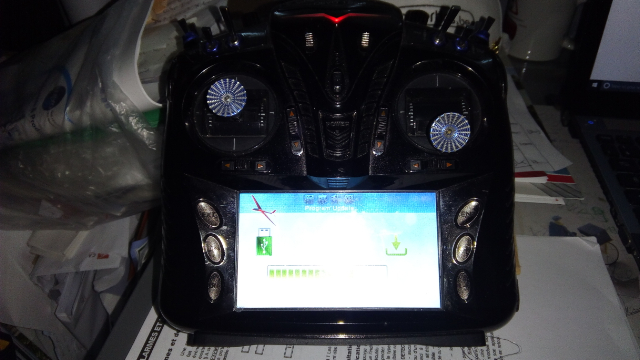

So I put the last nighty version, the library file and created the "mymedia" directory and put the new toggle3 in and everything works perfectly. I do not have the same menu presentations by the green arrows in the top right. Now the screens are much simpler and easier to use because the submenus appear as a list. It's also better with the use of buttons.
A big thank you to Vlad_vy and to all. If someone can tell me what the name of this version is, simply do not put the old one by mistake.
