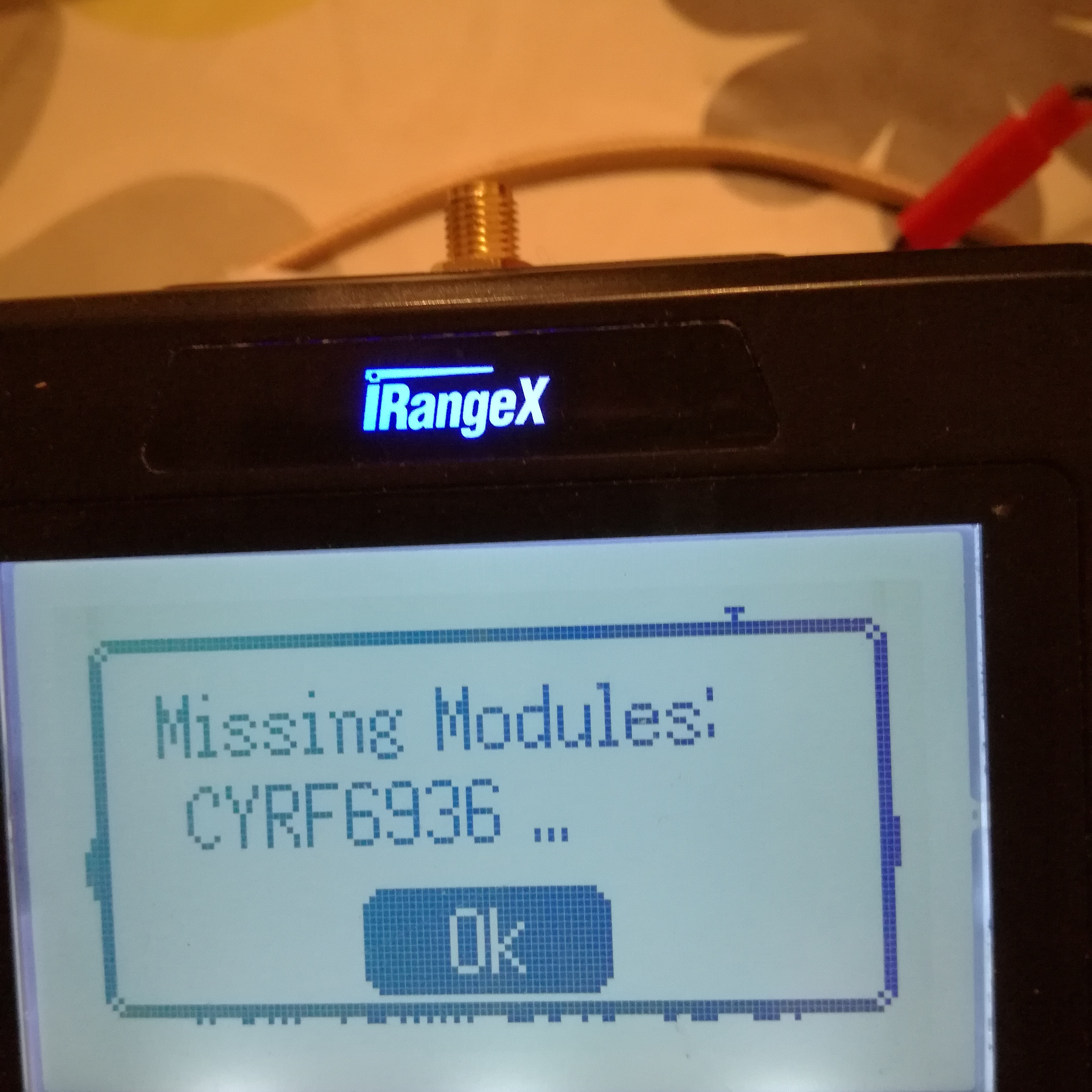

hello
USB screen is lock when switch on ?? J dowload new firmware but same pb ?
anybody idea ?
anybody idea ?
20 Mar 2018 04:16 #68218
Try to use latest build, it has to be fixed.
Replied by vlad_vy on topic IRangeX iRX-IR8M software issue
maxx wrote: Bonjour tout le monde je vien faire la mis à jour et il affiche sa il un solution merci
- totophe63
20 Mar 2018 18:49 #68230
by totophe63
Replied by totophe63 on topic IRangeX iRX-IR8M software issue
which one please ?
21 Mar 2018 04:23 #68233
I see only one:
www.deviationtx.com/forum/builds/7605-ir...uilds?start=40#68208
- totophe63
21 Mar 2018 20:51 #68250
by totophe63
it's Ok ! Thanks
