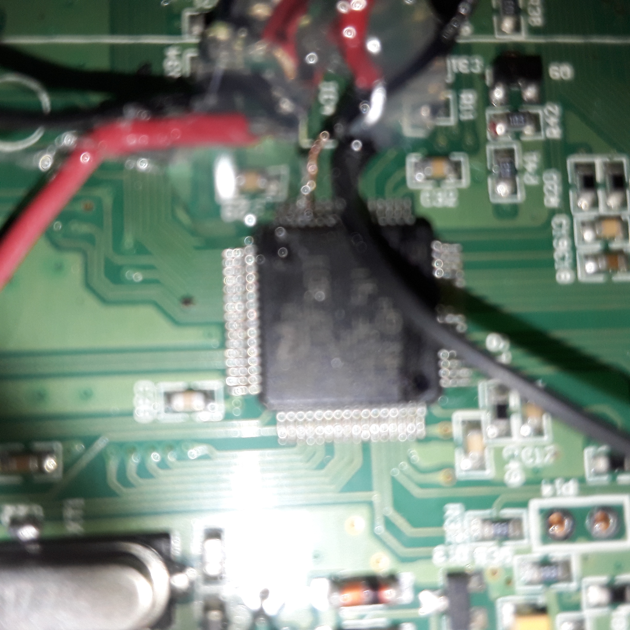

I was able to trace out all of the connections and with the information you provided me I was able to get it to work
Here are some pictures of the F7 connections so you don't have to cross reference things from the f12.
And a picture of the Frankenstein memory mod I have ended up with.

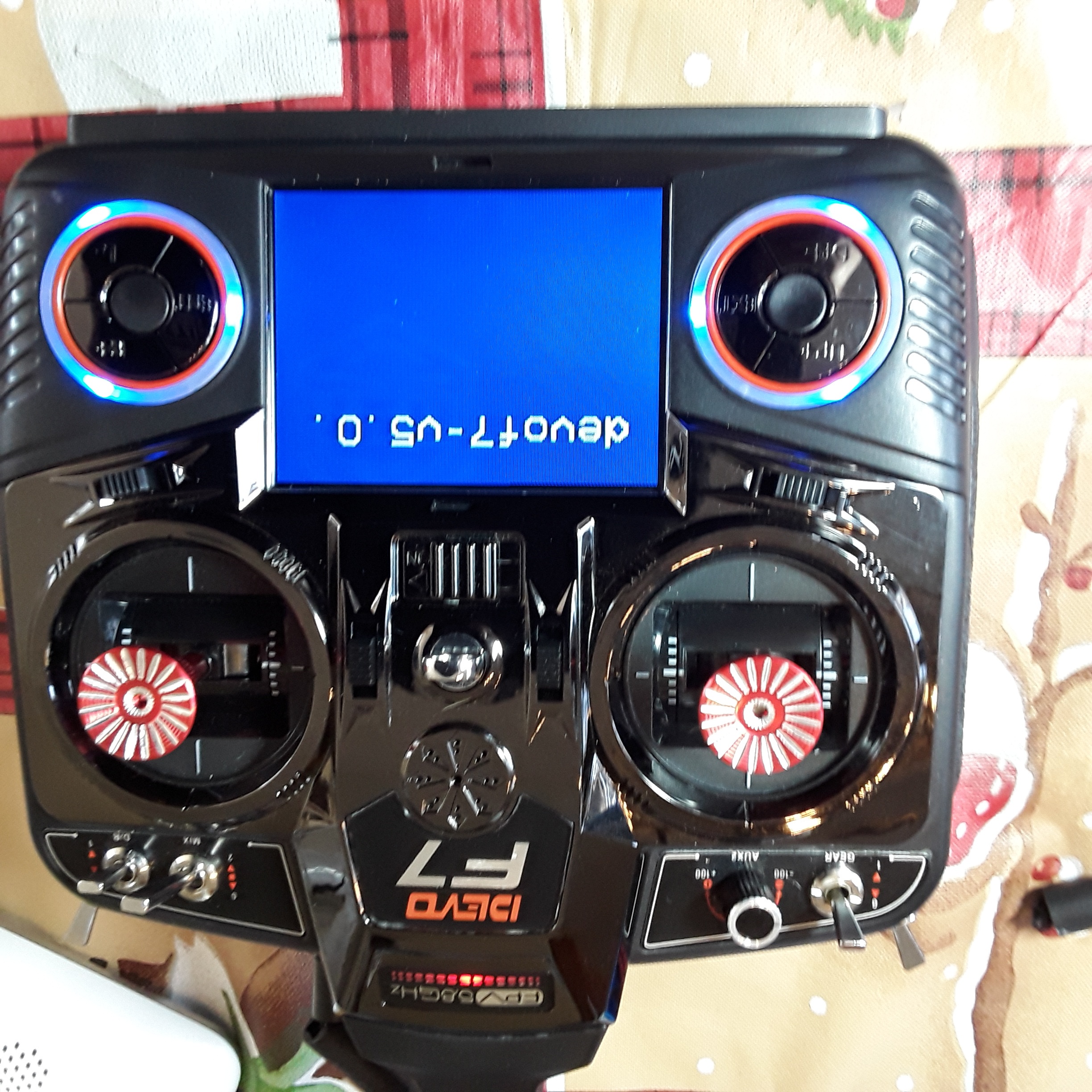

At first after xms mod. I turned it on and the Devo F7 V5.0 screen came up but it only had a 1 line dispay ,and I thought everything was good it would shut right off with the switch and turn on with the switch, and it would go into USB mode when I turn it on with the ENT button down, but then...
I tried to reload my settings and stuff with the build fs tool in CMD and it seemed to go fine but now I only get a dim Deviation USB screen no matter how I turn it on.
I think all my chip connections are good or the first DEVO F7 V 5.0 screen would never come up, would it?
I just can't get the deviation uploader to recognize and show my radio is plugged in, the computer chimes and shows the fs file on the f:\ drive of the computer.... Frustrating after thinking I had it solved

After flash memory mod you need to flash devof7-XMS firmware and simply copy filesystem from firmware archive to transmitter USB drive.

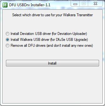

I tried driver installer 1.0 and 1.1 I tried deviation uploader 0.7 and 0.8 It wont show my radio , like i said the computer chimes and shows the f:\ drive connected just nothing linking to the deviation uploader , I tried on 2 different windows 10 computers now, so im stuck!
I double and triple checked all of the memory chip connections and they all link to the main chip with continuity on each pin that corresponds so i think thats good.

Try to flash with Walkera DfuSe Upgrade Tool v2.31.

I forgot to mention that I also have tried to use the Walkera Defuse upgrade tool and it does the same thing, it just won't recognize the F7, I can't get it to connect.

You mess it up with driver installer, I done it to, but I managed to get it working again.
Run the driver installer again and select Walkera USB driver and restart the computer!
After this it should work.

Nope I tried it on 2 computers and it won't work
