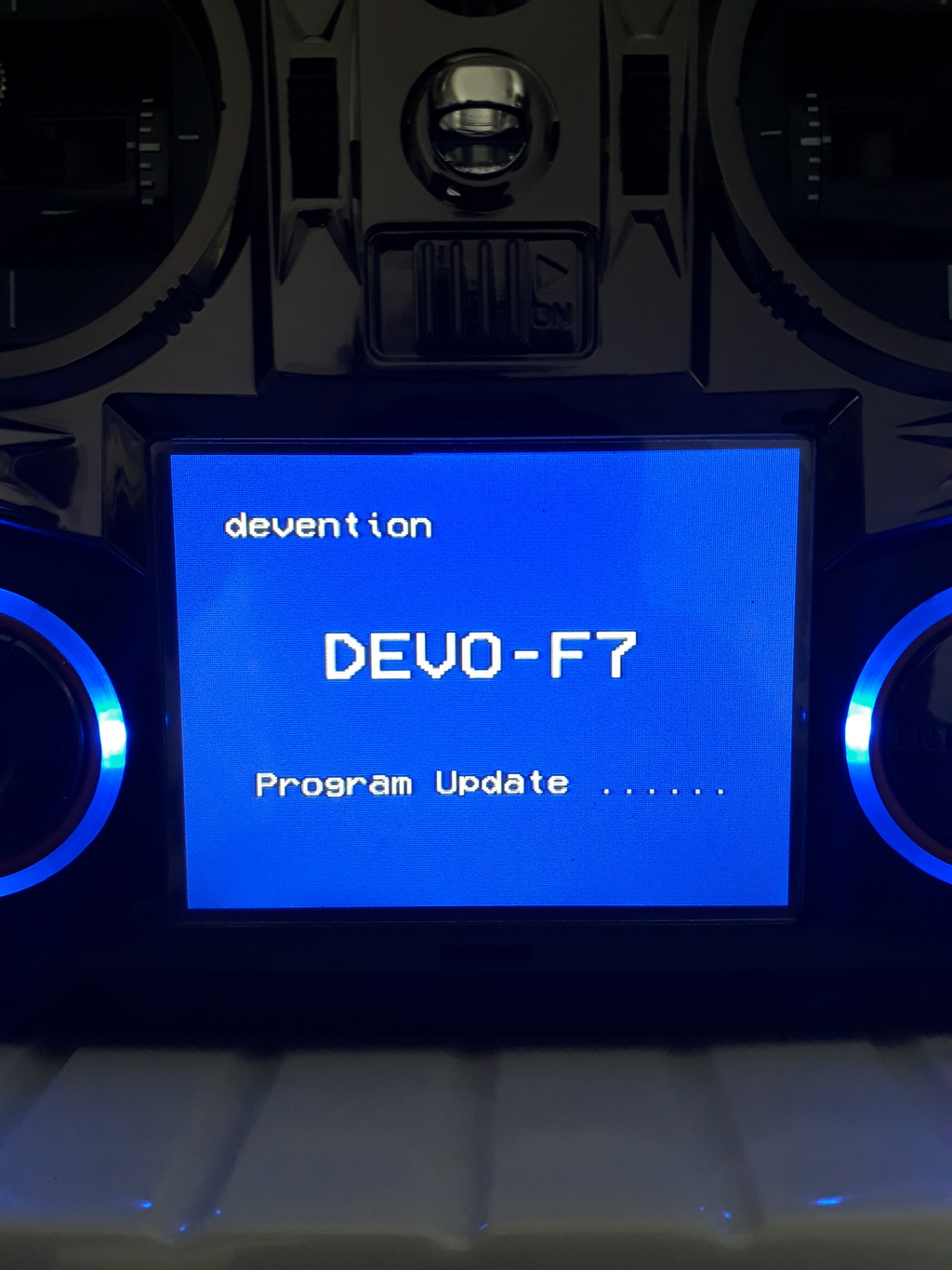

Are u using DfuSe USB upgrade tool?
When u connect the transmitter in EXT + ON does it say DEVO-F7 program update?
does the pc find
does the pc find

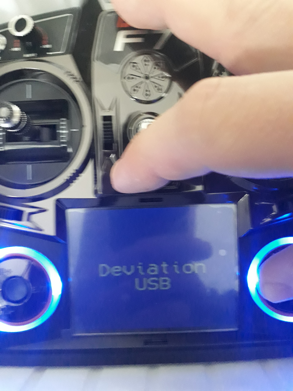

No just a blank blue screen, but this time I just reassembled it and when I turn it on I got the deviation version 5.0 screen and the strange one line menu. I played in the menu for a minute and shut it off, and then when I turned it on I am back to only getting the dimm Deviation usb screen.?? Weird

Hook it up to a computer, you should se a usb flash drive? If so, format it and copy files to it.
Devo F7 XMS + 4in1 module

I think the XMS mod was successful, but because the new chip is blank the devo goes into usb mode because the files it need to run are missing...

on EXT+ON you get this screen?
on ENT+ON?
If so, probably I could help you with drivers via remote connection...
on ENT+ON?

EXT and on and I get a blue screen but it's blank nothing like what you show, it's the same bright blue but it's just blank.
