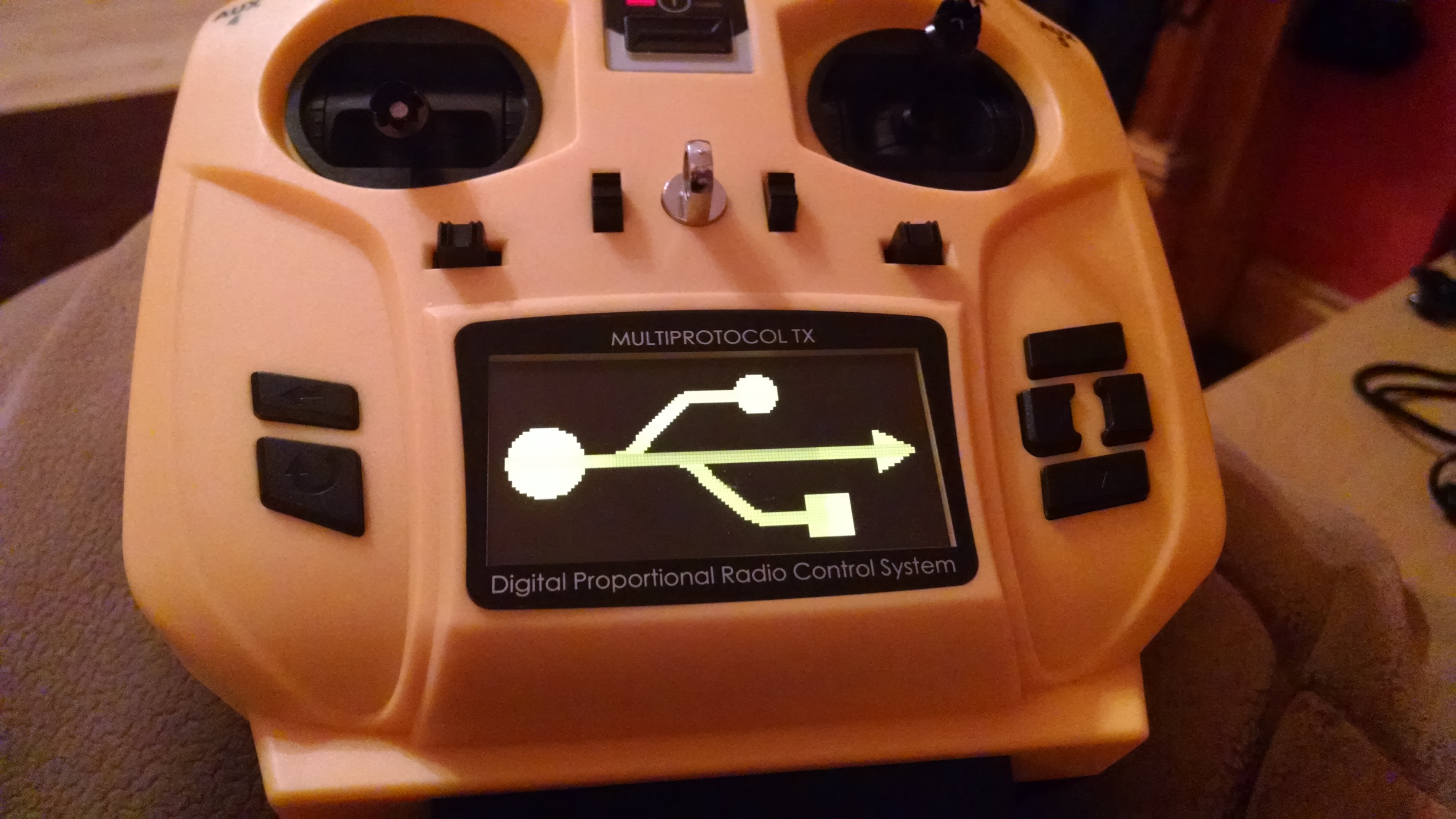

Hi can i ask you how did you successfully flash your Jumper??I can not get it to work at all,,Brand new radio arrived stuck in usb mode..Thank you
04 Aug 2018 00:34 #70077
Replied by hexfet on topic Jumper T8SG
The d90cb3b build is the latest nightly and contains all supported protocols. The Hubsan protocol only has three format options. All the 18 supported models use one of those three formats.
If the tx always powers on to usb mode try powering on with EXT pressed. If it enters program mode, follow the standard install directions to load deviation and the filesystem. If it still goes to usb mode it could be a bad switch.
