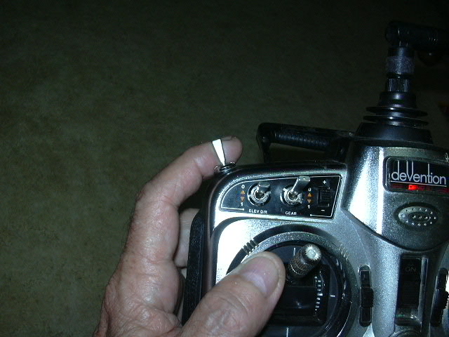

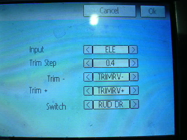

Here is what I do.
I am using a devo8.
I use rudder dual rate switch for launch.
RUD DR0 is for launching, my presets for elevator rudder and aileron
RUD DR1 is for normal flying
So when dlg has rotated to vertical i switch from rud dr0 to RUD DR1
If you go to your trim setup page you will see that you can select a switch for each function ele ail and rud, mine are all set to RUD DR. You choose which ever switch you use for launch (your hold switch). This will save a trim value when switch is set one way and a different value when that same switch is set the other way.
Try it works great and i think is what you want.
Also you may want to increase step value to around 4
Hope this is clear and you understand. Will post some pics if you need it.

So in my case when switch is in rud dr0 (launch mode) elevator trim buttons are used for launch trim. When switch is in rud dr1 (normal flight mode) i use elevator trim buttons as normal to make dlg fly straight. Both settings are saved.
2 different values on one switch and using your normal elevator trim buttons. Exactly like you asked for. No more having to go in and change mixers.
In fact no mixing at all required.
Last edit: 16 Aug 2018 08:51 by Hoodooguru.

16 Aug 2018 19:23 #70291
by KArlk.
Replied by KArlk. on topic Mixing questions for DLG
That's exactly what I was looking for! It didn't cross my mind to check the "trim" menu. Thanks a lot!
