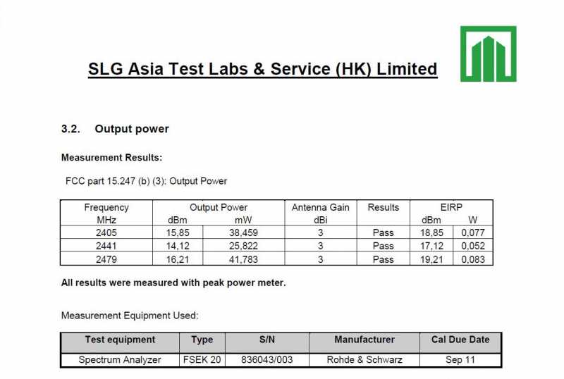

Hexperience wrote: By the way, the devo8 comes with a 2db and the devo12 is a 5db right?
They almost equal in gain.
Devo 8s FCC test (antenna gain <3dBi)
Devo 12 FCC test (antenna gain =3 dBi)
By the way, no one Tx don't use antenna with gain over 3dBi. Typically antenna gain is about 2 dBi.
Last edit: 05 Jul 2013 04:57 by vlad_vy.

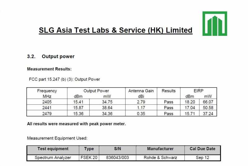

05 Jul 2013 12:48 - 05 Jul 2013 12:55 #11943 by RandMental
Replied by RandMental on topic High gain antenna
Hi Vlad
I am suspect of the nice clean "3dBi" statement of the 12s in these tests over the 2.4GHz band, compare this to the different gains of the Devo8s antenna over the 2.4GHz band.
As you clearly understand RF and antennas, you will agree the higher the gain figure of an antenna of the same size / configuration, the narrower the gain pattern AND the gain bandwidth.
So my guess is these 3dBi figures on the 12s test sheet are the theoretical figures, and they forgot to update it after the tests as they did for the Devo8.
Edit: if these antenna figures are indeed true, I would agree that one should replace the Devo8 antenna with a Devo12 antenna, as the Devo8 emitted power drops to 54% at the top for the band (2.479GHz).
Last edit: 05 Jul 2013 12:55 by RandMental.

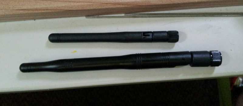

06 Jul 2013 17:02 #12016 by Hexperience
Replied by Hexperience on topic High gain antenna
vlad_vy wrote: Possible both antennas, Devo 8s and Devo 12s are the same, I don't see any visual difference between them.
This is what came with my devo 8 and 12 so I assume they are the same internally

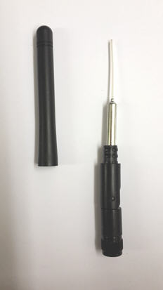

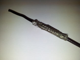

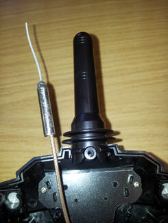

06 Jul 2013 18:14 - 06 Jul 2013 18:31 #12019 by RandMental
Hex,
Interestingly your 12S antenna looks like the ones I received with both my 8s Devos. I added two external antennas (like the smaller one on you photo) for the XL7105 and CC2500 modules. By switching the longer and shorter antennas around I do notice a lower output from the smaller antenna, my guess is not even 2dBm.
Here a few other antenna samples, the first is the short antenna taken apart, as expected it is a normal dipole configuration:
The Devo7e standard antenna:
Home build version for a 7105 module placed inside the Devo7e using RG74 coax cable:
Last edit: 06 Jul 2013 18:31 by RandMental.
