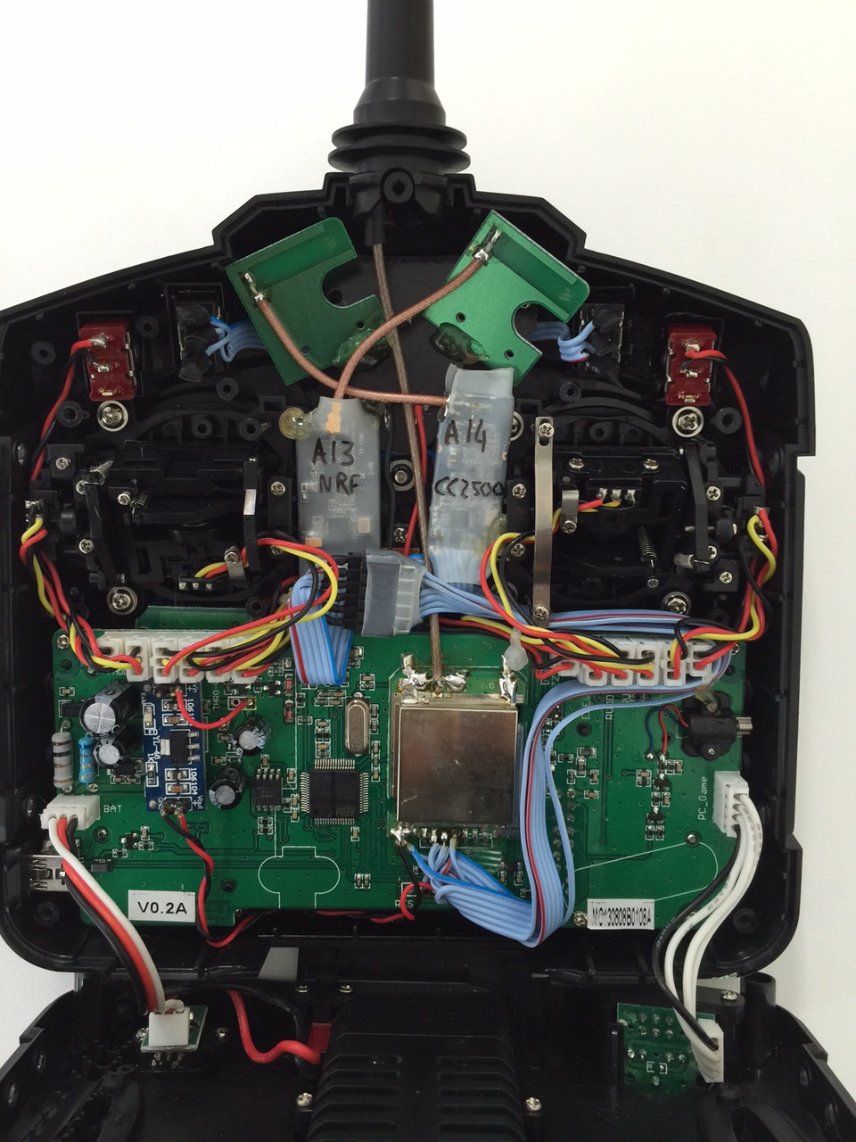

What Do you think of my installation?
-Minimize coax connections = loss mismatch at 2.4Ghz
-Horizontal Antenna, as tx normally points towards model
-J-Pole antenna, good wideband behaviour and match to 50Ohm
-Inside Tx but, the radiated side of each antenaa kept away from any metal or other antenna.
(do not put two antenna close or in the same tube etc)
I did some measurements on radiated power using a 50uV meter and rf diode, I find that the output power is very much different for different protocols.
Also the adjustment step in output power does not seem always changing output power same.

What kind of range are you getting out of them? Have you range tested them?

Have no problems with range. NRF modules often use a folded type of Pcb J-Pole, but don't know many pcb with real J-pole. The gain of Jpole is maybe slight more more than standard omni and are pretty wideband.
This is the one I use, but I Replace the Coax, as the supplied with the module is not good.
www.dx.com/p/repair-parts-replacement-in...i-32562#.VgFK6svosy8
Maybe someone can measure it? For me they work fine!
