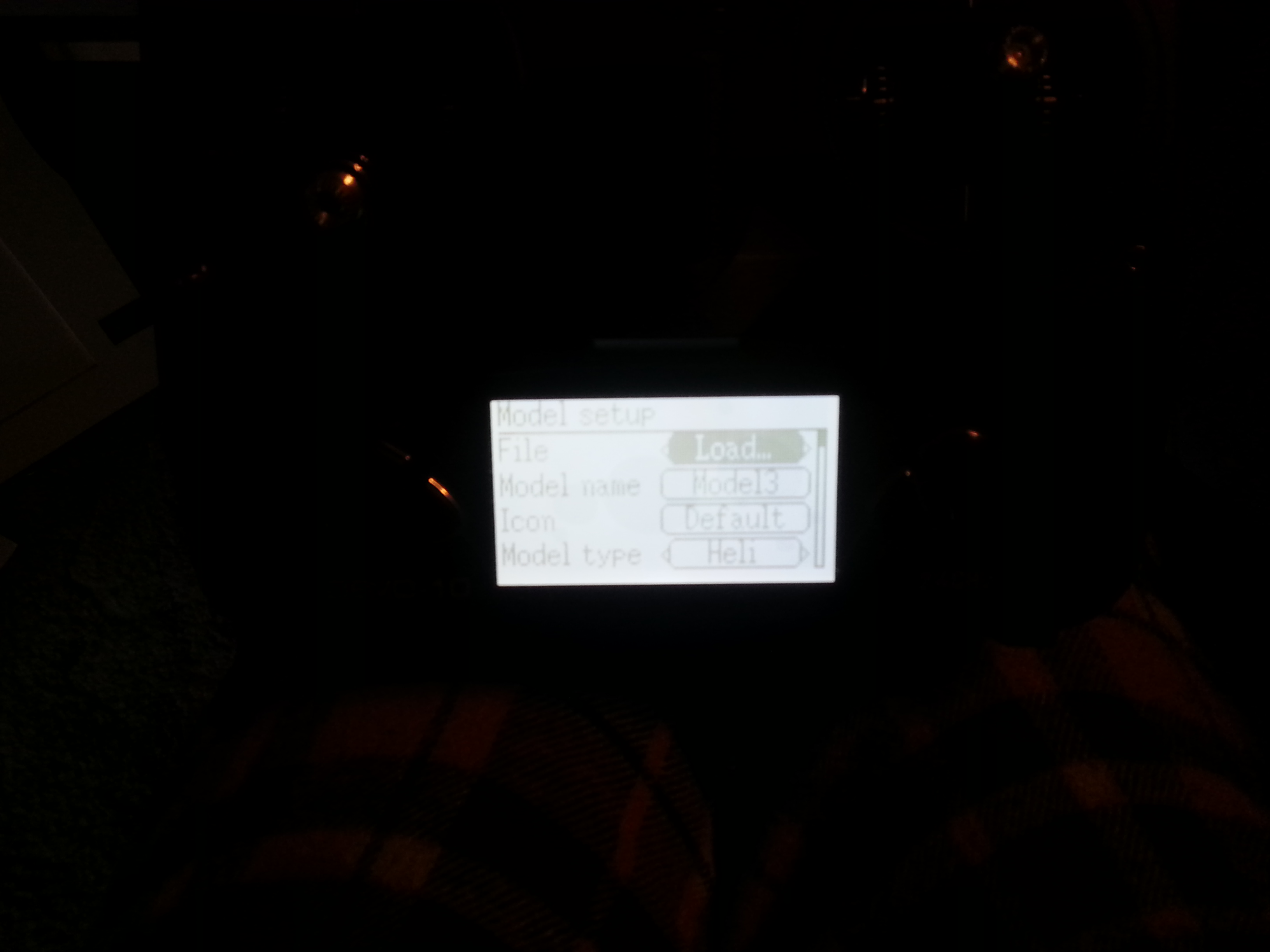

I will try and explain my situation better.
Brand new DEVO 10. Never used prior.
I have Dfuse usb tool on desktop
I have Devo 10 v4.0.1 zip on desktop
I have copy of models on desktop
when I power up Tx it shows Deviation FW Version devo10-v4.0.1
Model menu, enter, model set up, enter, load, enter, I have just one model to chose from should I have all the model configurations that are on the desktop here?
When i power up Tx plugged into computer and hold down ent, windows ask about what to do with files, I open/veiw and model files are there.
When I open the usb dfuse tool it shows nothing at th bottom ie no Tx. All help would be graet, looking for basic directions on just getting this one super cp in the air with the beginner settings. Thanks.
