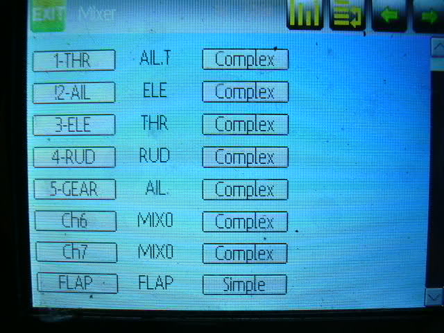

Eg
In pic below there are no switches showing on right hand side of page, there should be?
When i reorder a channel the column on left should change to suit? If so this does not happen?
The tx servos work and follow mixers etc, just seems like some of the screens are not working correctly.

That is the strangest setup that I have ever seen, that may be the reason for the lack of response...

What mode are you using normally, and which one is set up on the TX?

Mode2 and mode2 which is default.
It is not setup. A fresh unused model page has same issues.

What protocol are you using, i.e DSM2?

The reason I ask, if the TX is set to mode 2 and you're using the right protocol, there would be no reason to move throttle to another canal...

Hi Birdman.
I use the Devo 8S on 4 heli's.
Not sure whats going on but I would like more info.
Why are you moving the channel? And which protocol are you trying to run? What model are you trying to set up? ( plane? Heli? )

Replied by FDR on topic Devo 8s users please.
The channel names won't change when you move the channels, only their content will move.
Channel names are determined by the protocol...
Don't use the nightly build if you don't trust it: that is the version under development.
Use the v4.0.1, it's quite stable...

You could be on to something there. Protocol is DSM2 rx is Spectrum AR7000. But the rx is seeing aileron as ch1, ele2 thr3 rud4. JR Spectrum thr is ch1. It is the tx that determines ch order.
Is tx sending wrong ch order, if so why?

Blayd and Sero is on to it. I feel very much like a dumb ass. Been at it for days and did not pick up on that. When you select DSM2 you have to reorder channels to suit.
