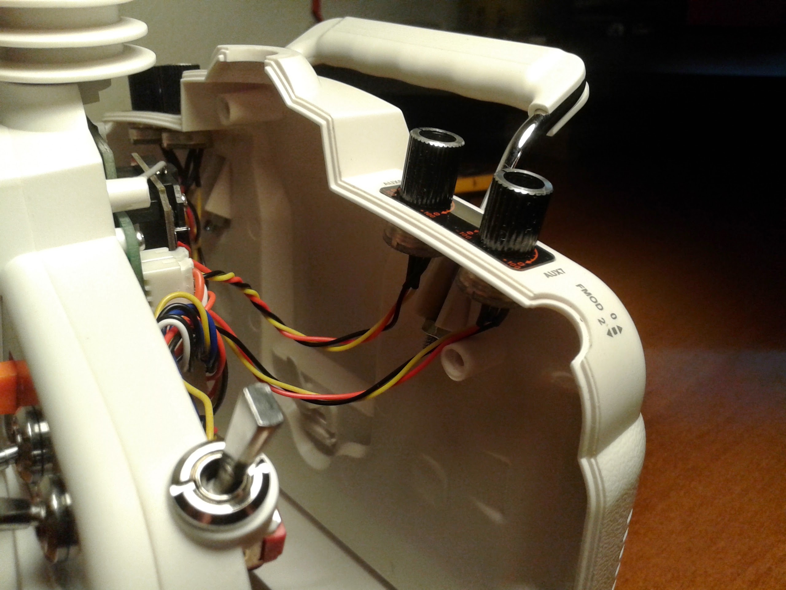

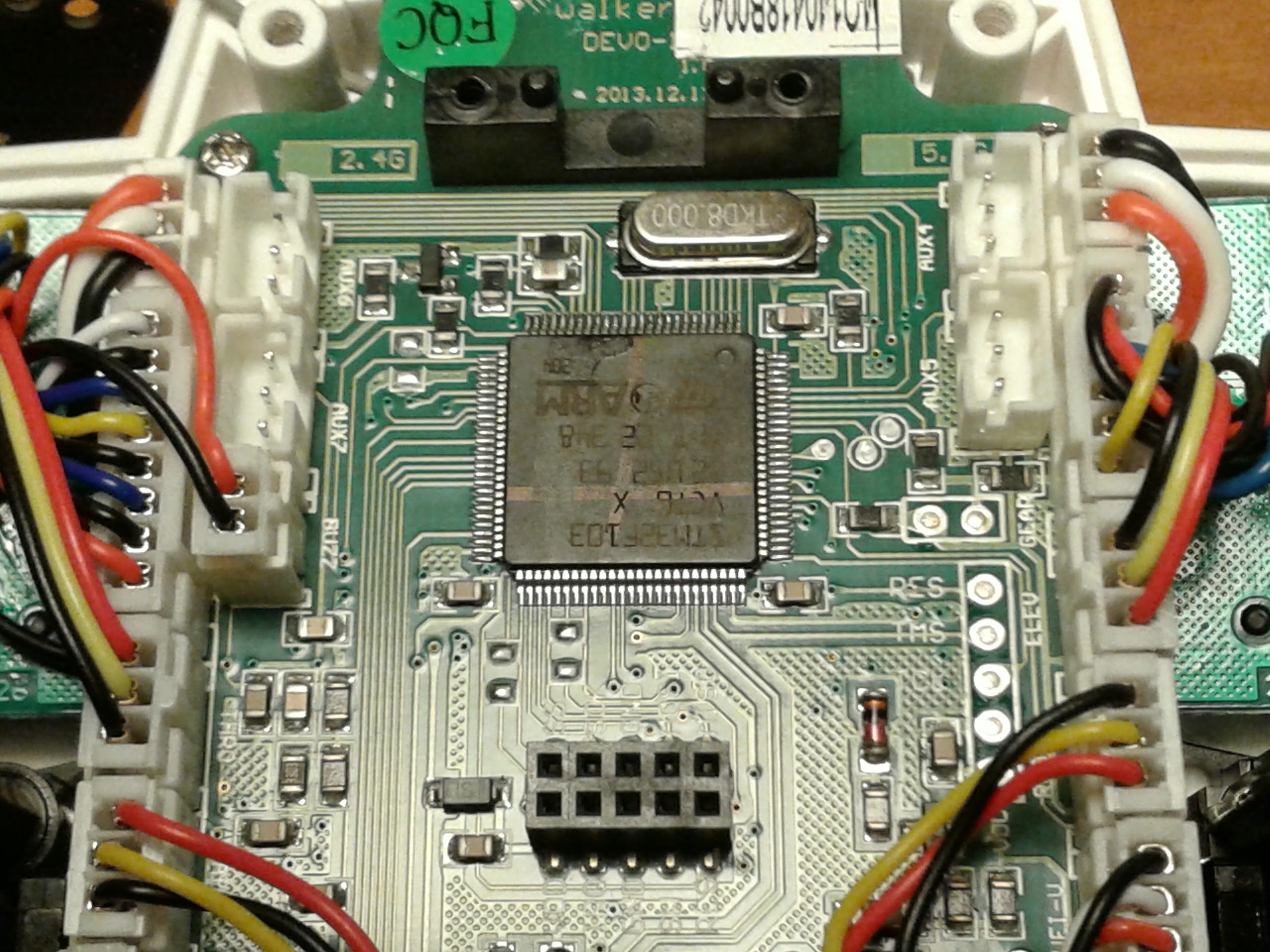

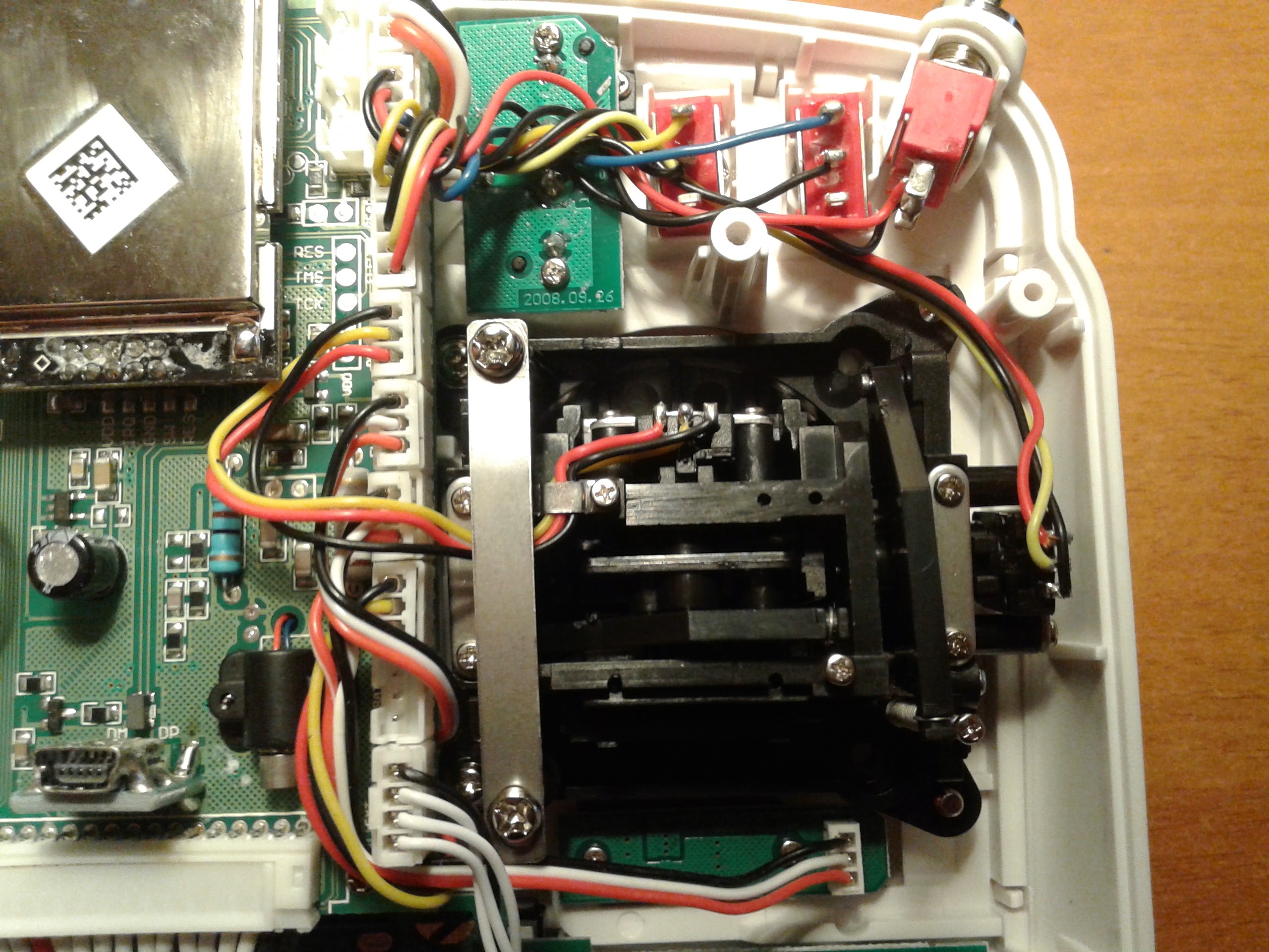

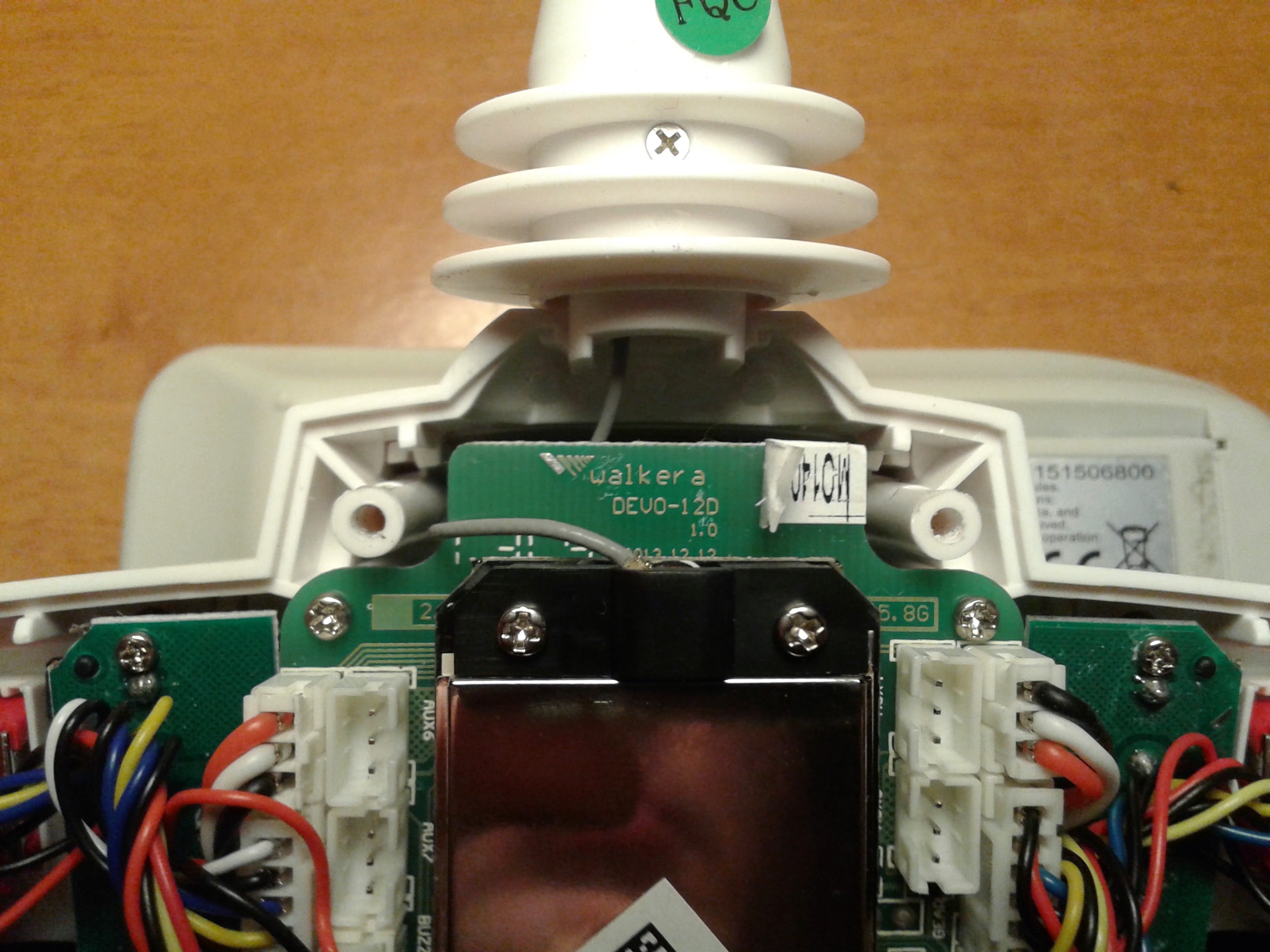

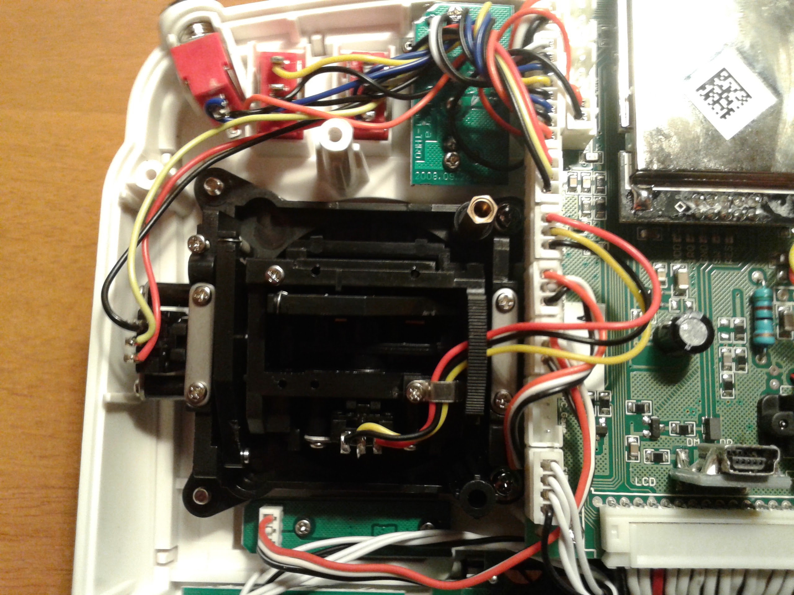

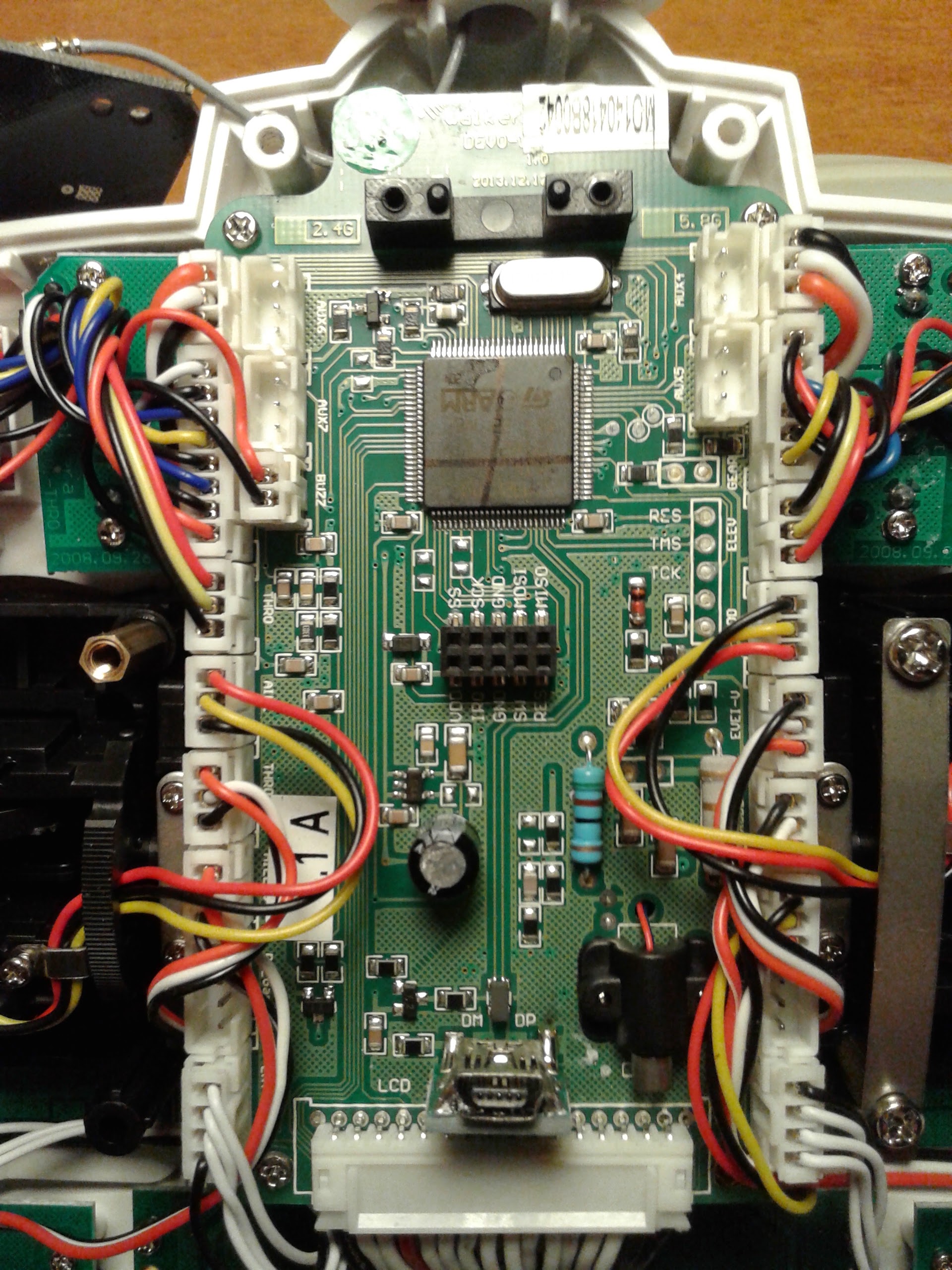

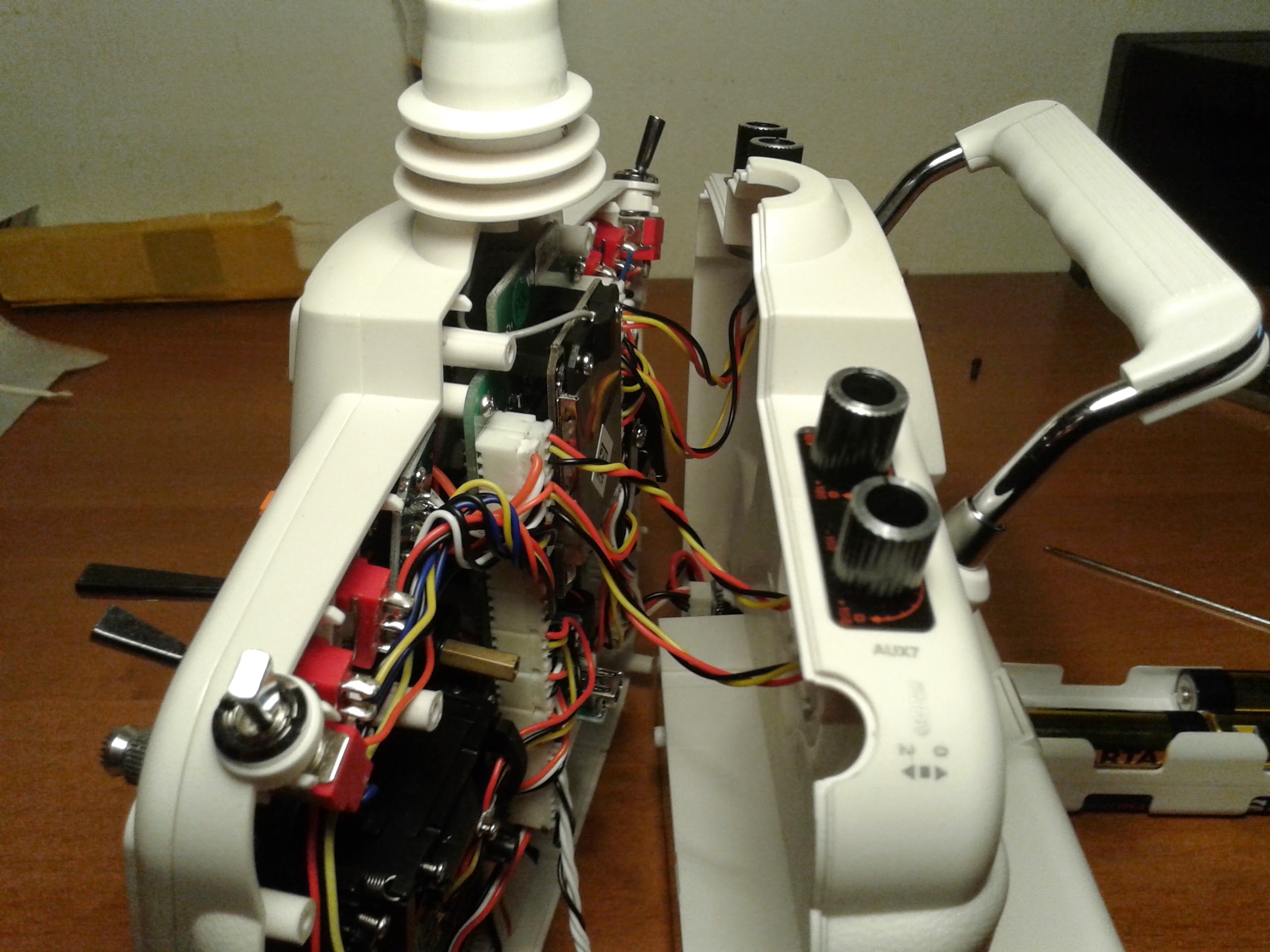

18 Dec 2014 21:39 #27086 by kreidler
Replied by kreidler on topic DEVO 12E
Oswald,

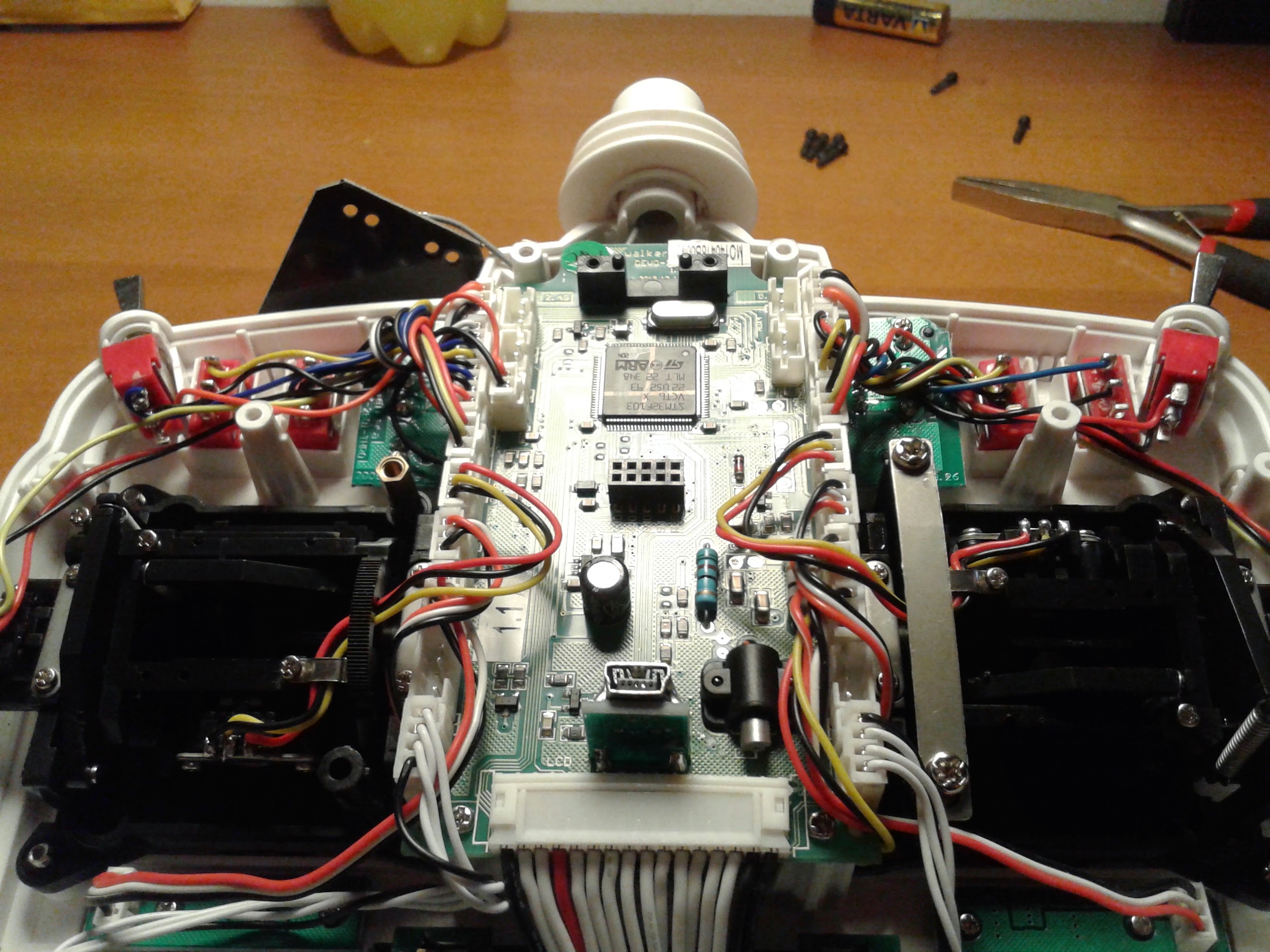

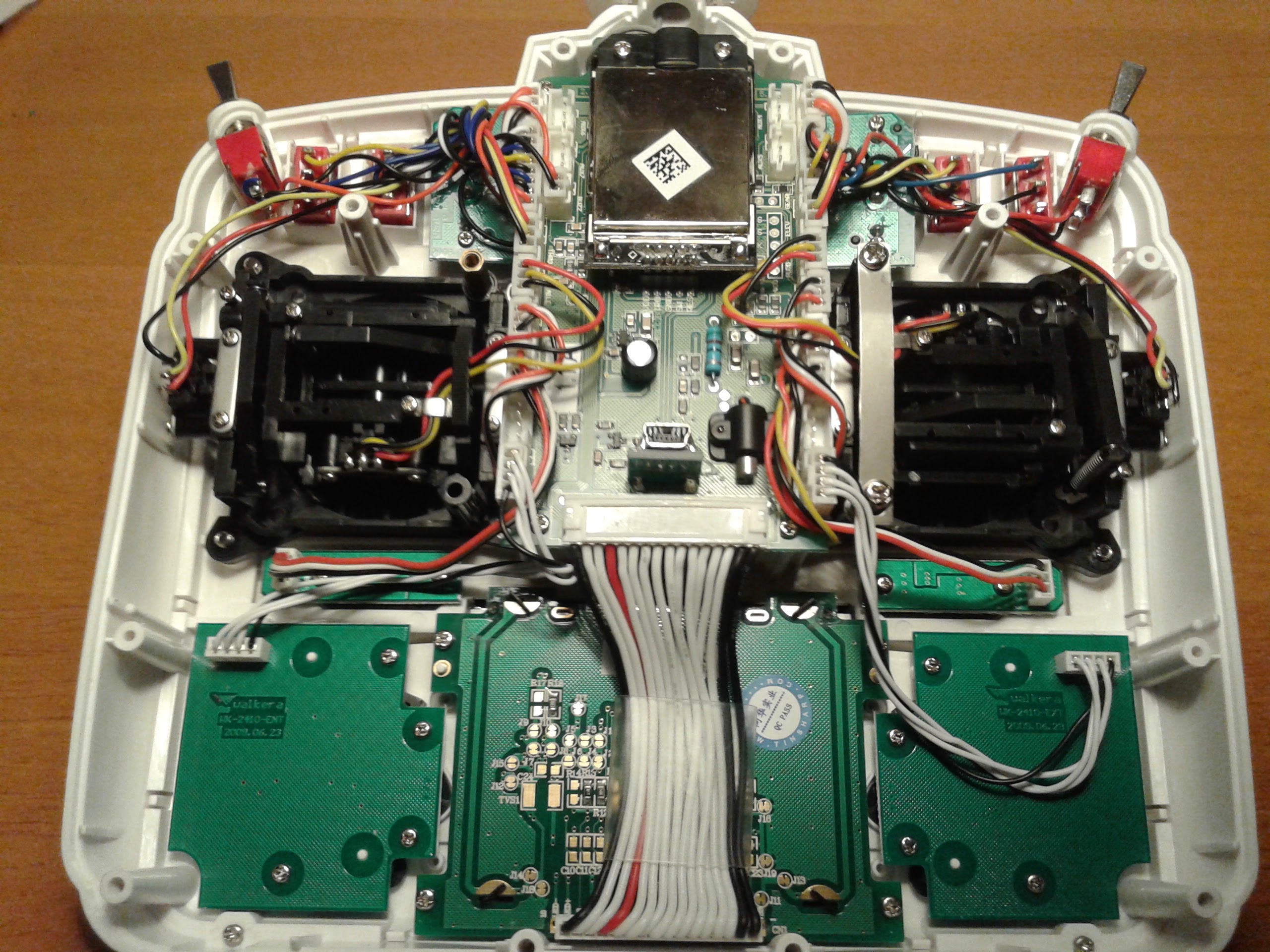

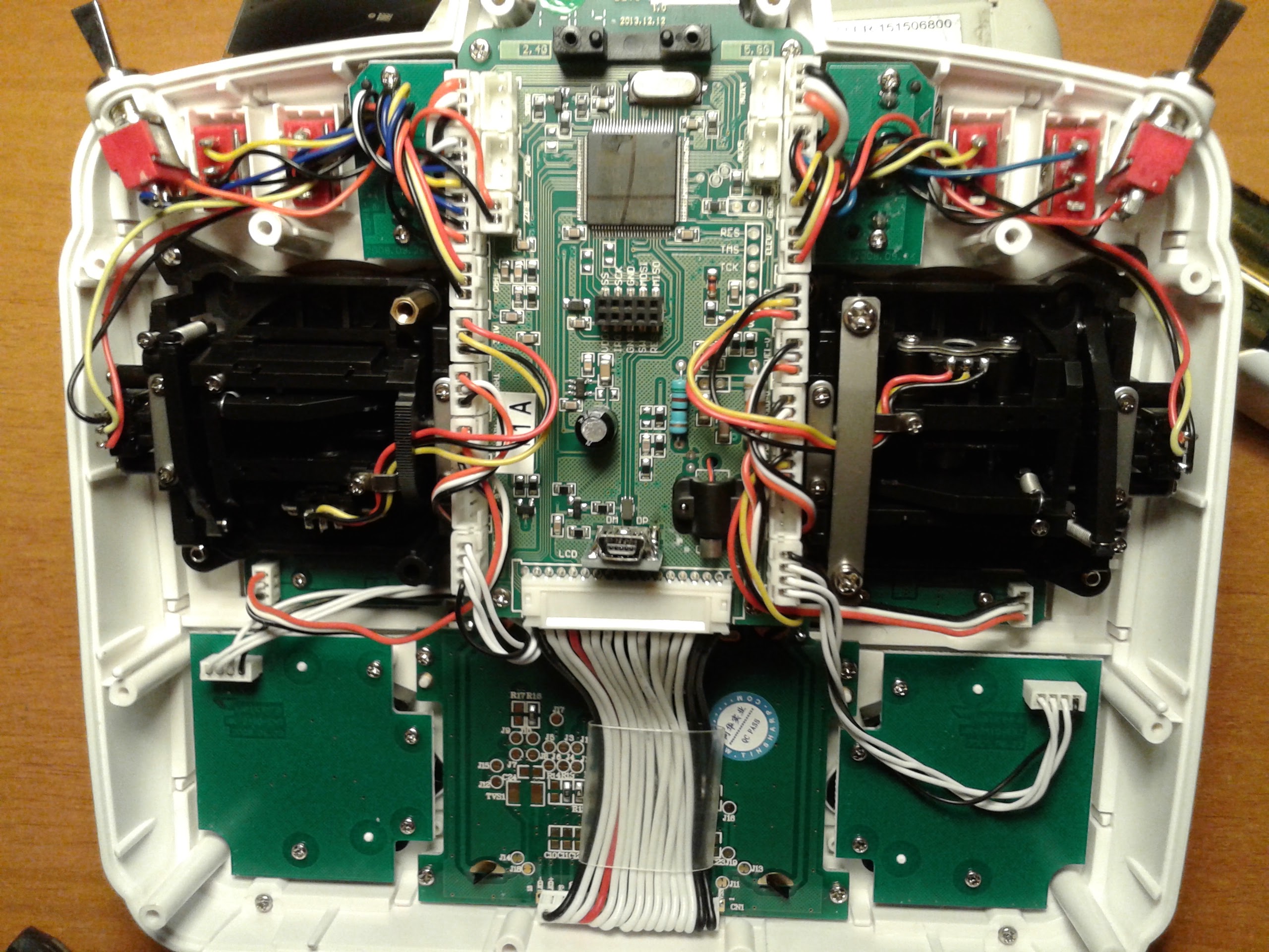

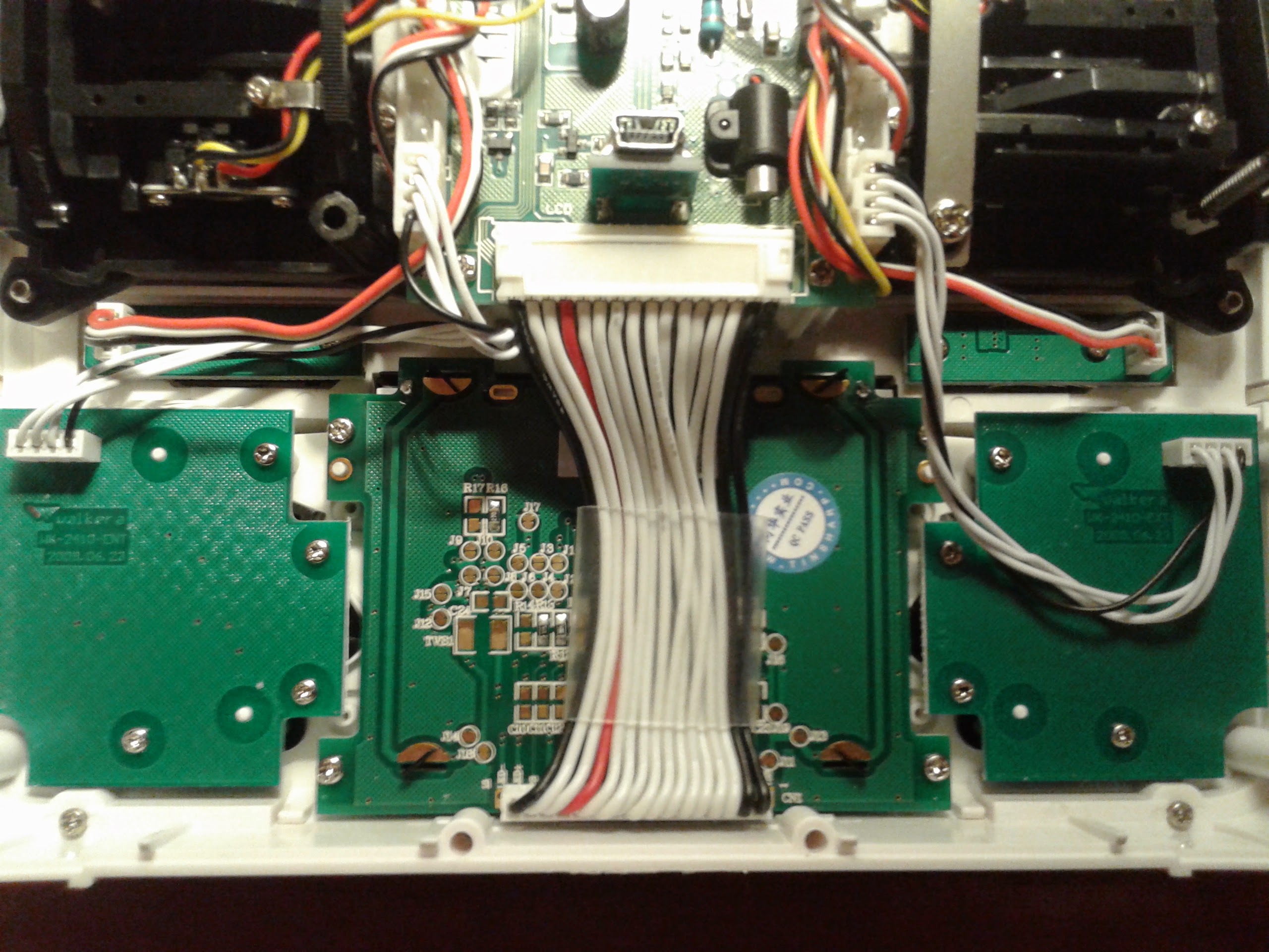

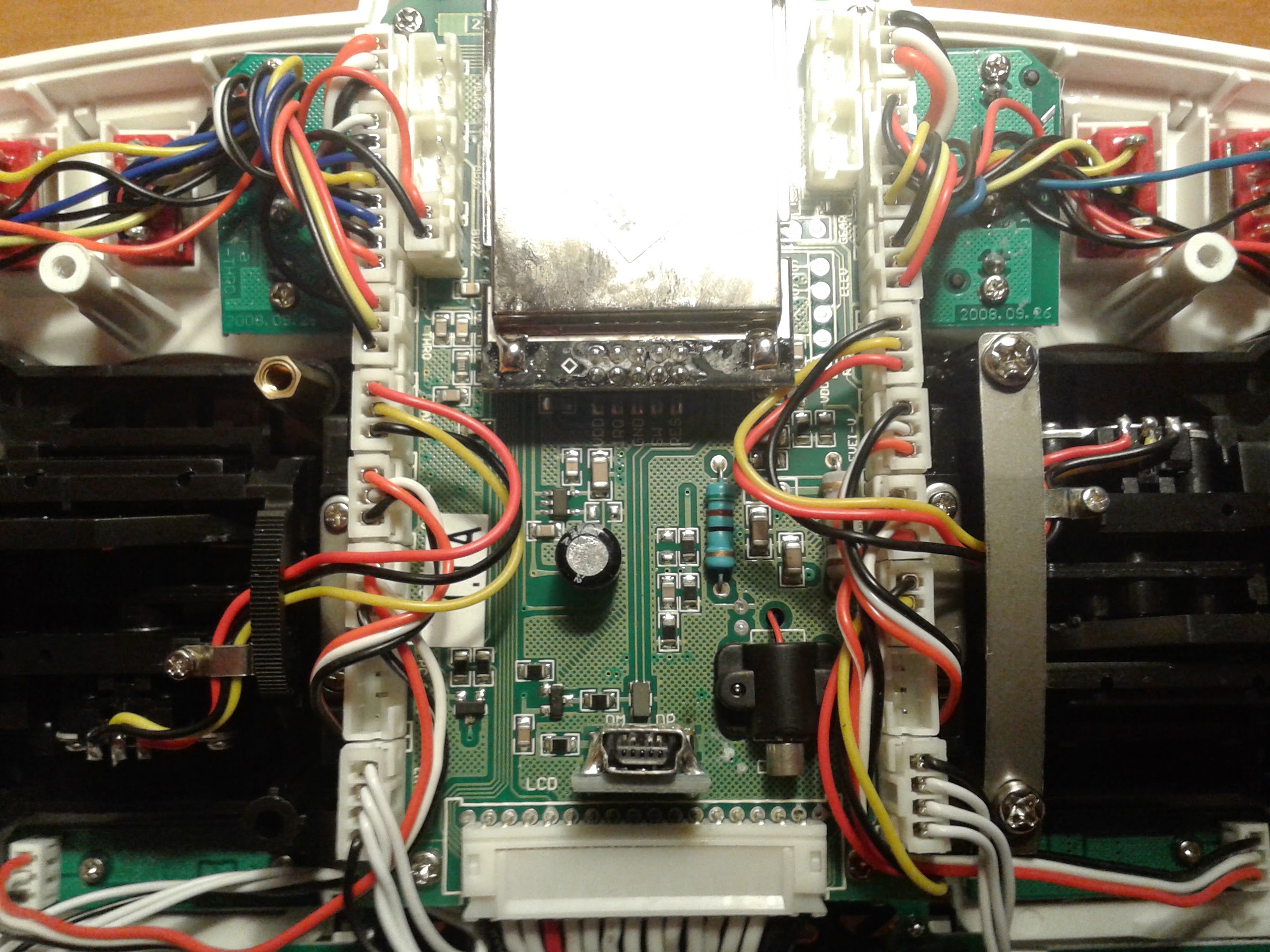

please open the transmitter and share some internal pictures. Most interesting would be how the pots are connected to the boards.

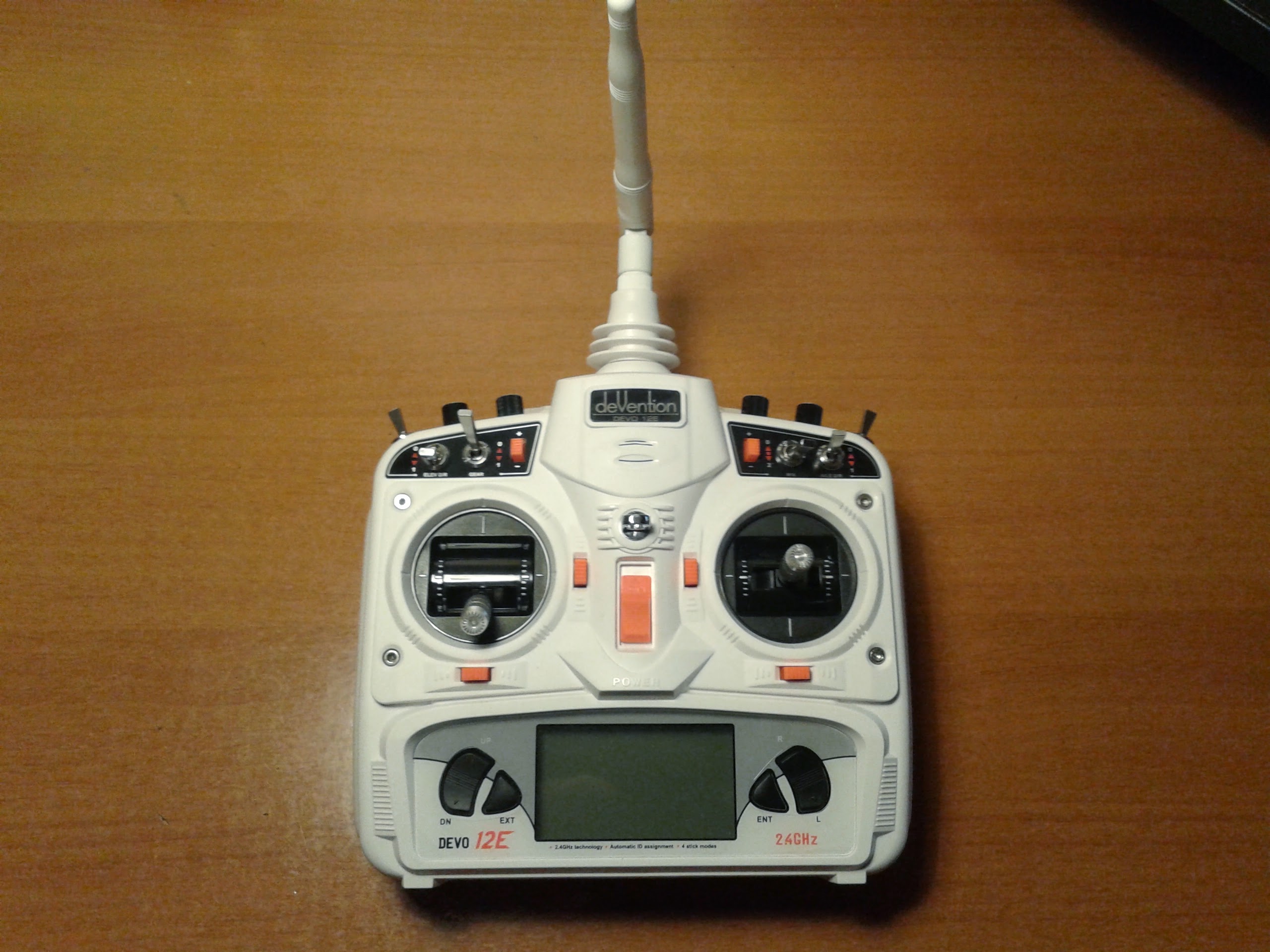

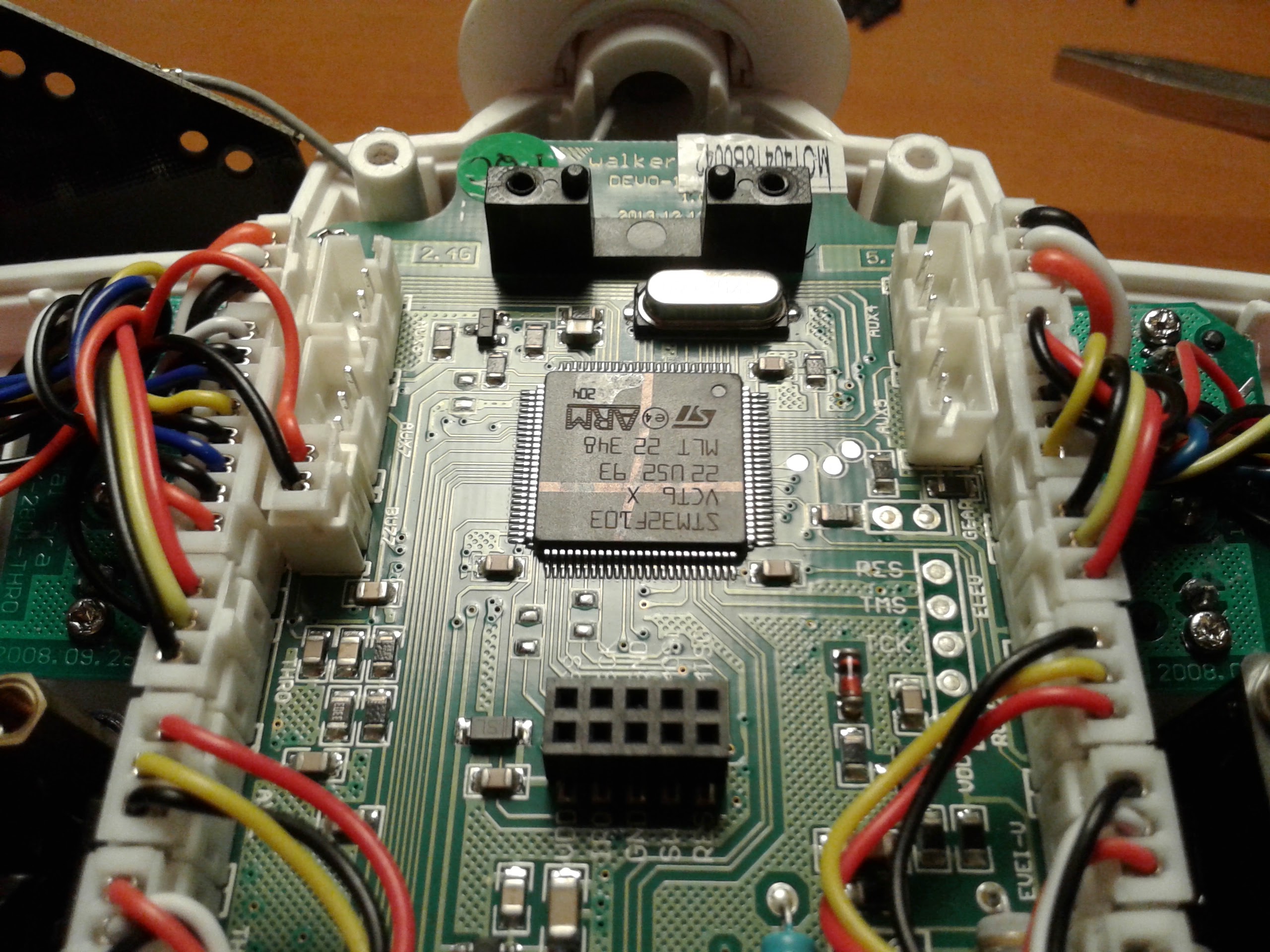

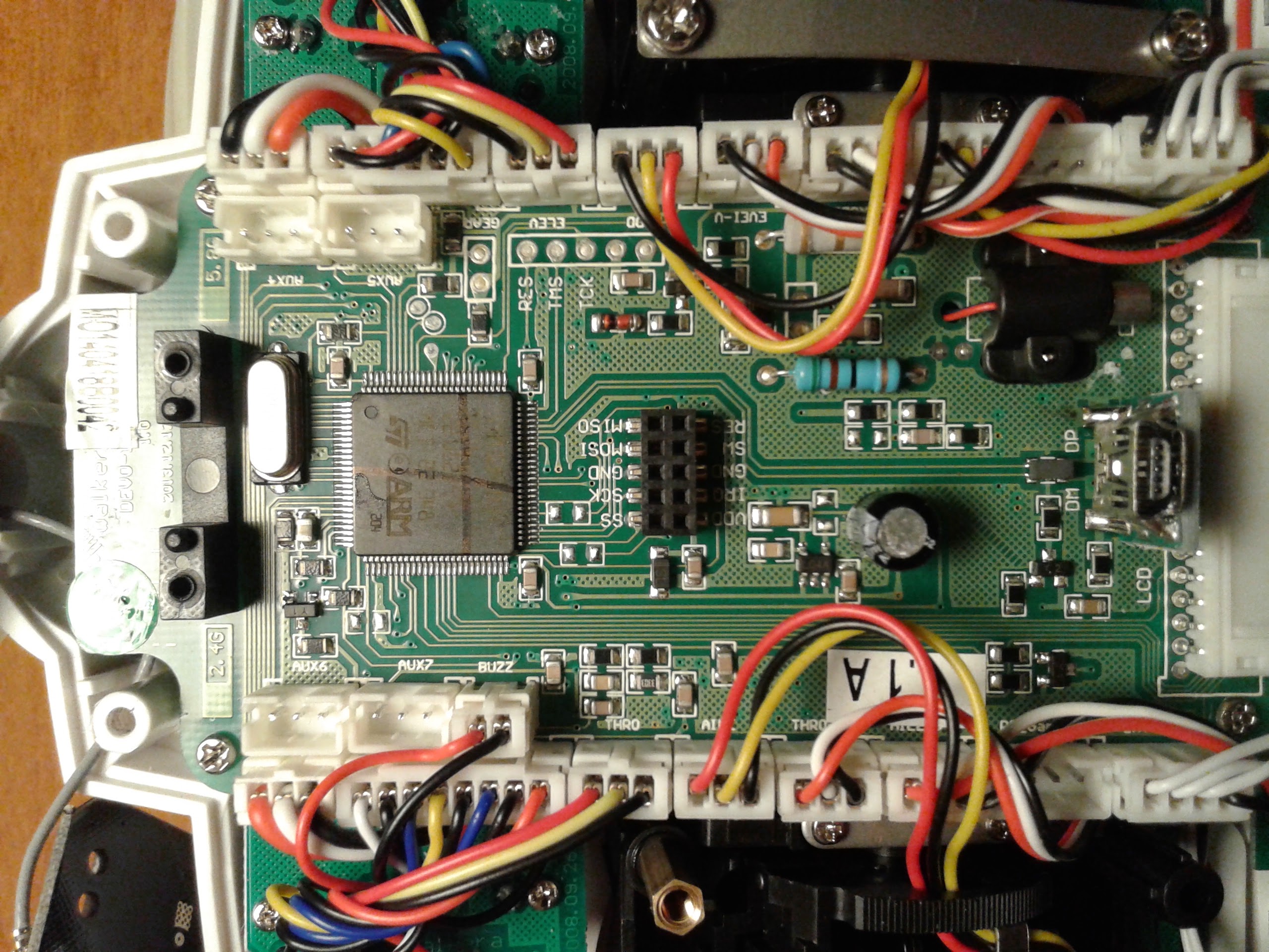

23 Dec 2014 18:30 #27166 by Emc2
Replied by Emc2 on topic DEVO 12E
Here are the pictures of my DEVO 12E. I hope it will help someone to make firmware for it. :cheer:
23 Dec 2014 18:33 #27167 by Emc2
...more pictures
11 Mar 2015 07:01 #29558 by gektor
Replied by gektor on topic DEVO 12E
Is there any significant difference to Devo 10 at all?

11 Mar 2015 10:55 - 11 Mar 2015 11:01 #29565 by vlad_vy
Replied by vlad_vy on topic DEVO 12E
Both PCB (Devo 10 and Devo 12E) have very similar layout. Added AUX7 and AUX5 connectors and renamed AUX1 to AUX4 and AUX2 to AUX6 connectors. I think will be enought to trace connections for AUX4 - AUX7 to MCU pins (probably center contact only - center output of pot).

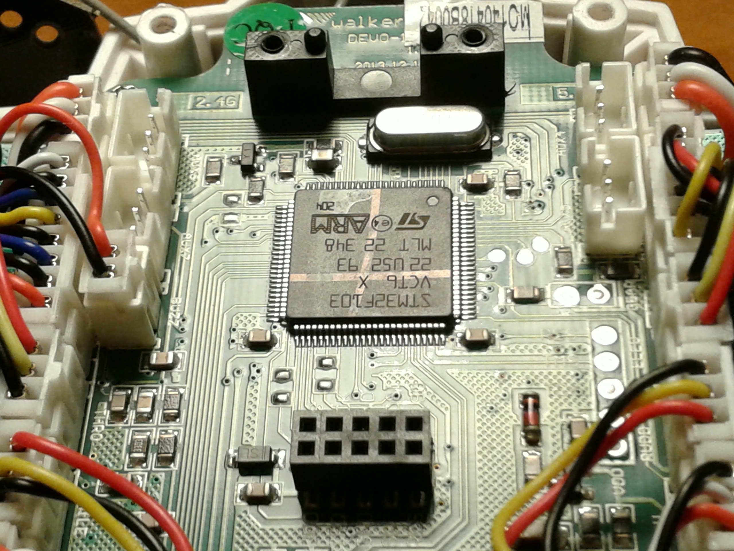

17 Mar 2015 13:51 #29775 by PhracturedBlue
Replied by PhracturedBlue on topic DEVO 12E
I compared the devo12e images to the devo10 images.
It looks like PA0 and PD9 have new connections, and I don't see any other pin changes on the STM32.
PA0 is ADC0, but PD9 is a purely digital pin. So it is possible they swapped some pins around to get usable ADC pins.

17 Mar 2015 17:02 #29780 by PhracturedBlue
You may be right about PD.9
I think the 2nd analog pin is PB.0.
I will throw together a 12E build. If someone has one to try it, we can see if that is all that is needed
