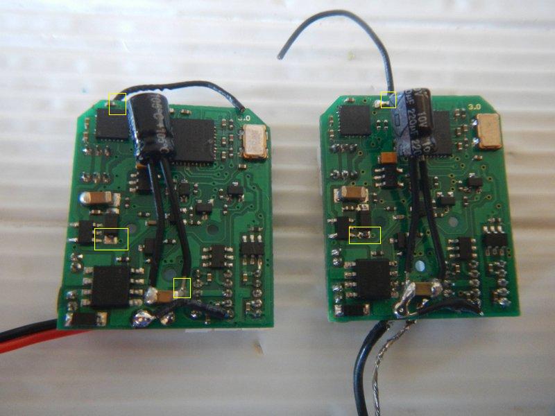

There is no need to clear the ID more than once. Otherwise the rx would have bound and stored the new one.....
Please post a picture of the other pcb side.
Both boards are Rev.3.0,but the antenna seems to be mounted somewhere else at the new board. **
Inspect the plus pol of the capacitor (right side) at the new pcb. Solder point still in good condition?
Some words about your old board later on.....

** on the factory board the antenna mountpoint is covered by liquid tape, so the antenna can not point straight up as on replacement boards.That´s the difference.
All I can see, is a missing a small part, capacitor..???. Please check if there was something soldered.
aMax
Edit:

I checked the plus pole capacitor solder point and it seems good, also tried with a tester for the electric conductivity.
Here the pictures of the other side...

Looks all good. Even the Schottky barrier diode (back side/left)..
Compared it to my board (ver 3.0).
So the only advice I can give, is to test the procedure for a new fixed ID with
your OLD board, to be sure, not to make something wrong. Do it at least two times and then, if this worked, try exactly that way with the new board.
Sorry, but I have no other advice for now.

About the OLD rx, i tryied when bound and with the main motor spinning slowly to touch the board, specially near the antenna, and bingo, almost predictable it looses the binding... only problem is that this could be maybe some micro soldering or some chip itself...cause i already tried to re-solder the antenna...
The binding is also lost without touching it and giving throttle to the motor, even just a bit of throttle..
