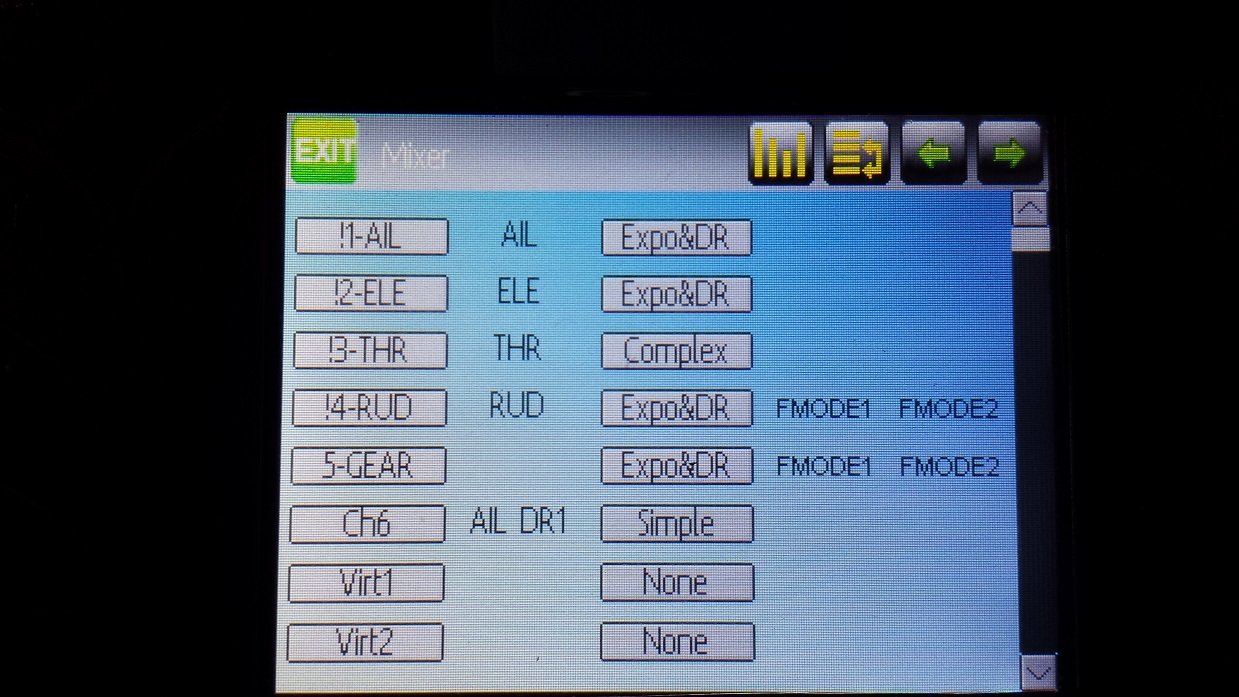

I still think you should check out the settings page's input monitor I mentioned in one of the other posts. The throttle sounds like it is on the left stick, but from what you said in the other thread it sounds like it's in the direction that rudder should be in, which is just plain wrong. To catch everyone else up, he loaded a model profile I made but couldn't get the throttle warning to go away until he moved the left stick to full right rudder. Kind of wonky.
Check that out and let me know what you find. After that, try loading the latest version of Deviation. If that doesn't fix it, it might be time to remove the back cover and see what's going on with the left gimbal's wiring.
There's probably a way to re-map the controls to be in the correct place, but if you don't fix the core issue you'll have to do that on every single model profile you use.
While we're checking things out, reload that Ominus profile and take a look at the model settings - tap the icon, and check the page you see against the attached photo. If anything is somehow switched around, that would definitely give you problems. If not, this is the page we'd need to change things to get your channels assigned to the correct stick movements.

The Orange R615X will give you the correct order using PPM.(CPPM port1 on the rx)
Edit: Your TX is correct in mode2 but these shit Spectrum RX screws it up.
The CC3D is in AETR channel order and if you use PWM, you can reorder this into
the Devo or just plug signal wire to port for channel3 on the CC3D.
Edit1: R615X has AETR order at CPPM.Try it.
Last edit: 27 Jan 2015 02:30 by aMax.
