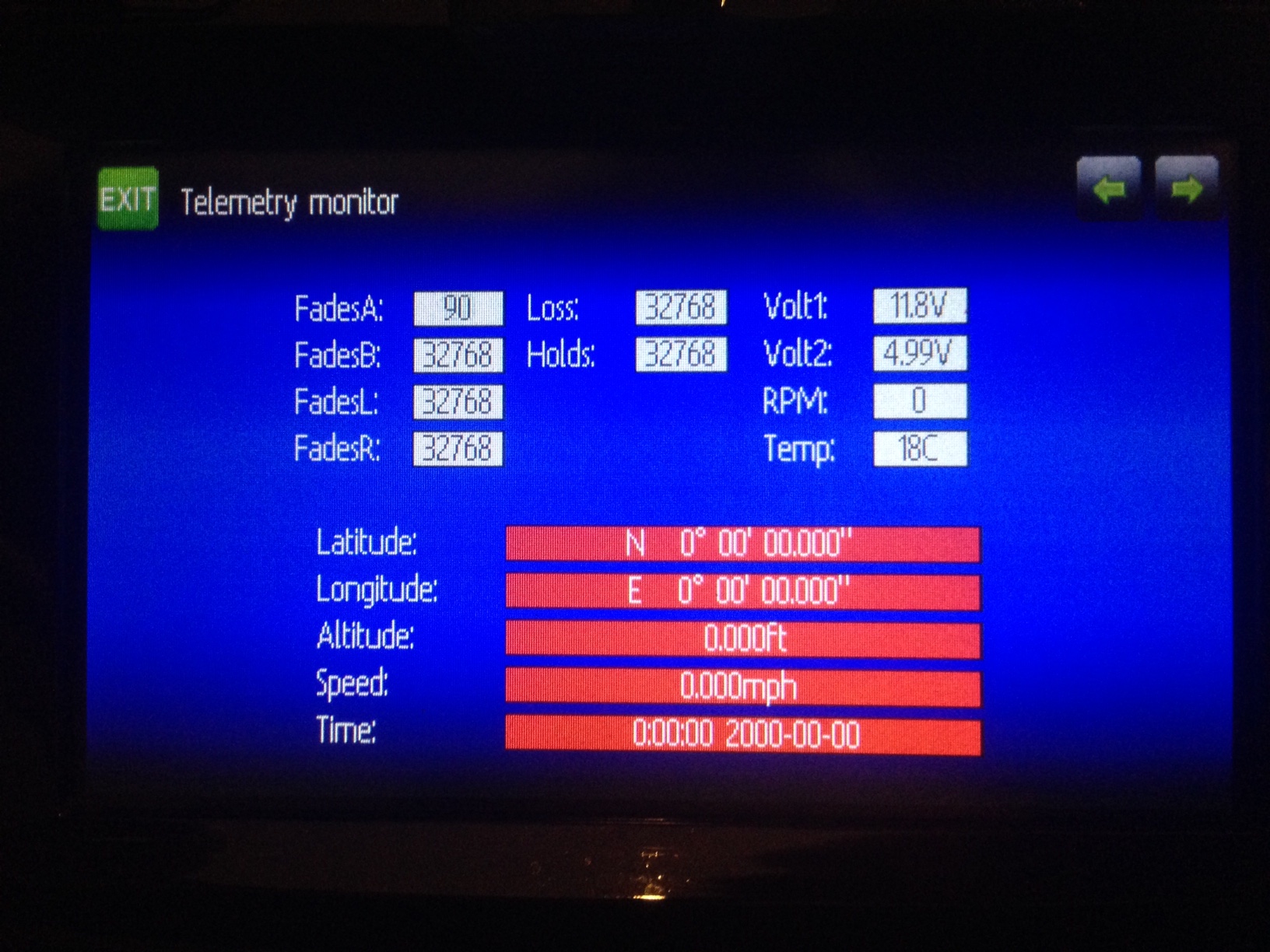

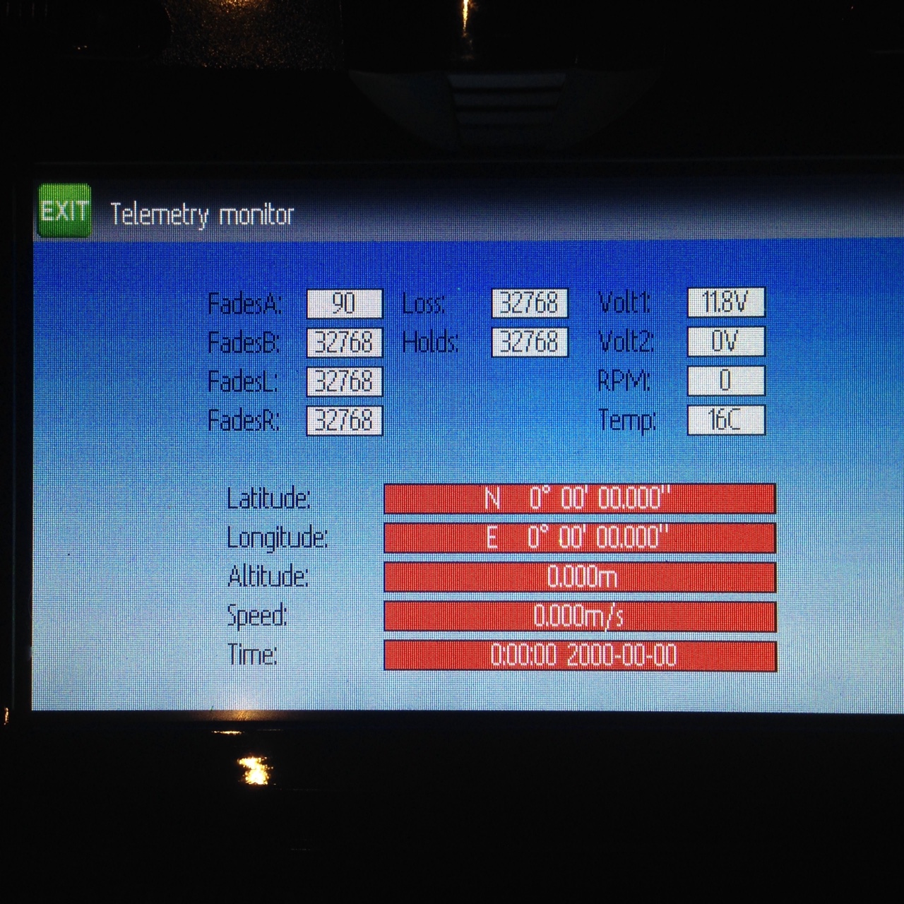

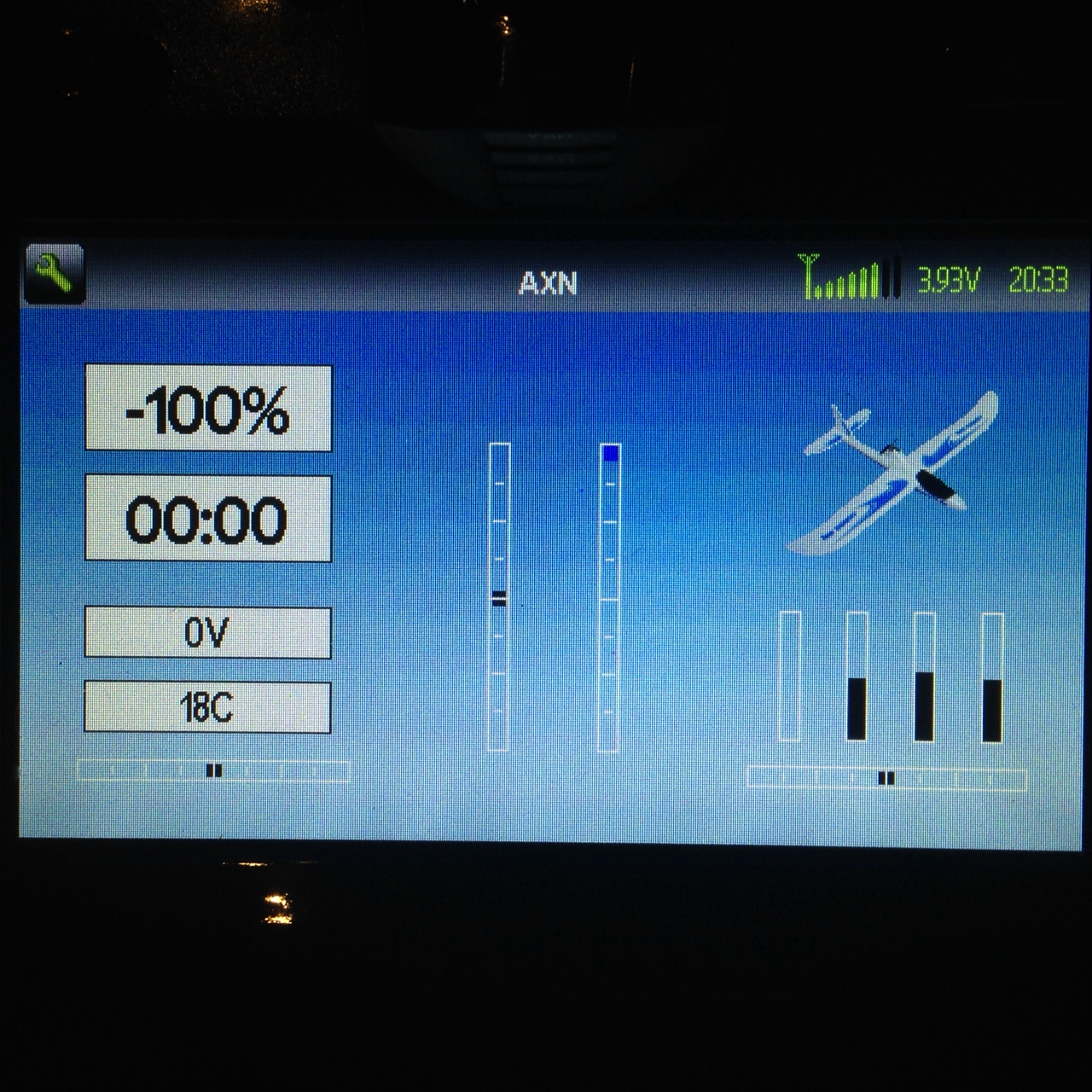

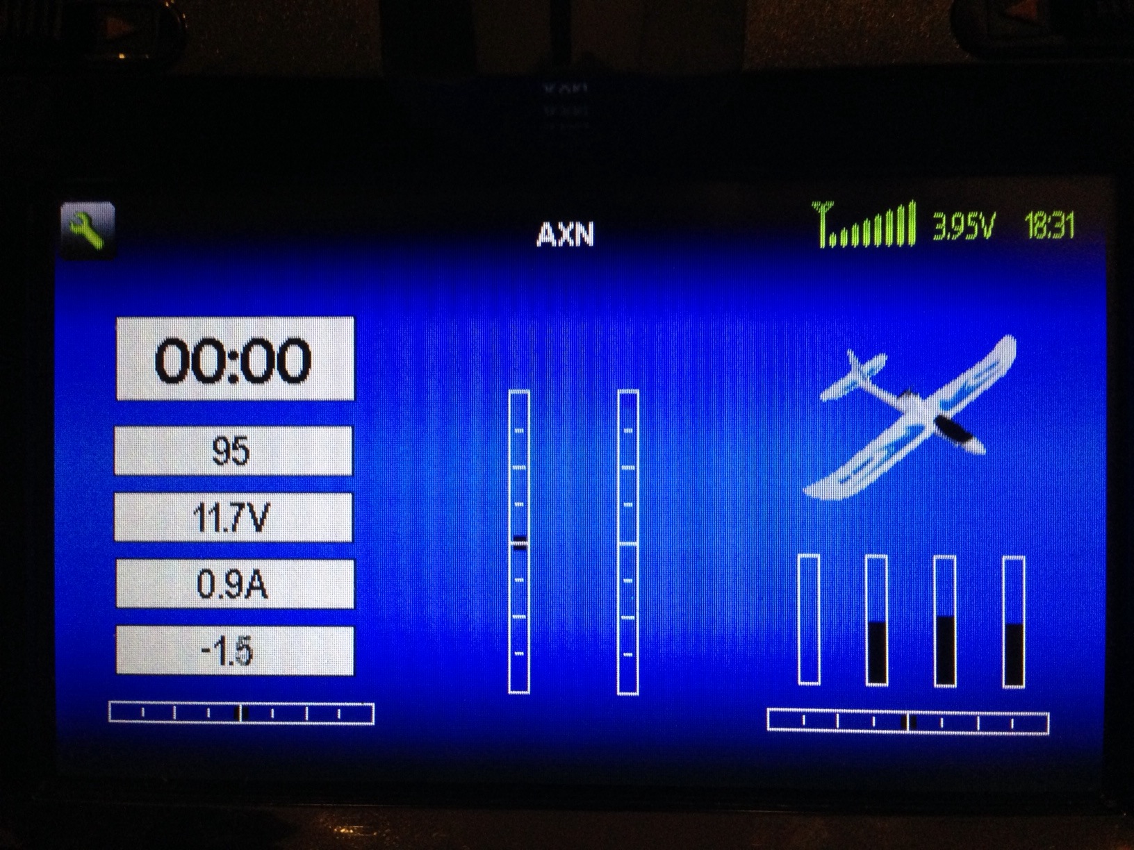

Evening gents, i've had a bit of a play with the nightly indigo linked to - it's certainly more functional than 4.0.1!
I've given as many systems as I can think of a quick test, and have found a couple of oddities:
I can display altitude and temperature on my model screen, which is great news - I can also get voltage, but V1 is playing up - it appears to be displaying both the BEC voltage then the battery voltage, almost constantly flicking between the two (see screenshot)
I have a feeling that there are two of each voltage at the moment within the menu, but I could be wrong?
See below, I've found V2 now reads 0v
The Altitude/long/lat/speed are red, which I understand is down to my lack of a GPS module - would there be a way of labelling the GPS sourced info as such, so it doesn't get confused with the data from my moduile, barometer etc?
Last edit: 08 Feb 2015 21:33 by Kernowmcrae. Reason: tidying photos

Thanks for your feedback.
Without it I wouldn't know there were issues, and I was loosing interest and thinking of moving onto something else.
You were right, 2 voltage readings were being saved to same variable. That is now fixed.
And the 32768 value in fades I hope is fixed too.
Please try latest and report back.

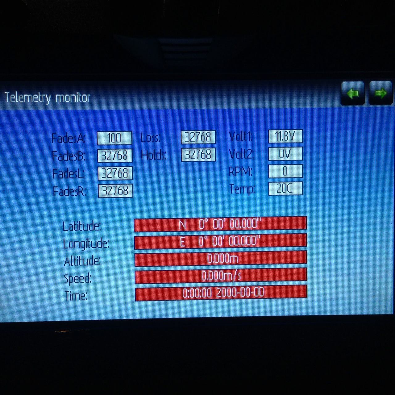

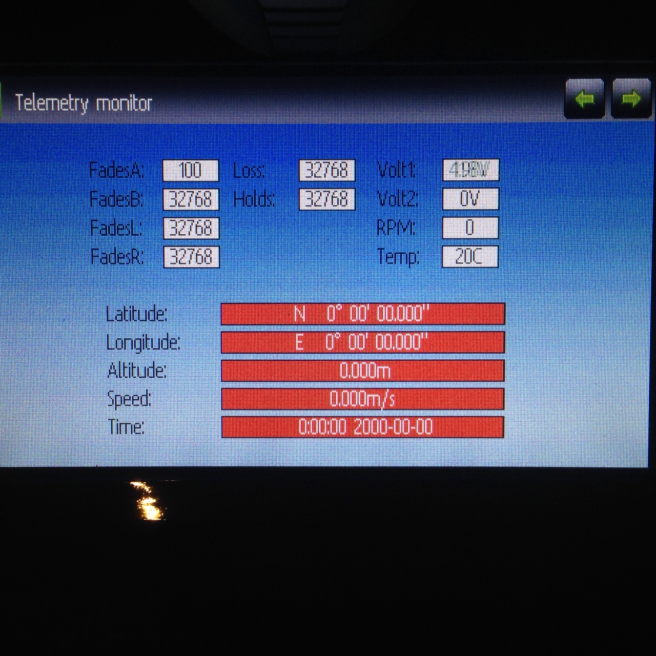

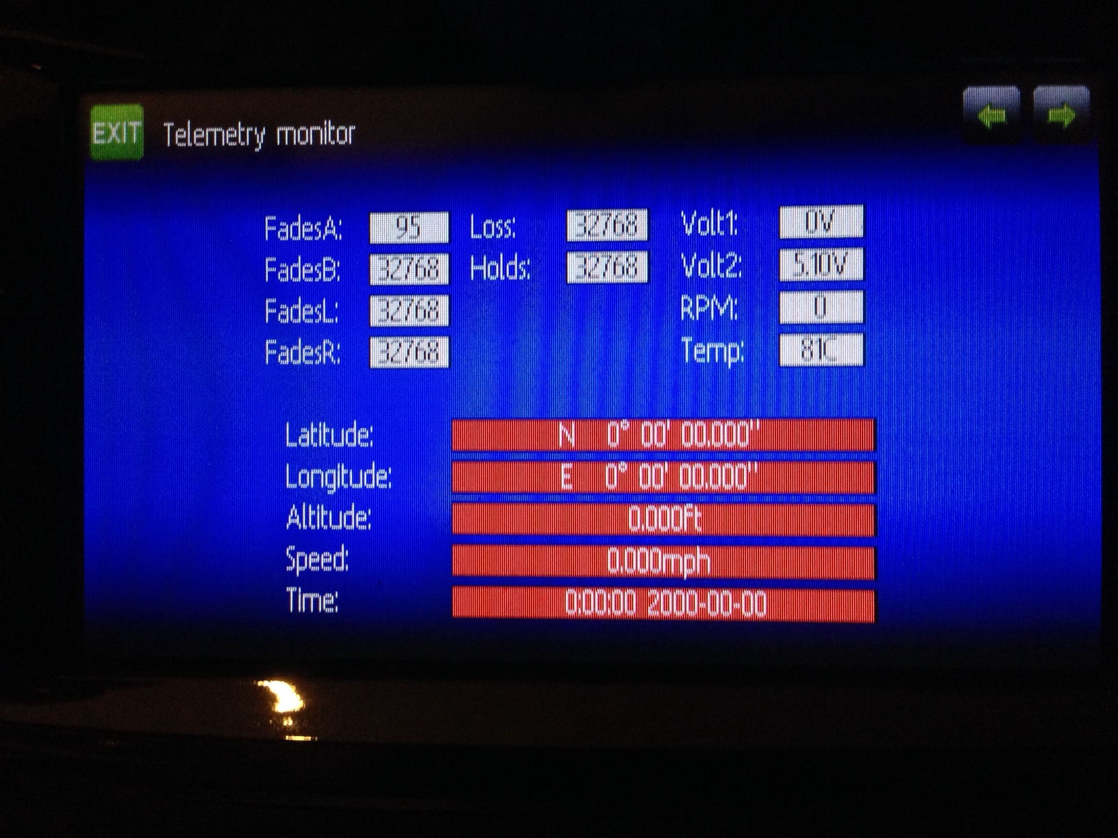

I also checked the telemetry - the battery voltages now read correctly in both boxes, and all other variables seem to work as expected, temperature, altitude etc.
This is the unit bound to a 10 channel unit - Volt2 must be the internal voltage monitor in the unit, Volt1 only pulls information from the external current sensor as in the second image?
Finally - all the information I require in the right place! I take it within Deviation currently there isn't a way to label the boxes in the GUI without some major rework? Just would add a layer of polish if it can be done.

- Added proper labels to Volt1 & Volt2
- Labels are now right justified.
- As a test, I have changed binding packet so that it will now bind as if telemetry is off.
That 32768 value is now treated as 'no data', however it's most likely to be negative zero. I would like to see some other value for FrameLosses or Holds. Please try lowering tx power to minimal setting and moving away (if needed) to get a value other than 32768 or 0. With aircraft on ground and no throttle it should be quiet safe. However you will crash if you try to fly away with tx power too low, so make sure you return tx power to normal setting when your done testing.

Hi guys, good evening. I've had a quiet moment to flash the firmware, and can report back that the labels being moved to the right looks a lot neater!
The persistent 'binding in progress, please wait' message is still very much present - as I mentioned before, it can sit for over a minute at '0 seconds remaining - that can't be right!
I've bound with telemetry enabled, and no glitchy servos or random flashes from the rx.
I've also dropped the signal strength for you indigo, and have got varying values in the fades box - ranging from 100 (which is at full signal) to 0, to 65532 when I had barely any control. It also turned red at one point, with a value of 0 displayed.
Unfortunately I don't have a genuine Spektrum Telemetry module to test the fades B/L/R etc, but through testing none of the values other than FadesA changed.
One final thing, Am I right in saying the battery labels are the wrong way round? Volts1 (labelled Rxv) appears to draw from the current sensor, and Volts2 draws from the voltage provided to the Reciever?
I apologise in advance if I've given you them the wrong way round before!
